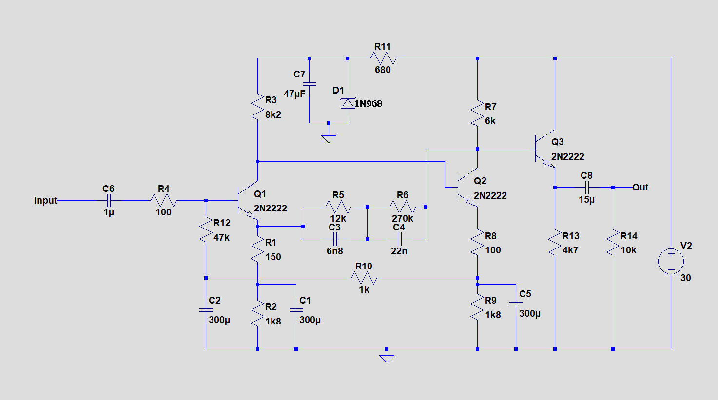

Since Ivey is no longer there and I have made some suggestions in the past, here is what can be seen as the final version, as close as possible to the version at the beginning of this thread, but now error free.
Gain is 40dB at 1Khz, the right figure for an MM.
I have enclosed the .asc file so everybody can play with the model.
Here ends my contribution.
Hans

If the 30 V supply is decently well-regulated and clean - and, given the topology, it better be - I'd be replacing the noisy zener with a 1.3 kOhm (1 W) resistor instead. (Zener current seems a tad excessive either way, you could probably reduce that by a factor of 5.) Otherwise you can easily add 1 kOhm in series between D1 and C7 to knock down the noise. When leaving the zener in, it better get a dedicated power ground path back to 30 V power ground.

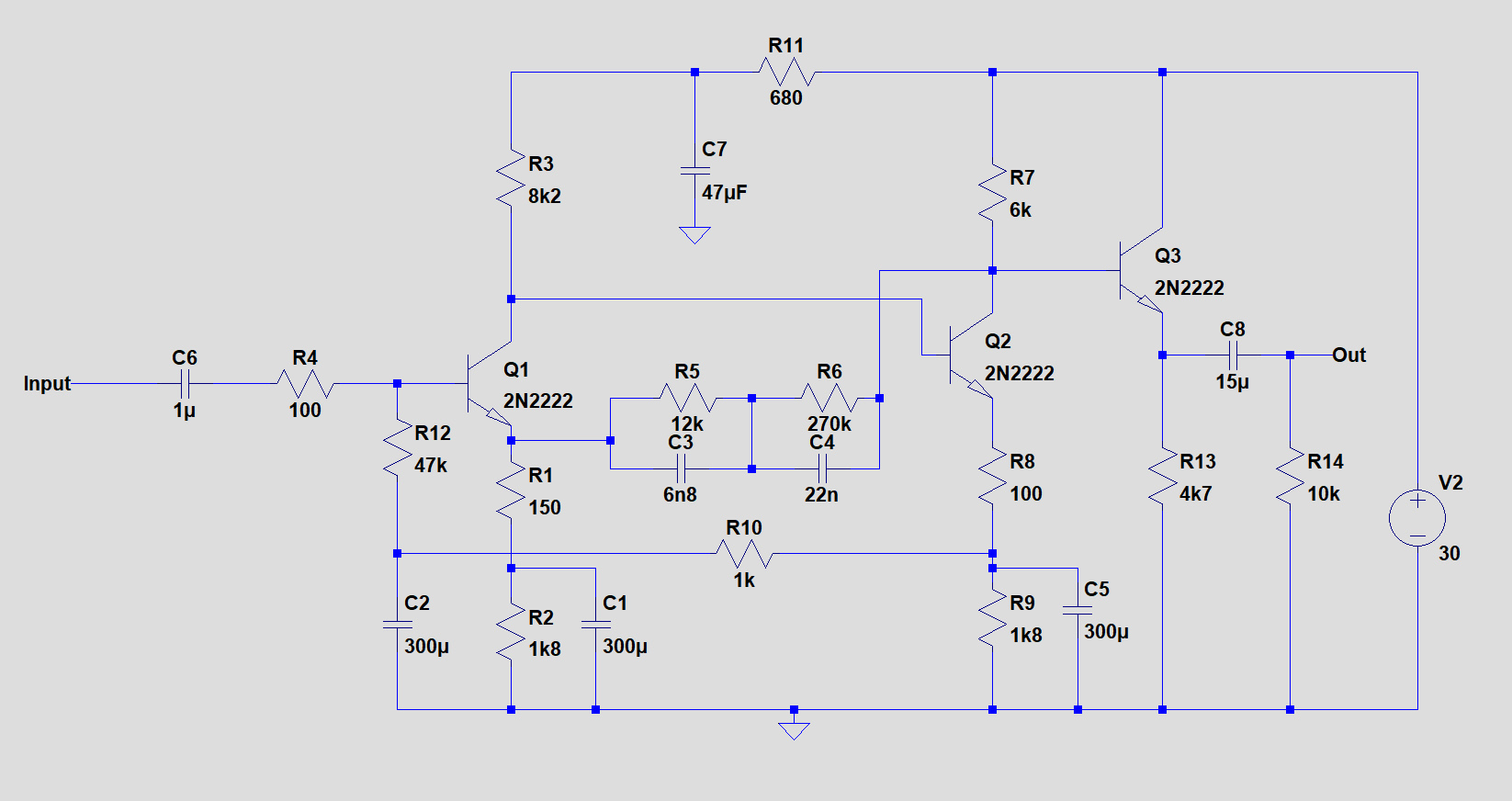

2n2222 in Trio receiver
Compare schematics with phono section of Trio (Kenwood) TK60 receiver (from 196x... 1970).
Almost the same, or at least very similar "tube schematics".
I have replaced bipolars by 2N2222, replaced caps with mica caps, big one with Hitano or Teapo caps, replaced NPNs in preamp and pre-output stages to 2N2222, improved Power supply... and.... (drums) the sound is great!
And when I say great I mean great.
Keyword - "simplicity", which is here allowed by 2N2222 specs.

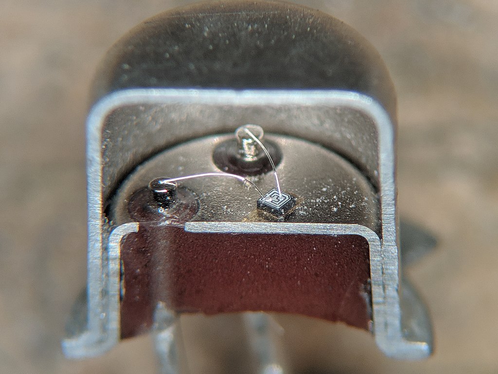

Strange, inner structure of 2N2222 looks pretty regular, nothing special, except the huge basement and very simple shape of base and emitter zones.
Ivey said the key is a very simple wafer process of 2N2222 production.
See photo.
