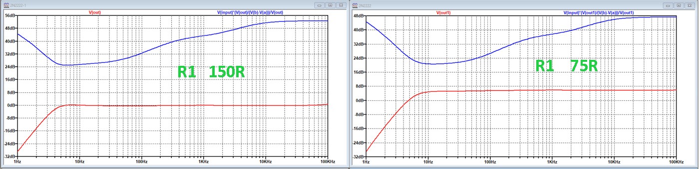

Below are two graphs, one with 150R for R1, the other one with 75R.
In red you see the FR and in blue the loop gain.
At LF loop gain is already very small. For a voltage feedback amp a figure above 40dB is to be preferred as it is @1Khz and above.
At 20dB loop gain, distortion will most likely increase, but one might be less sensitive to these harmonic frequencies.
When lowering R1 to 75R, gain increase by 6dB but loop gain decreases even another 6 dB !
So I would say, it is possible to lower R1 but the proof is in the eating of the pudding.
When you hear no difference in sound character, be happy with it, if not leave R1 at 150R.

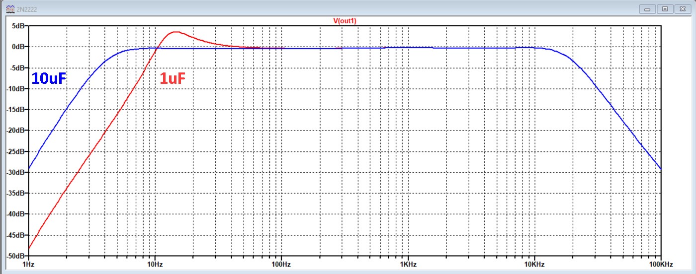

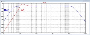

One last remark, in the circuit diagram, I have used 1uF for the input cap C6.
This should definitely be 10uF.

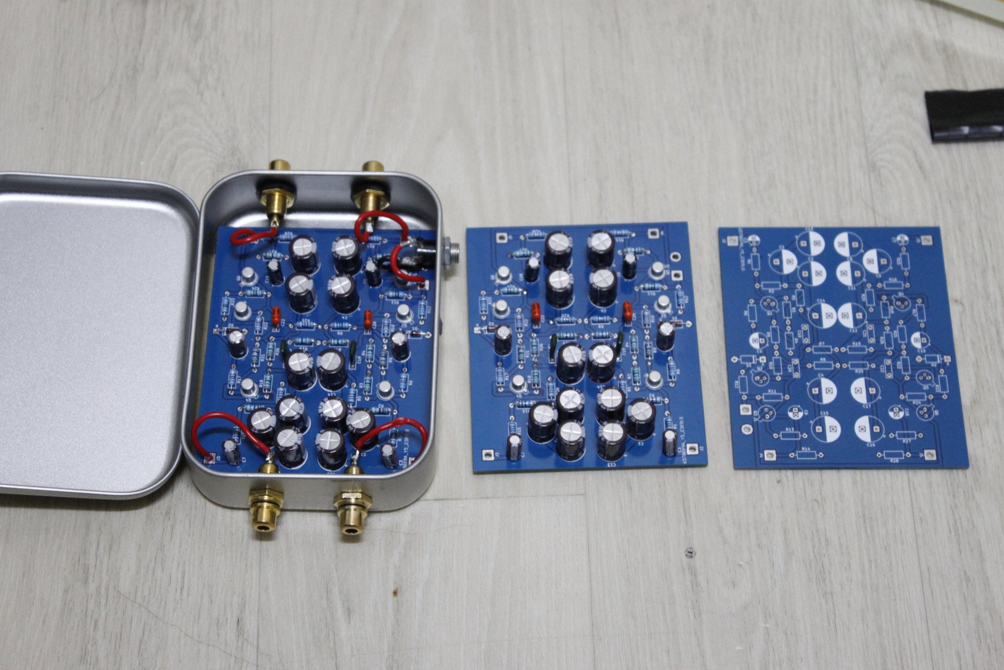

I made stereo PCB with Hans' design.
changed some hard-to-get parts.
https://github.com/voskresenie07/2N2222A_stereo_phono_amplifier
Please enjoy 🙂

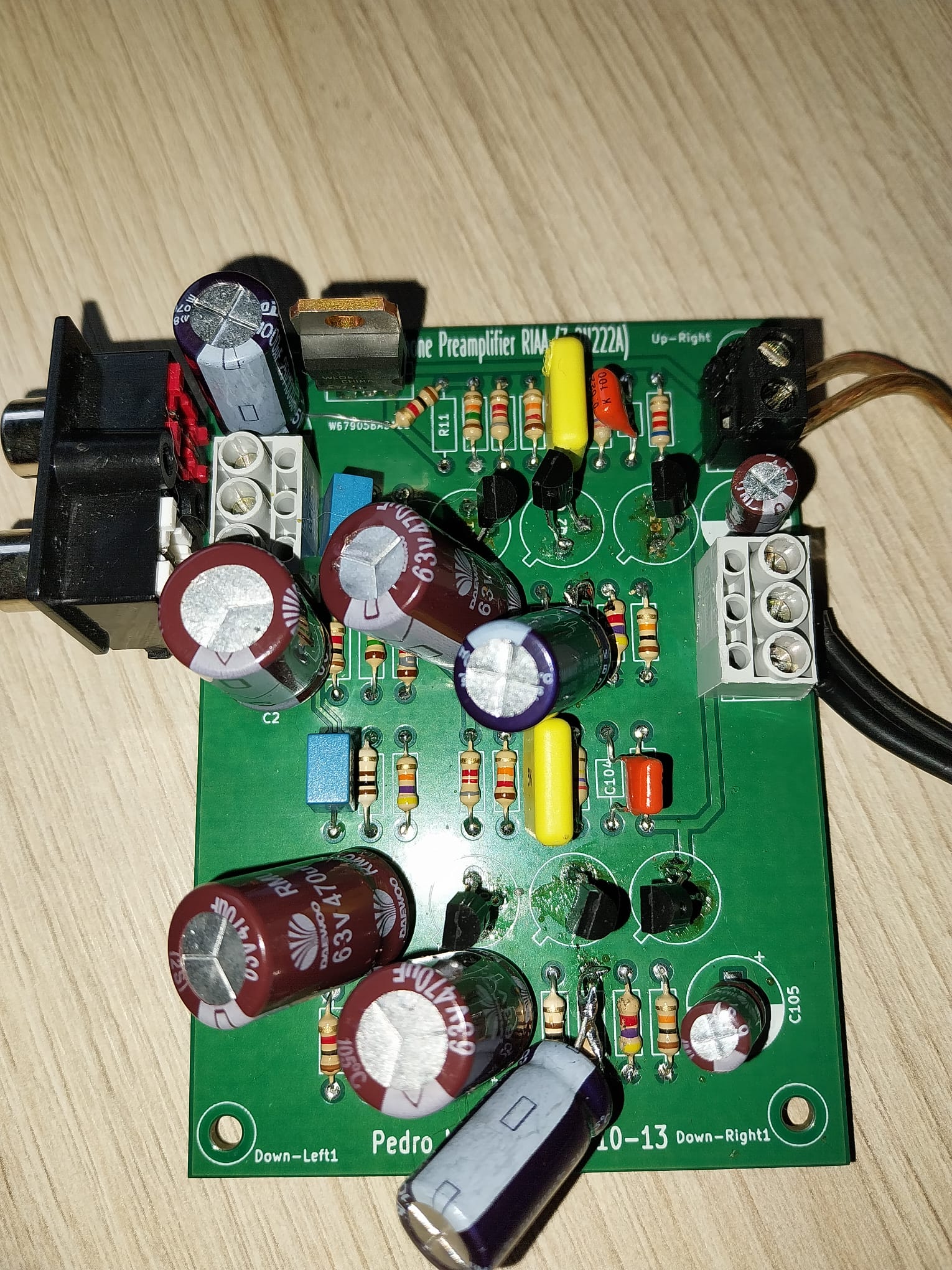

Hello Voskresenie
This is a great coincidence
I already made and tested other board but I removed Zener diode and put one LM317 as voltage regulator.
I forked your project in github, but my desing is a totally different approach:
https://github.com/PedroPMartin/2N2222A_stereo_phono_amplifier
I ordered PCBWay and board is already mounted and testing.

that's a great idea! LM317 can be found from every vendors and more effective then zener diode, so If I make it again later I will choose LM317.I already made and tested other board but I removed Zener diode and put one LM317 as voltage regulator.
btw I ordered my PCB from JLCPCB, and it is work well. (left one is isolated from tin box by bakelite board)
