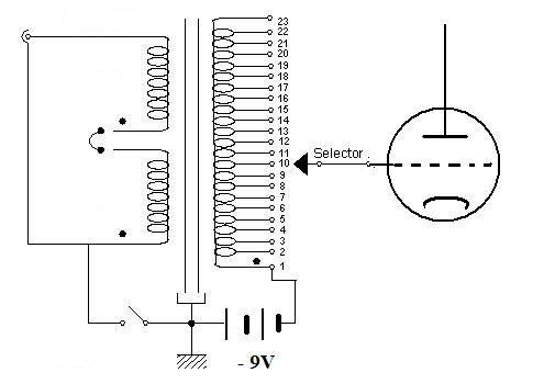

Sorry, I seem to have muddied the waters a bit.. Yes, I am strongly in favor of absolutely conventional (fixed) grid bias with the 26 and all other DHTs, and use it extensively in my own designs. IMLE, yes grid bias is superior to filament based bias and I strongly encourage you to implement.. Easiest is a a pair of 9V batteries - one for each channel will last many years..

Andy, I have to agree with Kevin and Coolzero in that battery grid bias is very good. I’m using a 133nF Russian SSG slver mica cap for the input. They are very transparent.

Regarding grid bias with an input transformer, normally it’s applied it to one terminal of the secondary with the other terminal going to the tube’s grid, but I’m not so sure with a TVC. Can one just apply the grid voltage as per the diagram below? Or would the variation in the resistance of secondary windings cause a problem?
Rich
