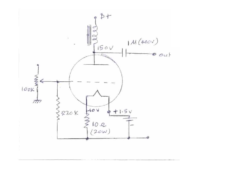

It's easier to understand if you think of current loops, and ground (or common) reference points as independent issues.
There is a current loop for the filament. The current from the filament supply must return exactly to the filament supply.
There is a separate current loop for the current through the tube, which also must return exactly to its supply.
Let's say you are using cathode bias. In this case the current through the tube must go through the cathode resistor before it can return to the supply. And in cathode bias, the bottom of the cathode resistor is at ground (or common).
Let's take an example, of a 5V, 1amp filament, and 10mA plate current and a 1k cathode resistor.
Let's assume that the negative end of the filament is connected to the cathode resistor. With 10mA and a 1k cathode resistor, the potential at the top of the cathode resistor will be 10V. Now, the negative side of the filament will be at 10V.
If we want to use filament bias, we take the filament return voltage from the bottom of the cathode resistor, instead of from the top of the cathode resistor. Now, the filament is in series with the cathode resistor, so both the plate current and filament current must go through the cathode resistor. The total current through the cathode resistor is now 1.01R (1A+10mA). If we want the same 10V at the cathode resistor, we must calculate the new resistor size (V/I=R or R=10/1.01=9.9R).
So to get the same bias, we have reduced the cathode resistor by a factor of 100. The advantage is that we can eliminate the bypass resistor, since this low value resistor will cause very little cathode degeneration. The disadvantage is that any noise due to the filament supply ripple over the cathode resistor, will be amplified by the u of the tube.
Sheldon
Thanks a lot Sheldon. Your explanation is an excellent education for me as usual. I put it all into a diagram; can you verify whether what I understood is correct.

I am using voltage regulation not current regs for filament bias - I would otherwise use current regs, but Thomas Mayer found this didn't sound so good as a LCL filament supply. I haven't gone into the supply yet, but voltage regulation is easy to implement here just to get it up and running and get the voltages right.
Note that the 10 ohm resistor would benefit from being 11 ohm to keep the current through the 26 closer to 6mA. And a 20 watt part is really not adequate - think at least 30W or preferably 50W and that's better on top of the chassis. This resistor gets hot. On your diagram, if you have 10v on the top of the cathode resistor you have 11.5v on the other side of the filament, which is your supply voltage.
I have a 11 ohm cathode resistor (10+1 ohms, 50W and 12W vitreous enamel) and 9.7v at the top of it, so supply voltage is 11.2v.
Yes, with the voltage correction noted by Andy.
Sheldon
Actually, if you have a wirewound resistor rated for 10W, it is technically adequate for 10W. This is usually assumed to be in free air at 25 degrees C. Often this means it will run very hot (300 degrees C or sometimes more - see this example: http://www.irctt.com/file.aspx?product_id=69&file_type=datasheet ).
Now, you don't want to run at rated power, as that requires that everything be done just right. But note that at half the rated power, the temperature is still 200 degrees, which is fine for the resistor, but way to hot to touch.
So, the other disadvantage of this type of biasing, is that it does generate some heat, and waste some power.
Sheldon

I have 15R/50W resister in hand. If I use this with 12V supply, guess the filament will be little starved at 0.8A. Is this OK? Is it a must to have exact 1A current from the 12V supply? Which I got now is 12V-3A supply. Any other issues you could see with this setup? Appreciate your advice.
Sheldon/ Andy,
You are running the 26 well below its maximum current, so starving the filament by 20 percent should not be a problem. Though, I think with coated filaments, you wouldn't go much lower.
Sheldon

You could put a 47 ohm resistor in parallel with the 15 ohm. At 1 amp, wattage would be 2.5W through the 47R and 8W through the 15R, so I guess rate the 47R at 12W. That would give you 11.4R. A bit nearer.
