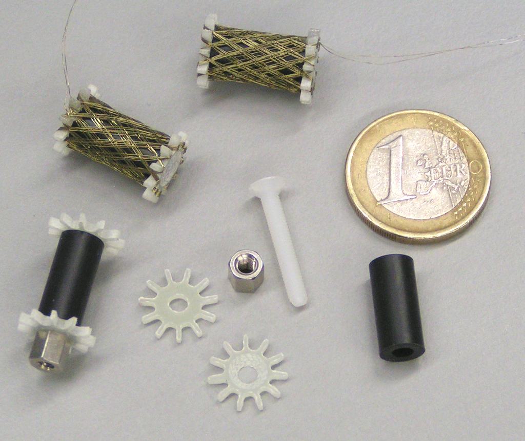

|| DHTRob - Projects: An audiophile DIY resistor.. ||
http://www.diyaudio.com/forums/atta...ing-ultimate-nos-dac-using-tda1541a-wwres.jpg

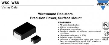

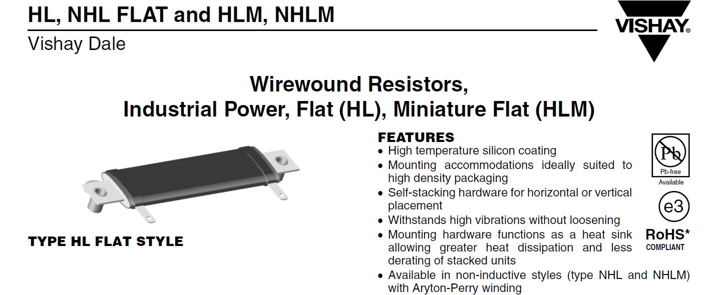

How would you know an Ayrton-Perry winding if you met it on a dark night?
Andy
For new parts, only the data sheet knows - see pic!
for old style, there's no endcaps, just wire entry, with a stub poking out next to the entry-point. I'll get a pic when I'm out with the camera. Sad to say, nobody made these, since the 1980s, as far as I know.
See how they're wound:
Ayrton-Perry winding - Wikipedia, the free encyclopedia
