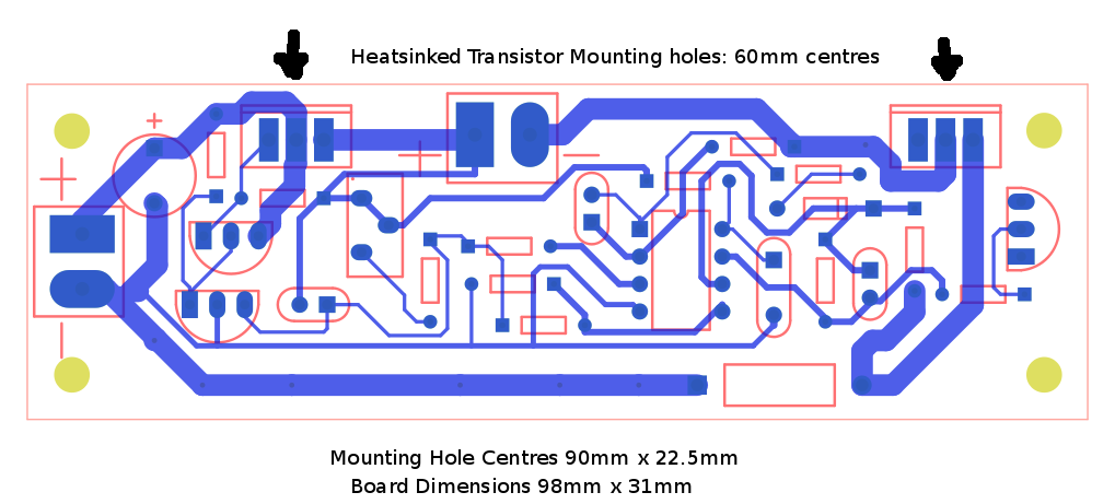

Tried to lay out the design with the PCB-mounted heatsinks AND keep it compatible with bigger chassis mounted types. This did not work out, and since some bigger filaments need bigger sinks, I've stuck to those, and left out the PCB versions.
The Board is ready to go out...
Here's the dimensions and hole positions - how do these work out on your chassis??
