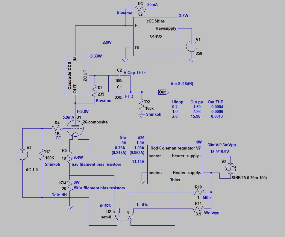

Hello
I am gathering my parts to build 01a amp. And i am hoping that i will be able to try #26 tube in the near future. I've always considered these tubes as the end of the road or the holy grail of all tubes.
Anyways, I've already purchased Rod's power supply and regulator. Thanks Rod they arrived about 2 weeks ago. They look great. And I am going to use Ale's gyrator cx301a schematic. I have two questions to begin with.
1. i can either do B+ of 260v or 135 v. Which supply one would be less demanding for the transistors?
2. my filament transformer output will be a double 18v. So I may end up with 20v or so. what would be an ideal voltage? I can bring it down in between 18 to 12 v i guess.
That's it for now.
Thanks,
This is my switchable 01a-#26 preamp.
1.) 260V for B+ is perfect.
2.) If you want filament bias, 20V is good for R.C. regulator.

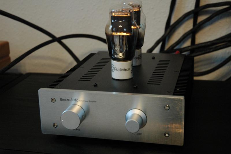

Depends on. "Better sounding" is very subjective thing.
Each tube and each application requires different loading and produces different output parameters, which (together with components) are -mostly- determine the "sounding".
I use this type CCS everywhere -more than a decade- with great satisfaction, but Ale's gyrator is also very good (for example in my 10/801 preamp).
In general (with a very simplified approach) if I need very large anode load, I use cascode CCS, if small output impedance is important, use "gyrator" with well planned semiconductor types.

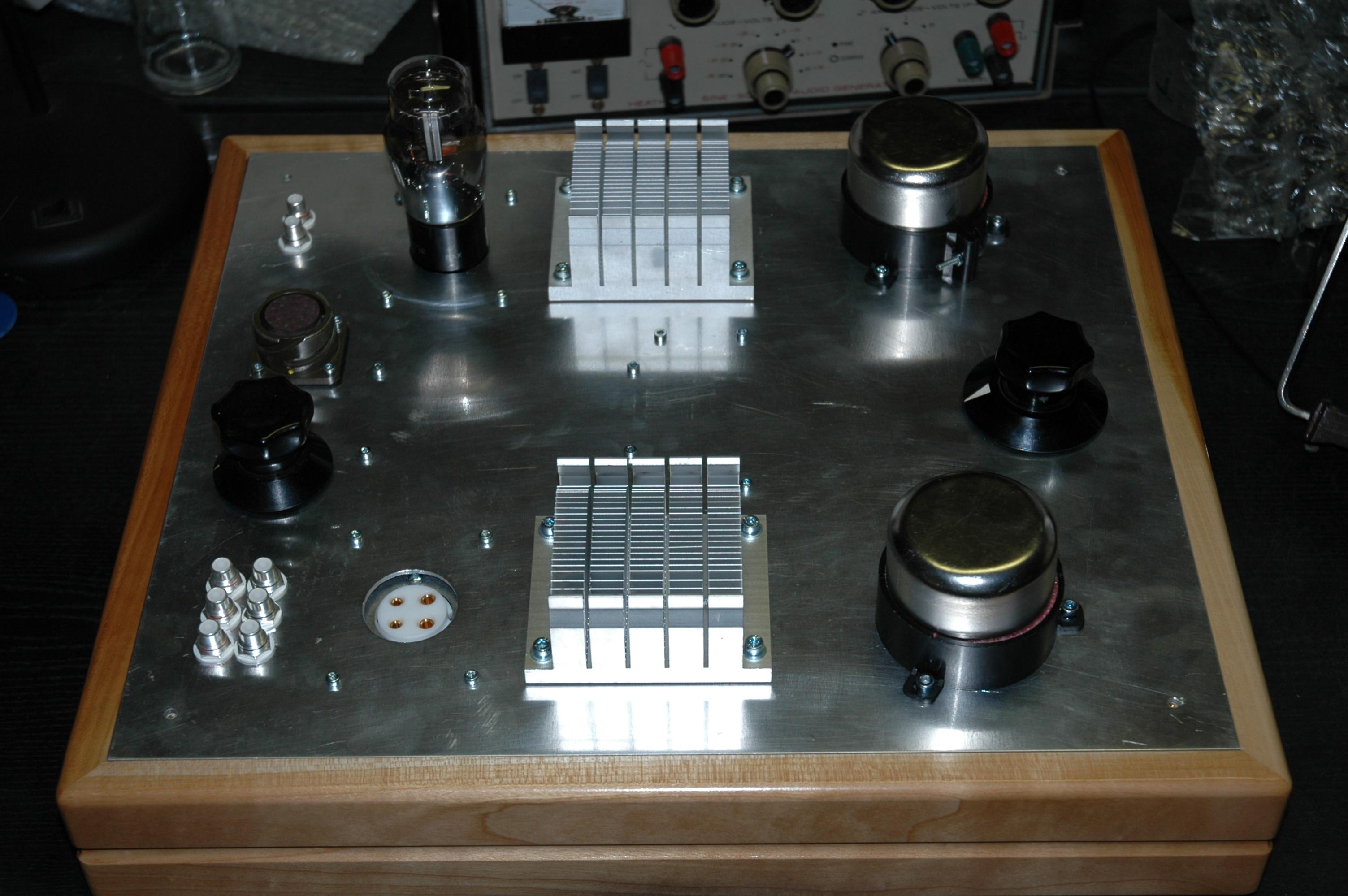

I was worried that the DN2540 and Rod's regulator might be running too hot.
R.C. regulator need appropriate heat sink area (in my #26 preamp it is first Pentium processor heatsink 🙂 inside the preamp box), but the real radiator is the filament bias resistor. I use for cooling an old Pentium server passive heatsink on the cover plate.
If you want to use compact preamp box, must to use such solution, like me in the 10/801 box: heatsink in sides.
p.s. the large box is #26 preamp, the compact is the 801.
First, your amp looks beautiful. Your heat sinks look impressive. And yes, I am going with the filament bias route.
Are you referring to the 20-25 ohm filament resistor? If so, i am going with 100w rated resistor. I tend to overkill when it comes to heat.
thank you
