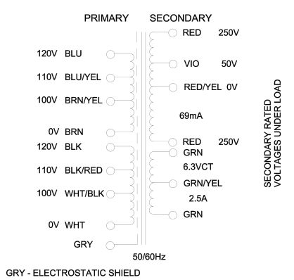

Alright, I have an EE question. I hooked up the both primary coils of my Hammond 369JX to 120V in parallel, and on the secondaries I put a multimeter on the 250-0-250v coil and left the 5V coil open. When I added power, I blew the fuse in my IEC inlet. Why is this, did i make a wiring mistake?
Are you sure that use this wiring in primary?
BLU-BLK 120VAC
BRN-WHT 0VAC
This is cross connected wiring. :-(I have Brown and Black hooked up to Neutral from wall, and White and blue hooked up to Line from the wall. This shouldn’t matter, though, right?
one coil: BLU..BRN
other: BLK...WHT
