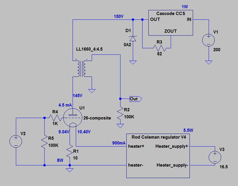

Felipe,
Your filament current is 900mA.
Without #26 anode/cathode current (B+ turned off), this 0.9A on the 10R (R1) resistor represents 9V.
Is you turn on B+, and measure for example 9.04 V on the 10R resistor, it means that added 0.04V caused by #26 anode current (0.04V/10R= 0.004A.... 4mA).

Felipe,
The last measurement the 10R isn't the filament resistor, the 10R is added between the OPT and the anode to measure current.

Felipe,
It seems like you are measuring high current due to oscillation, again.
So you will have to try to remove all the possible sources of instability now.
For instance, running long, unshielded grid wires is very risky. These act like a receiving antenna for phase-shifted signals, which are the origin of oscillation. The longer the run of unshielded grid cable, the stronger the pick-up, and the worse it becomes. These will also pick up noise from transformers (etc), and you may get humm. Therefore, this is a bad situation, and you must correct it now, even if it does not fix the immediate problem. Move the input sockets very close to the tube socket, and twist the input and ground wires together tighly (best solution) or use shielded cable.
Nest, use scope on ac 100mV, and 0.1us, 1us, 10us ranges, and check the supply voltage, at the transformer primary. Oscillation?
Felipe, the grid resistor is very important.
This is one reason I ask for a schematic. It needs to be drawn exactly as you have made the amp, rather than posting Andy's schematic, that you started with. Sometimes, very small differences like the grid resistor, will cause serious problems....
Taking the time to install a proper CAD schematic, like the superb DIPTRACE, or using LTSPICE, will save a lot of time, for everyone.
Rod fixed🙂 was the absence of grid leak resistor, now the current using Andy Sylvanias ST:
Left channel 4,3mA
Right channel 3,3mA
Now I will come back to Cunningham globe to see if really are matched like I bought.
I don't have words to express my deep gratitude for your help.
The problem was not that you forgot a resistor. The problem was that you dont post a schema of your work. Last time and this time. If you did look at your construction and posted a schema over it, one post would solve it. Now it took a couple of hundred posts.
