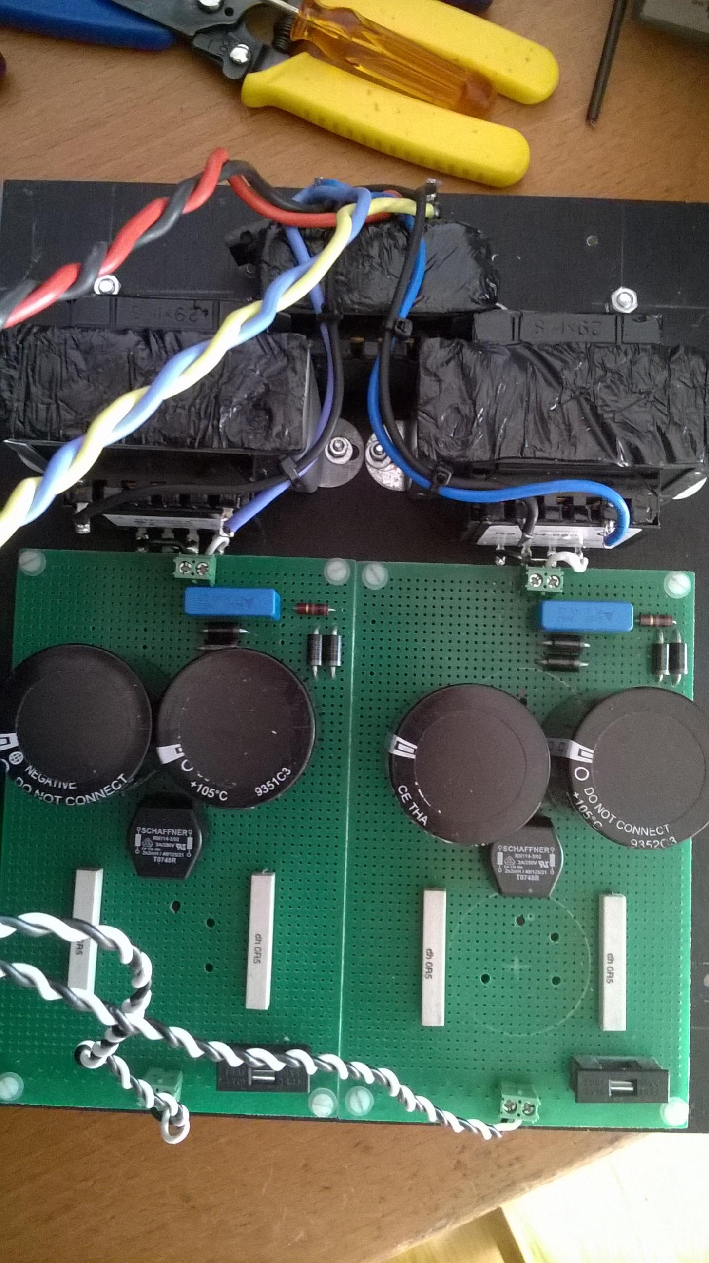

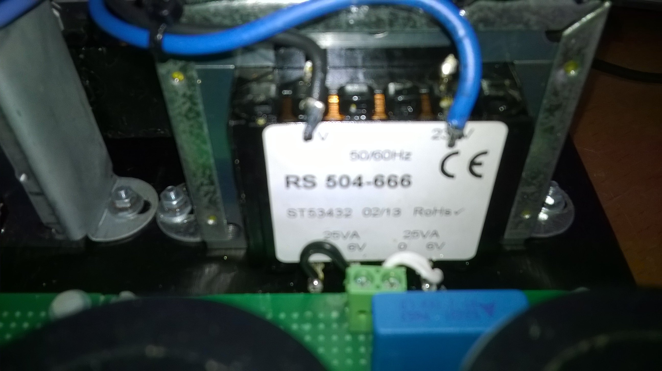

Attached pics of PSU heater regs 12V 50VA each transformer, two 15000uF 63V, four 1N5822, snubber (R+C), choke common mode 2x2mH 3A/250V & two 0.5 ohms.

As far as I know the regulator PCBs are all the same - you change one resistor to match the input voltage. Rod will tell you all this, but it's probably in the instructions anyway.
You have to be able to rely on your own calculations to do a lot of this DIY stuff. There are numerous posts telling you how to do the calculations.
Try some 15v transformers. Or some 18v transformers with a choke, or dropper resistor - whatever. This is only a basic power supply which needs to output around 17v. You'll find about a million tutorials on the internet showing you how to construct a power supply. I like to use choke input with a Hammond choke 159ZC - chokes are excellent even for low voltage power supplies. That requires a higher voltage transformer again - it's all in standard power supply theory.
Or if you want to use your existing power supply, use a different operating point on the 26 so the voltage on the cathode is less than 10v. Several ways to do this. The 26 works fine at lower operating points. You can also use a 105v voltage reg like 0C3. You have choices.

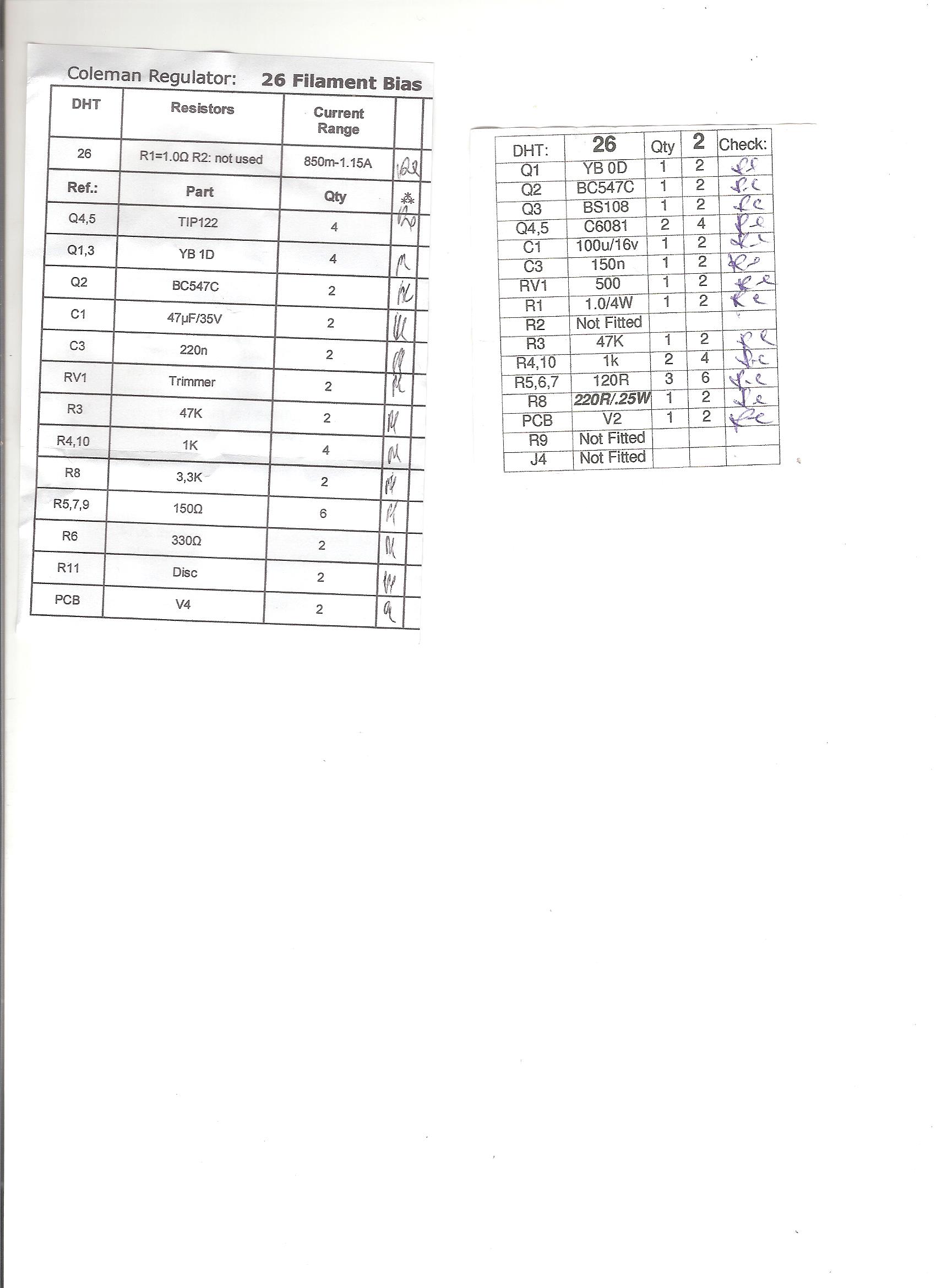

Yes, the first kits you bought were for normal bias. They are easily configured for filament bias - but, as Andy says, you have to check that you have done the work, and/or ask me. Applying 17V to a regulator configured to accept 8V is never going to end happily.
In fact, the instructions for converting any Regulator to filament bias were sent to you in email of Jan 13, 2013.

Well installed new txs Hammond 229D40 20V 2,4A, measurements with all tubes Cunningham globe:
Right channel
B+ 150,7V
Anode 130,7V
OPT current 15mA
Filament gnd 10V
Filament to heater+ 11,6V
Voltage input heater reg 16,3V
Left channel
B+ 150,7V
Anode 131,4V
OPT current 15mA
Filament gnd 10V
Voltage input heater reg 16,5V
Are the tubes OK or I have to change to the news ST type bought to Andy?
