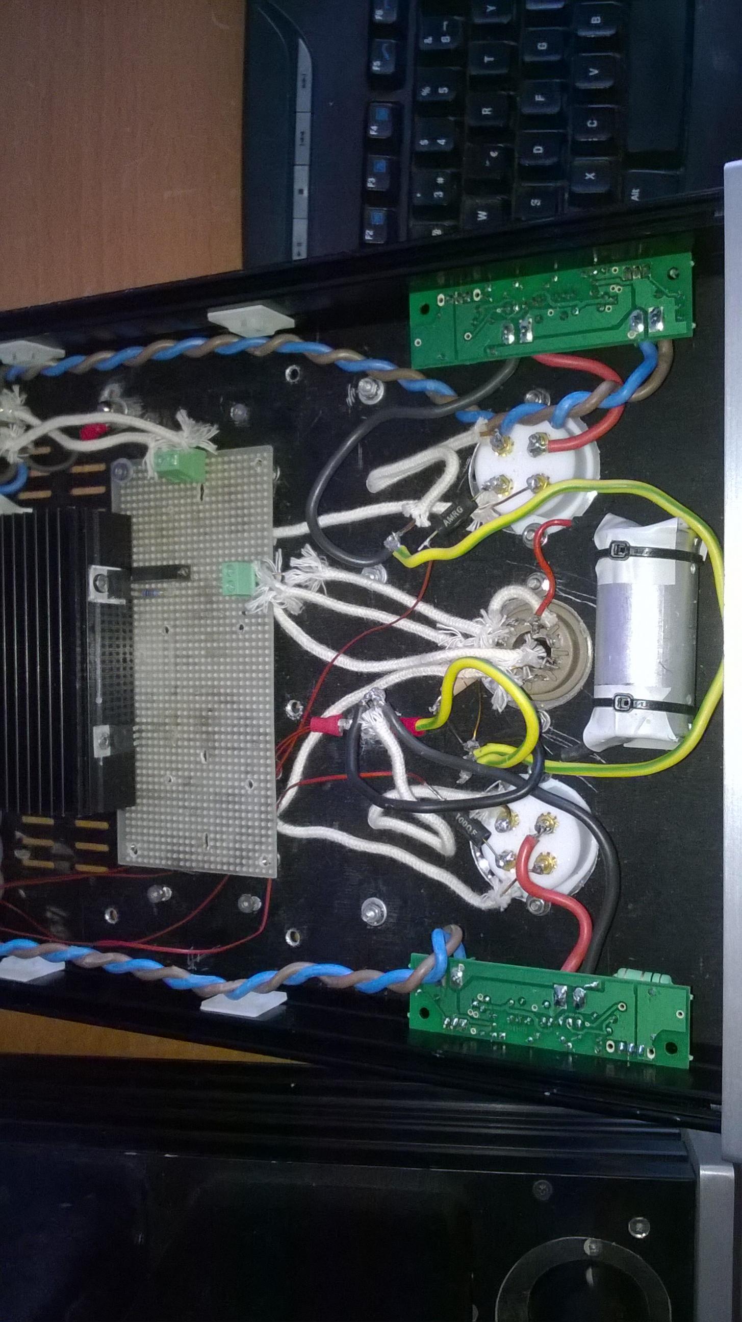

A detailed photo of the wiring will be helpful, to debug any oscillation problems.

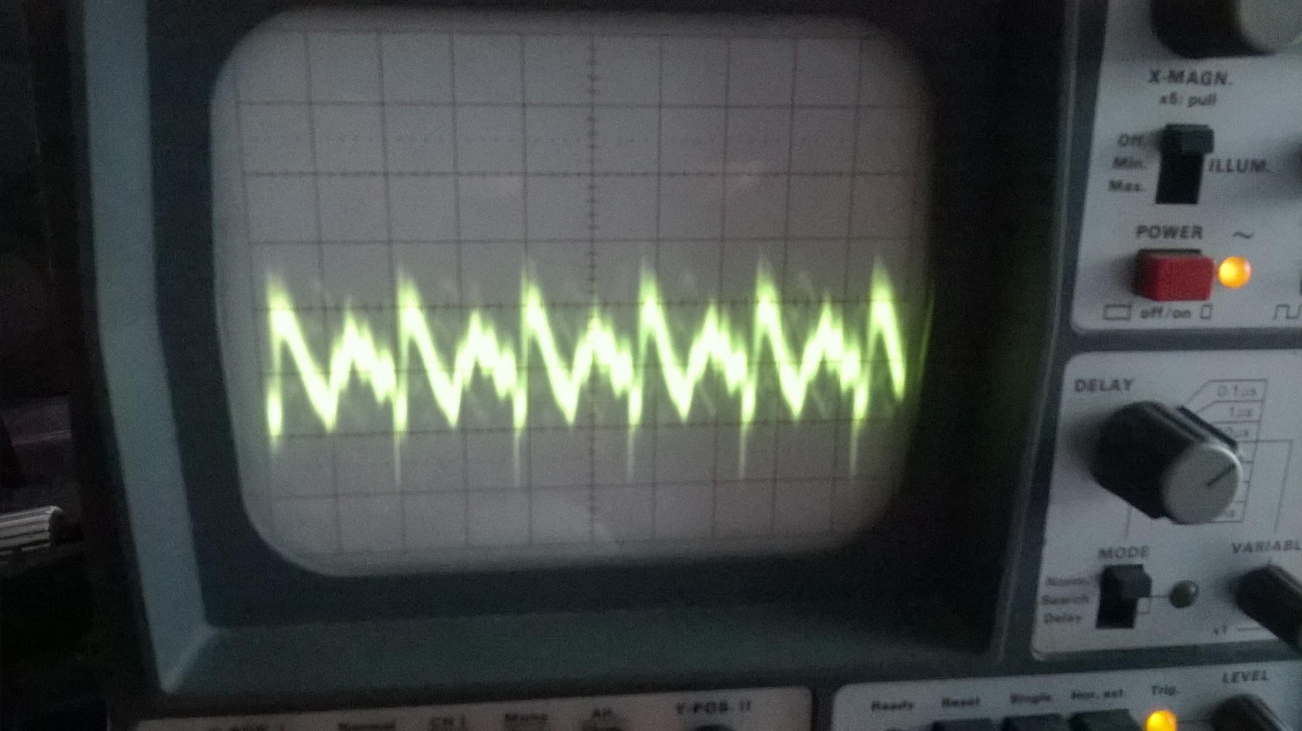

But 10mV of ultrasonics should not be enough to give such a bad reading for anode current.

Grid Wiring is much too long.
It would be better to mount the input sockets very near to the 26.
But, if you don't want to do that, please change the grid wire to screened cable (high quality). Quality Microphone cable can be used.
I agree.

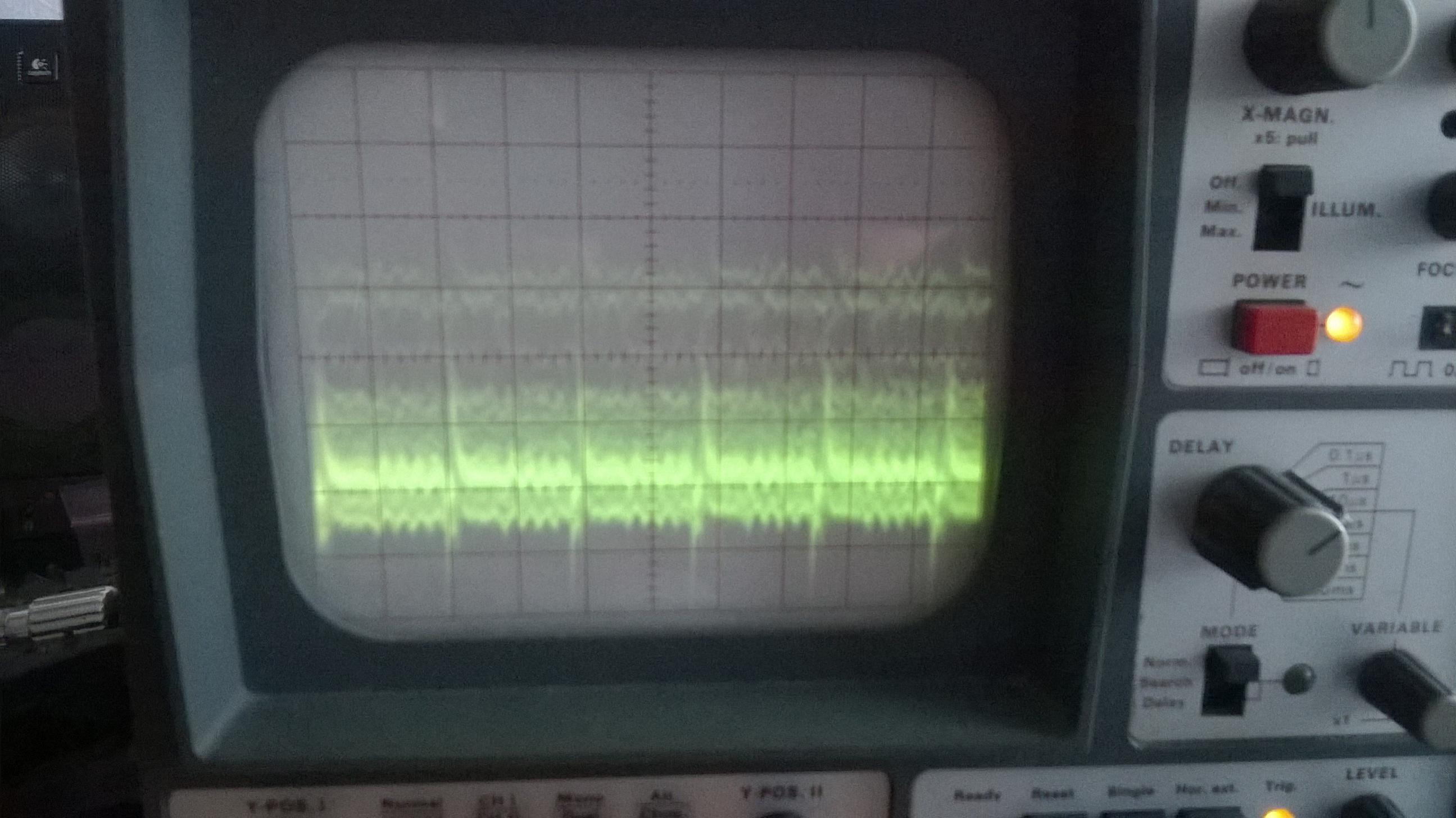

Shortened the cable to 1 meter and added the capacitor 100uF 63V Pana FC at the regs input. Attached measurements right channel new tube.
This looks much more plausible.
