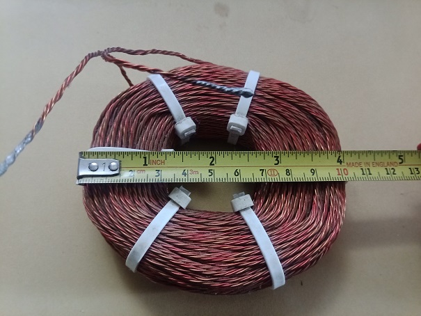

I made five of these a few years ago for the PS of my Aleph 5.
3.2mh 0.65 Ohm
I would buy off the shelf items today though as it was a bit of a chore to do. The ones I pointed to earlier are about £15 each.
