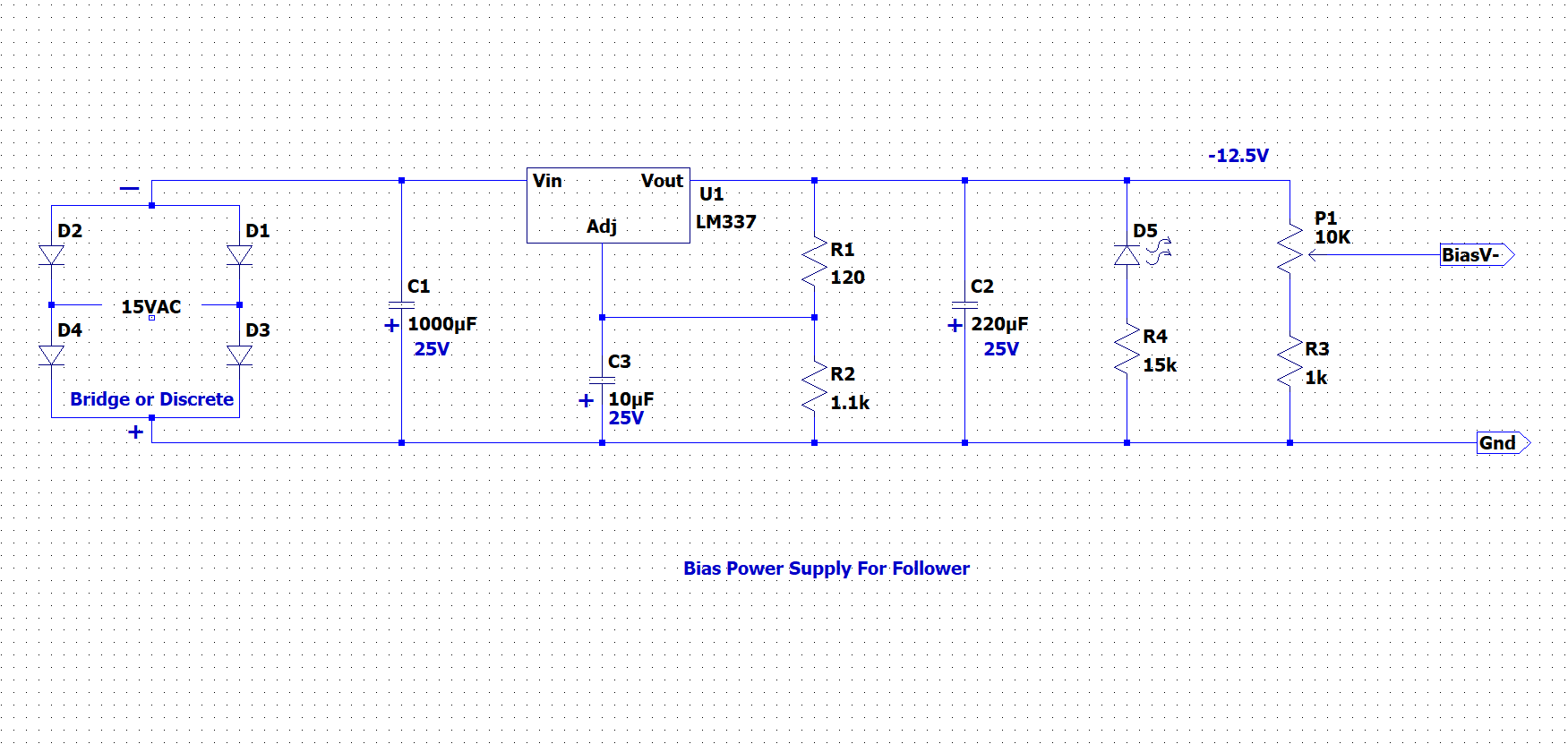

Now for the good news for the 2SK180. I still wanted to make use of the 2SK180 in some way. I decided to put the 2SK180 back into the amplifier but use it in a different implementation. I wired it up as a follower, putting the 193V after the 2SK180 and taking the speaker out from between the 1SK180 and 193V, and it was stable. Being a follower, it has no voltage gain so it needs a preamp with enough voltage output or a voltage gain stage in front of the 2SLK180 output stage. The harmonic distortion is also significantly lower as a follower.

-2SK180 needs source resistor if implemented as common source amplifier (voltage and current gain).
-THF-51S (drop-in replacement for 2SK180) is stable as common source amplifier.
-2SK180 and Hammond 193V as common drain amplifier (follower with only current gain) is stable and seems to have an edge in sound. Appropriate source/preamp with high voltage output required.
So far I really like the sound of the 2SK180 as a follower.
