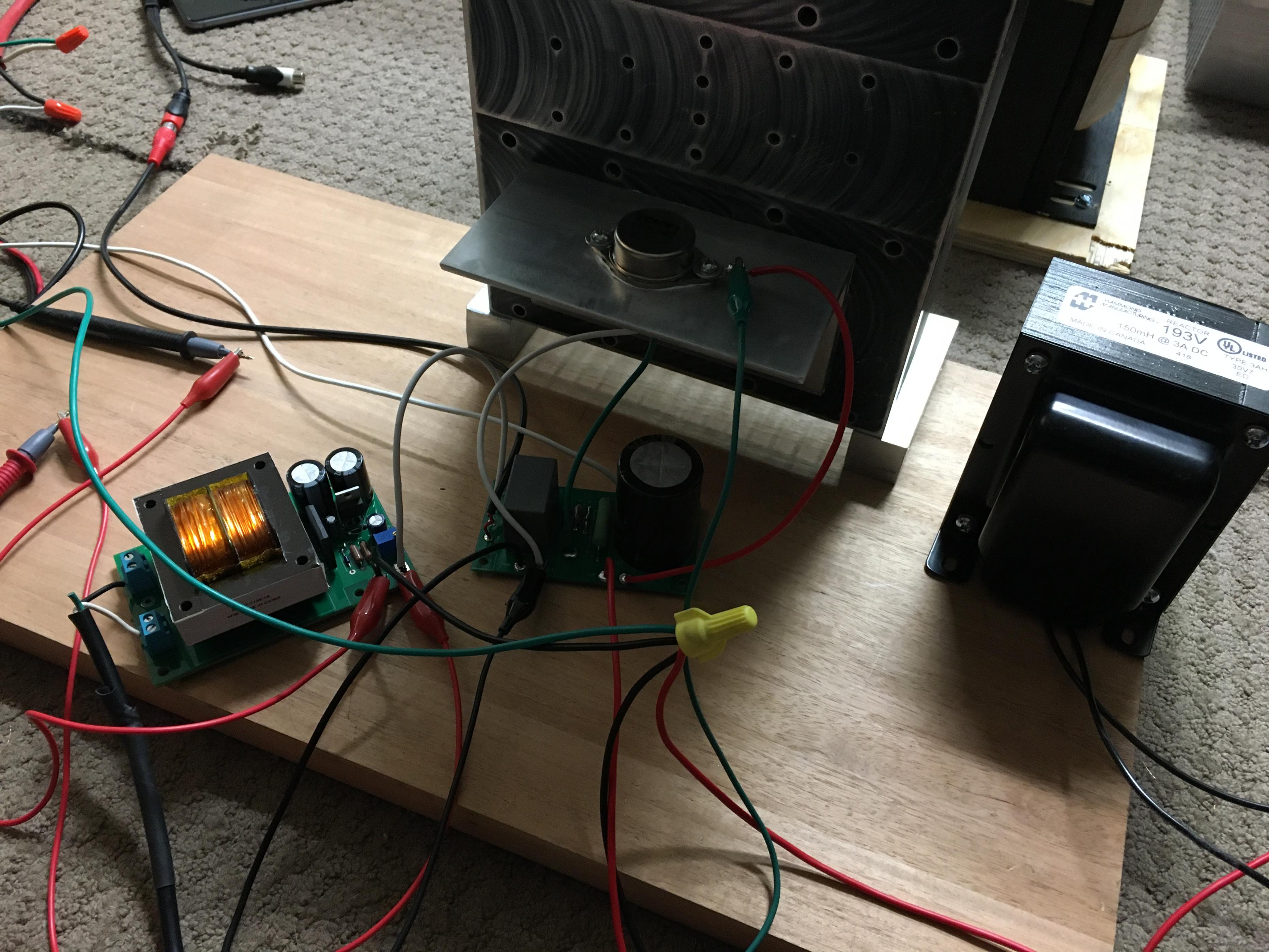

even made a bias/amp pcb for it, totally unnecessary. Vds 34Vdc, Vgs -3.463, 2.5A. Definitely worthy of a chassis for sure, thanks Ben! Btw, where do you guys get the isolation mounting hardware and thermal pads? MJPA was out of thermal pads. Tough to put together a chassis with live sinks😀

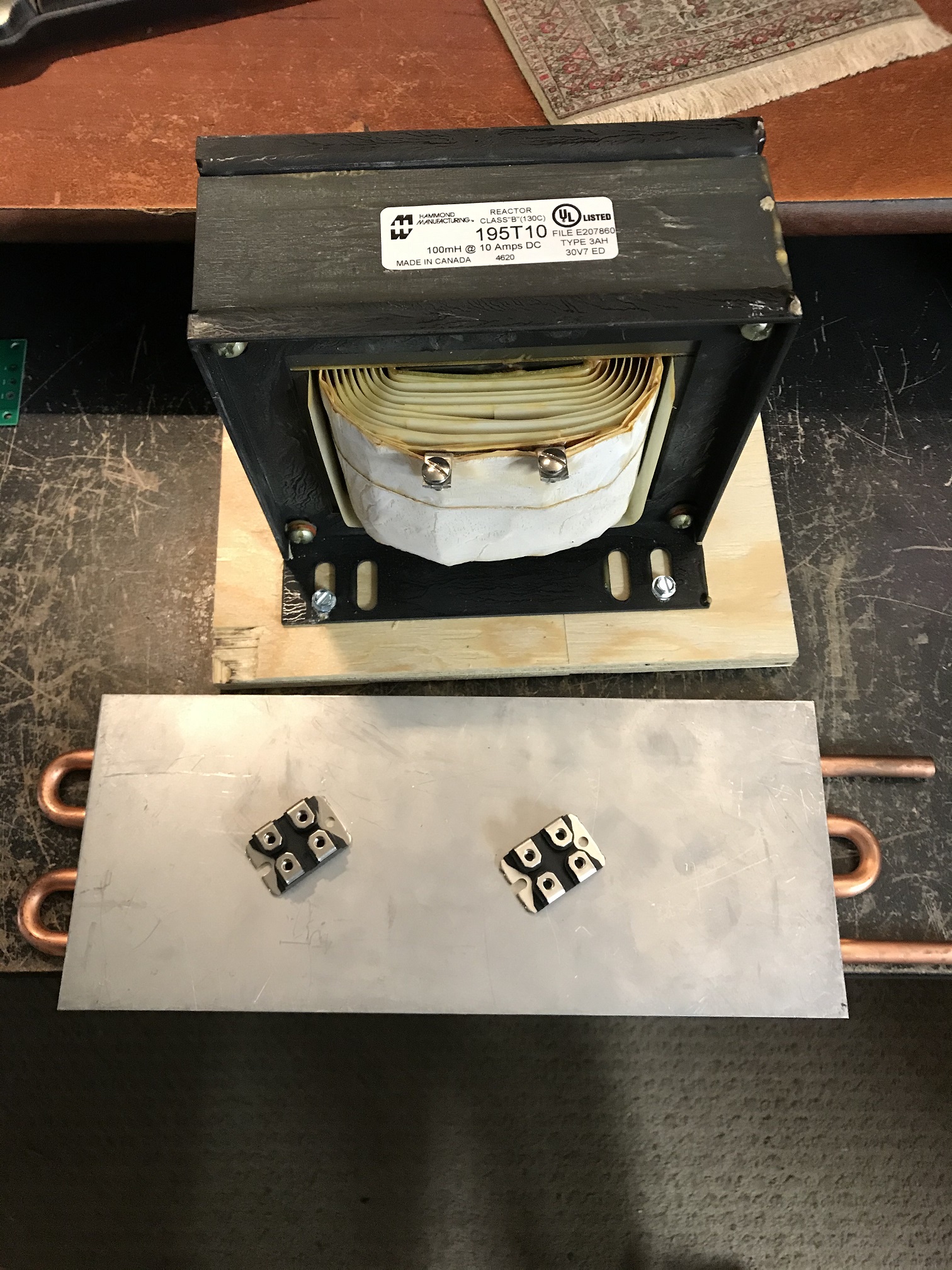

Had a brainstorm, not my idea. Seeing as these SITs are expensive and not super plentiful, this may be a good alternative...? Thinking something like 50-60Vds@5A, watercooled of course. Thoughts...?
A note of caution with that setup:
If I remember correctly: with the normal active CCS then there is no real risk of thermal runaway since the overall current is constrained by the upper opto CCS.
With a choke as CCS the lower FET can conduct as much current as it wants with no breaks on thermal runaway. When I experimented with that setup I added a 0.235 ohm source resistor for this reason. If you want the feedback circuit to ignore the source resistor then you can move the 1000 uF cap negative to above the source resitor like the F6 does.

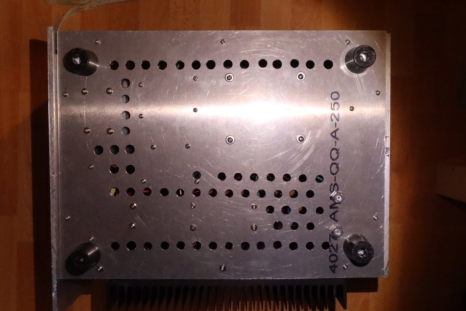

One Channel Finished

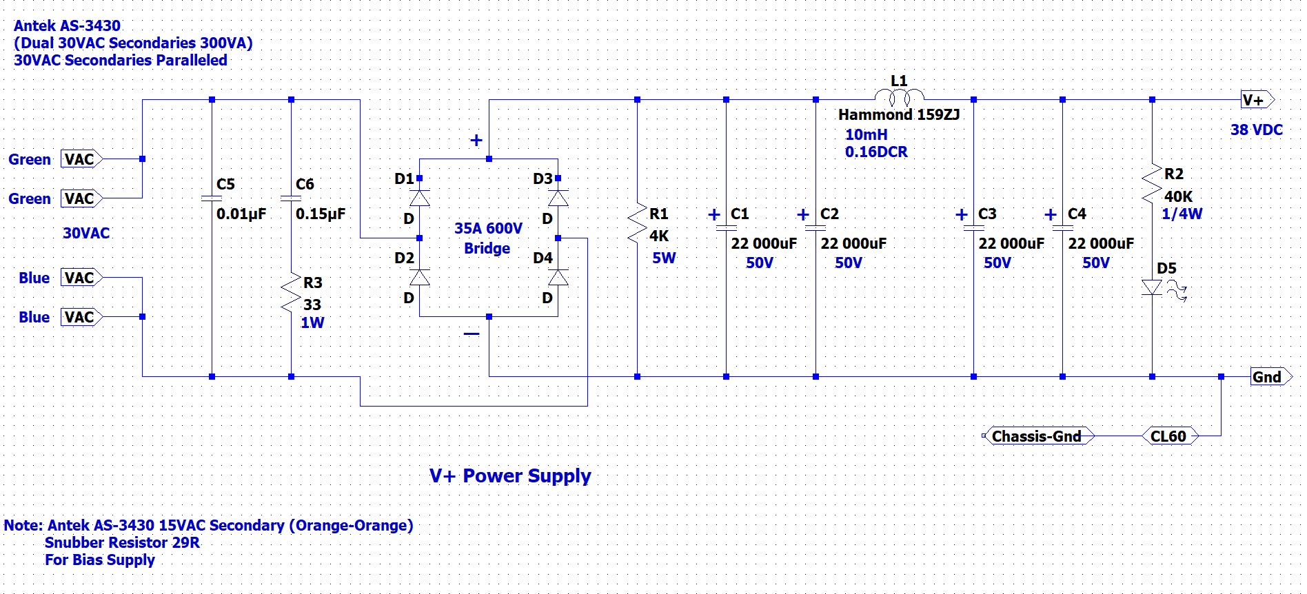

One channel is finished. I finished the power supply yesterday, tested it, and adjusted the bias.
The power supply with an Antek AS-3430 (30VAC 300VA) powering a CLC filter (44mF-Hammond 159ZJ-44mF) outputted 37.5 to 38.0 VDC under load. The voltage varied because of AC line variation over the three hours or so that I had it running. So the supply voltage was more or less what I had anticipated.
The bias stabilized after warm up as the temperature also stabilized. The interior of the case with the top in place was only a bit warm, so the holes that I drilled into the bottom plate, along with the 35mm rubber feet that provided clearance from floor to bottom plate to allow for better air flow, did their job.
So onward to finishing the other channel. Another bottom plate to drill, parts to install, and wiring to finish.

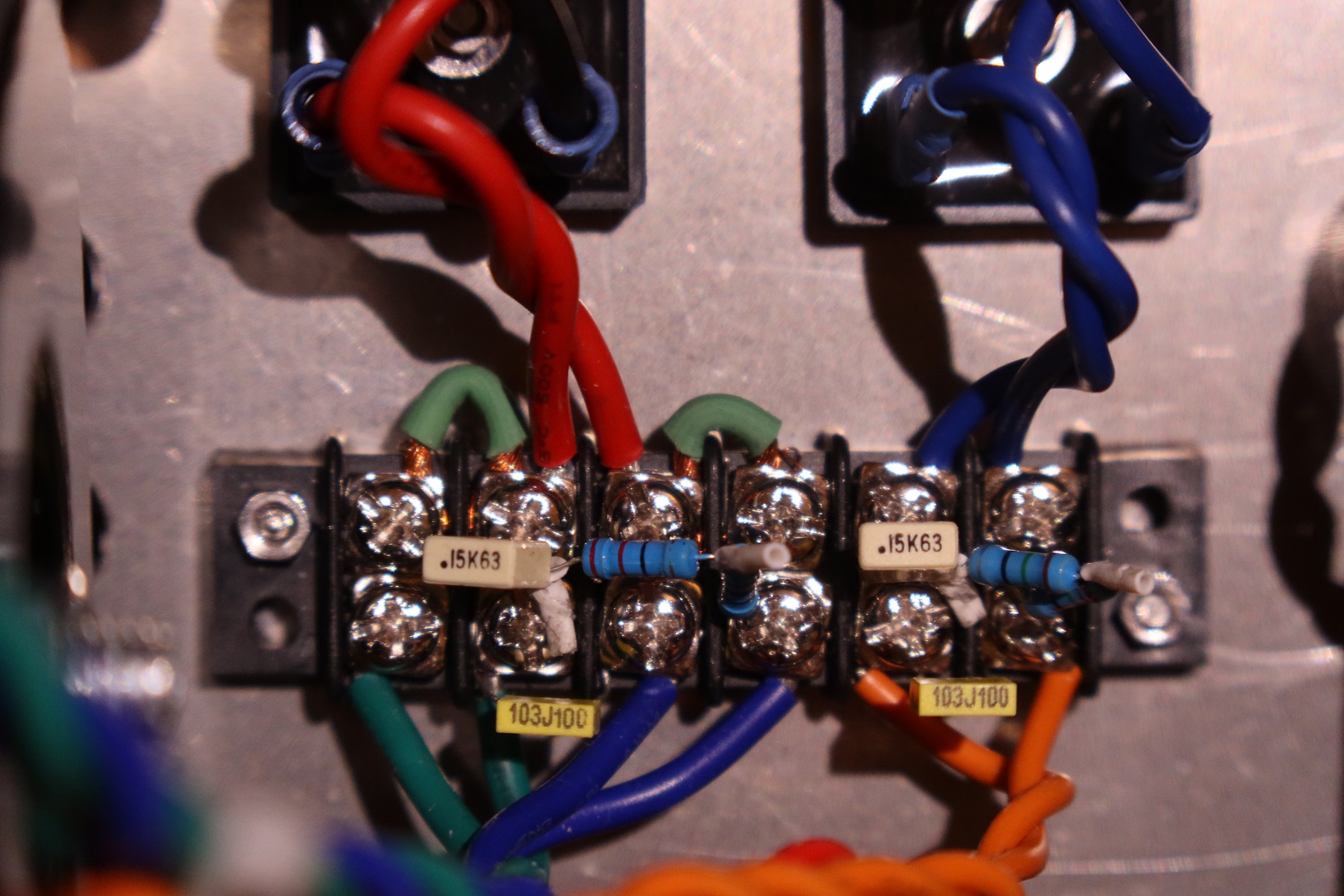

Here are some pictures and the schematic of the V+ power supply. I Quasimodoed the Antek AS-3430 and have included the snubber values.

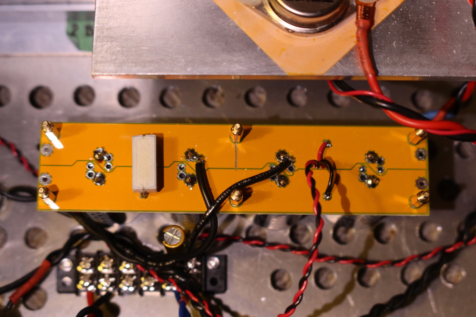

Zen Mod, Thanks, but I don't understand Zenglish: Master Scavenger??
peppennino, Thanks. I hand the drill most of the holes with no problems. The only holes that I make sure that I keep them as perpendicular to the plate as possible are the holes that require tapping and holes in plates thicker than 1/8". For those I use a drill guide.
When I drill holes, I have a wood box on the floor, plate to be drilled on top of the box, one foot on the plate, and drill from above. The holes end up fairly perpendicular. When I need the drill guide, one hand (a finger or two or three) on the guide, and drill in the other hand. Usually this is for M3 and M4 size holes so not a lot of effort is required to hold the guide in place. For large holes with stepped drill bits, no guide is necessary, even in thicker plate. I have drilled front panels free hand for round on-off switches with a stepped bit with no problems.
The drill guide is handy for keeping a tap perpendicular in holes too.
The second bottom plate was drilled this afternoon so all I have left to do is wire up the power supply. Then it will be all done and I will be able to listen to the amps in stereo.🙂

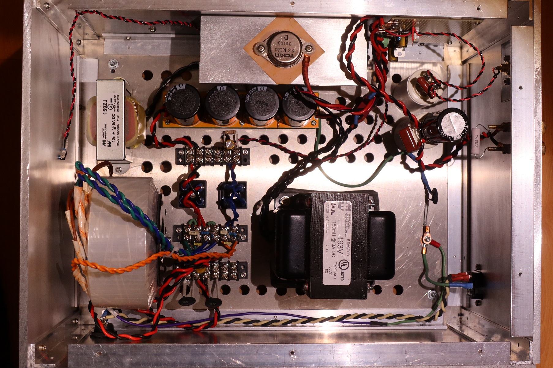

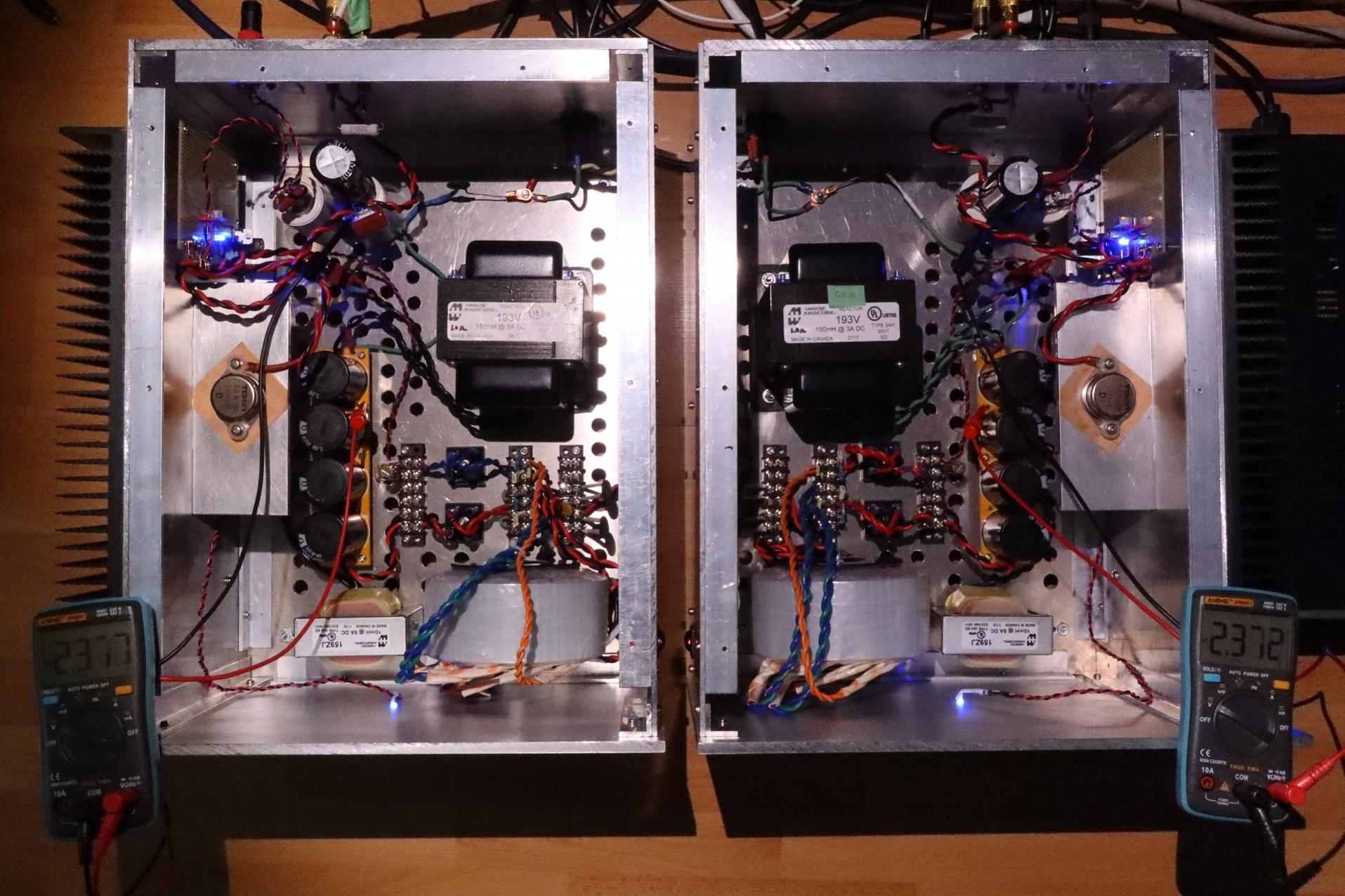

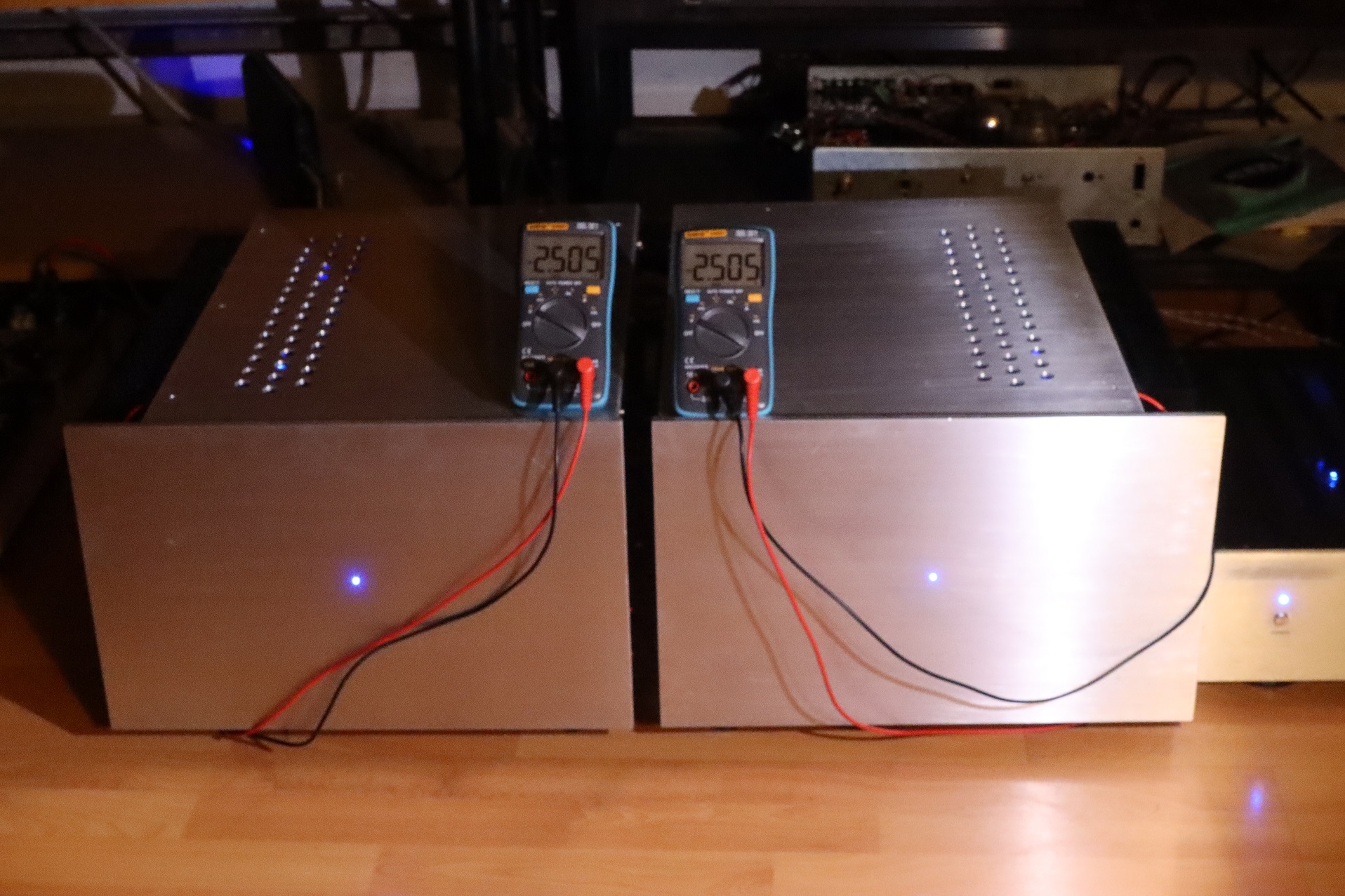

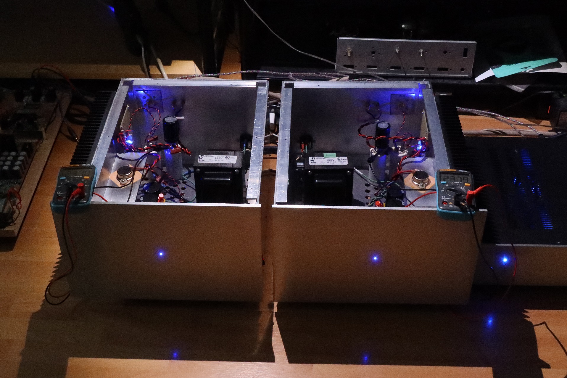

The mono blocks are finished. Biasing is done. It takes over two hours for the temperature and bias to reach a maximum. There is quite a bit of heat sinking and chassis mass to heat. The final bias varies a bit depending on the time of day, as the wall VAC varies.
The sound is typical of my SIT amps - it is excellent. I am very happy with the results. From memory, I don't believe the sound is much different from my BAF2015 THF-51S mono blocks. If I were to listen to them separately I don't think I would be able to identify which amps were playing.
I am glad I built these amps. For those of you that are bemoaning the lack of Sony VFETs, there are still many Tokins available for purchase. They may not be as cheap as they used to be, but at least they are still available. There are various amps that can be built with them, and they will sound just as good or even better than Sony VFET amps. Another plus for the Tokins is that you can build higher power amps than with Sony VFETs.
This amp is like a solid state version of a single ended 211 amp. I used to be a big fan of tubes, although I never ventured into 211/845 land. However, solid state doesn't have the problem of tube aging and tube noise, and the dangers and cost of extremely high voltage power supplies. Also the very low parts count of this amp is great - simple to build and simple to trouble shoot. It is so simple that if you double and triple check and test at various stages of the build, trouble shooting is probably not necessary. My build was trouble free.
Happily listening to music, enjoying my new amps.
