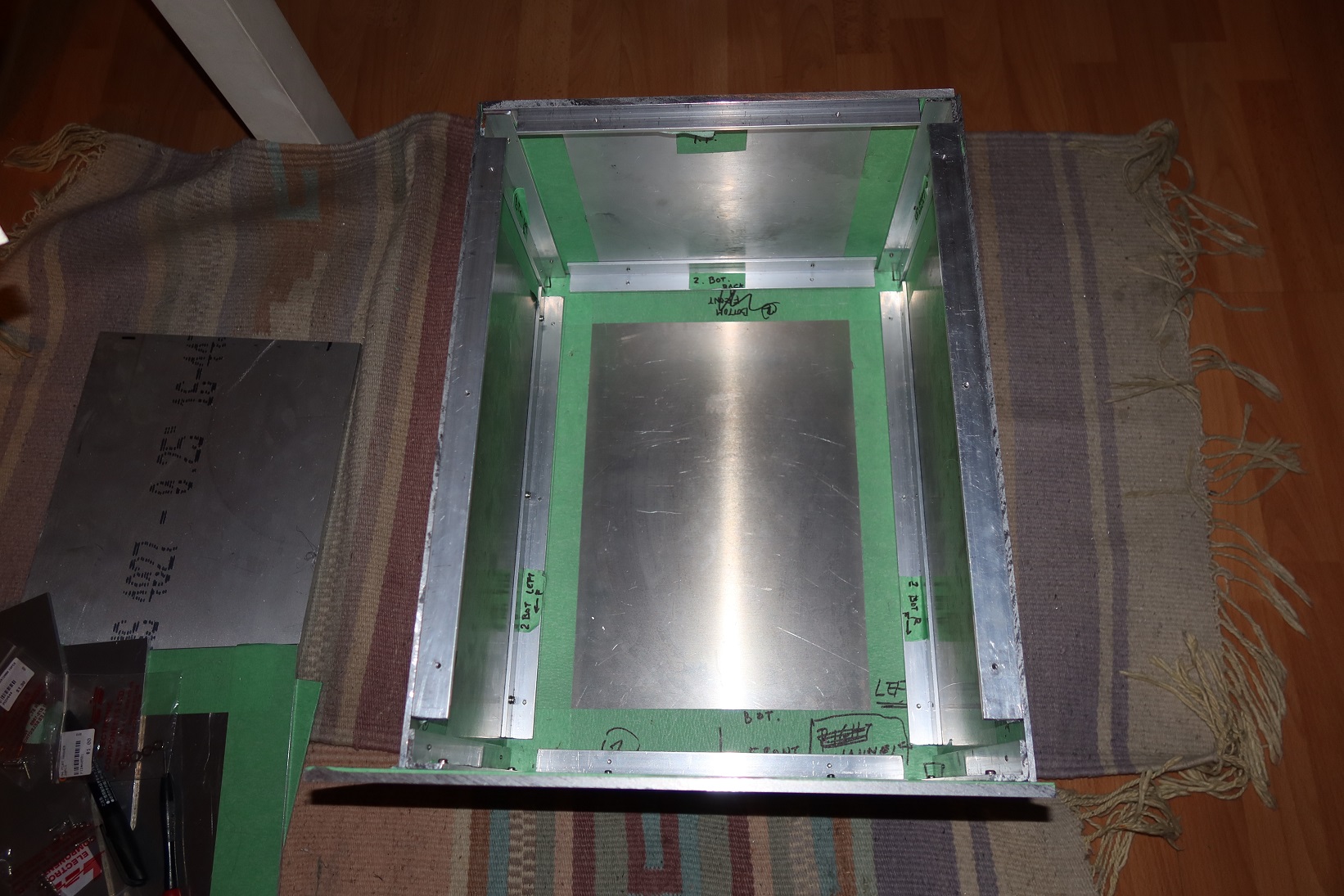

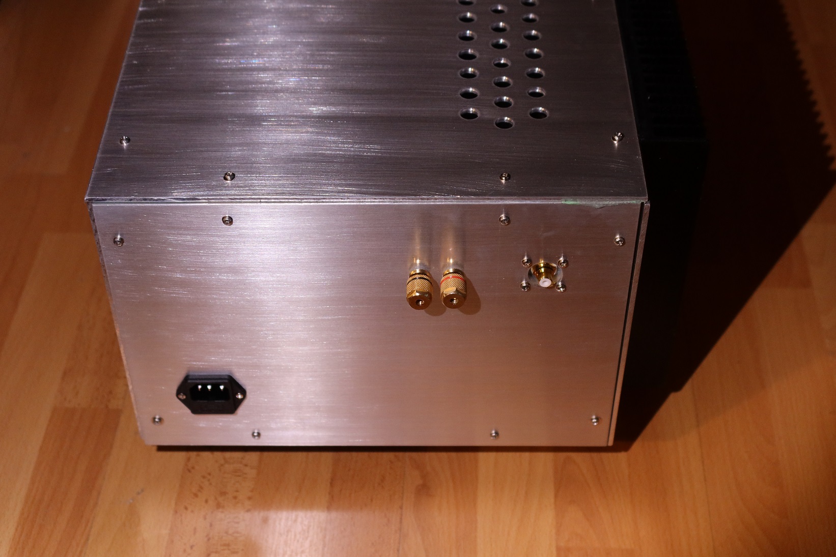

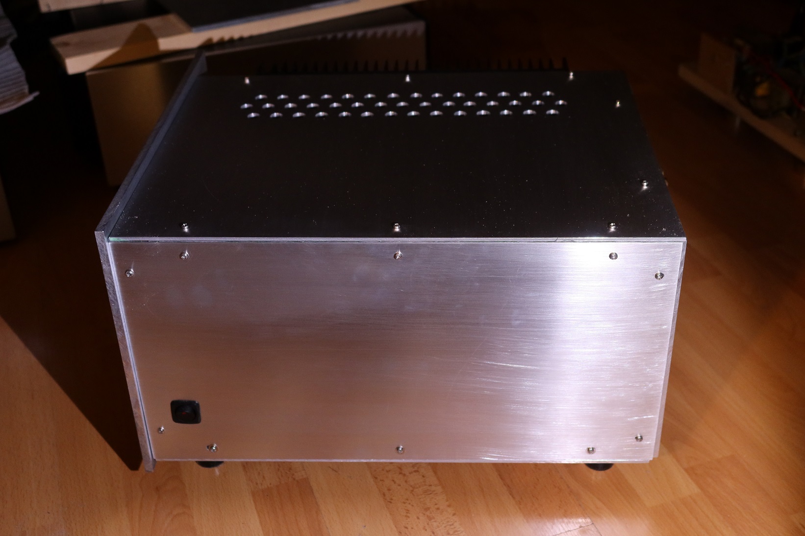

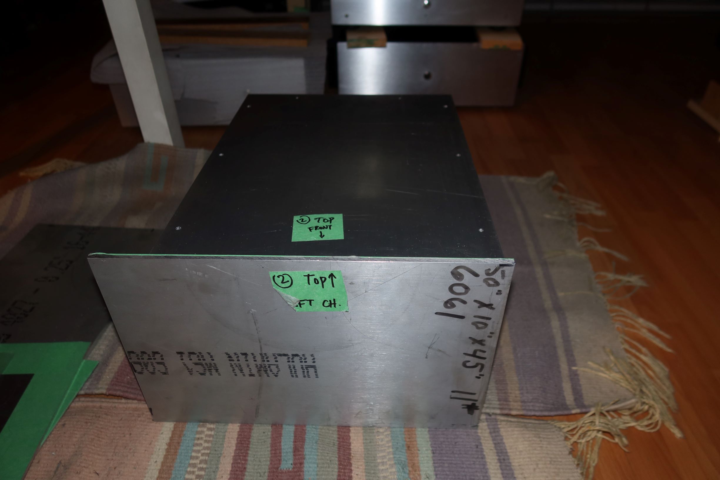

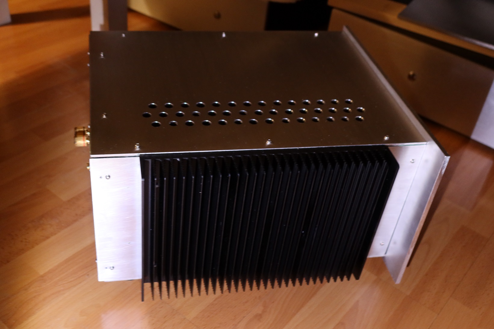

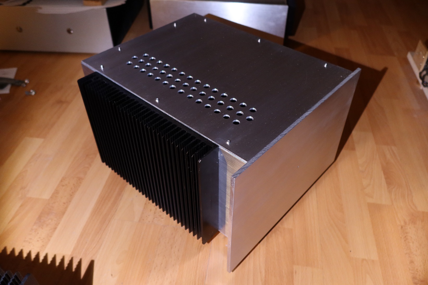

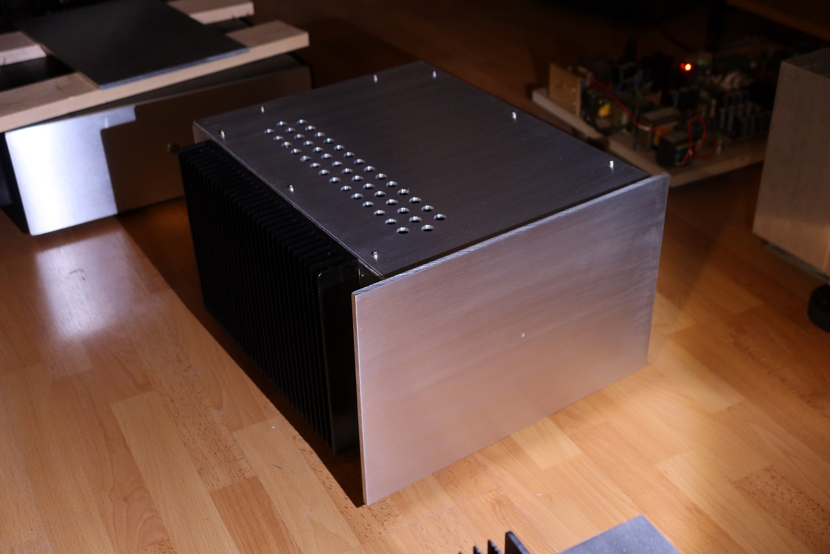

This post is about the monoblock chassis that I built for the amps. I had never built a chassis from scratch before, so this was a first for me since I could not find any commercially produced chassis that fitted my needs. I wanted two monoblock chassis with heatsinking on one side only, and the heat sink had to be able to dissipate quite a bit of heat.
The first consideration was the amount of heat that needed to be dissipated. The 2SK180 is a 300W device. Many advocate keeping maximum dissipation to 25% of rated dissipation for longevity of devices. However this is diy and pushing it a bit is only at the diyer's risk. Keeping the device cooler by providing more cooling/heat sinking would lower the risk.
So I decided to size the heat sink for at least 100W dissipation (in the end I only needed 88W dissipation). Assuming a maximum ambient temperature of 25 degrees Celcius and maximum heat sink temperature of 55 degrees Celcius, minimum heat sink requirement was (55-25)/100W = 0.30C/W. However this number is good for guidance only since published data for heat sinks, that is if you can find any information, usually do not specify the conditions for which they are valid. Information such as temperature differential is crucial. Many if not most heat sink data are based on a much higher temperature differential than the 30 degrees Celcius that I was aiming for. Therefore the manufacturer's number needed to be derated. Additionally the manufacturer's number my be or is probably based on fairly uniform distribution of heat sources throughout the heat sink. For this amplifier, there will only be one heat source on the heat sink. So again the manufacturer's number needed to be derated.
In the end I chose the Modushop 300mm x 200mm heat sink with a rating of 0.18C/W, compared to my minimum requirement of 0.30C/W.
With the heat sink decided, I sized the monoblock chassis. Basically I eyeballed it based on my previous experience. I decided to be generous on the size since many of my past builds have had components tightly crammed into just barely large enough boxes. The 200mm (8") heat sink height dictated the chassis height, and I decided on a width of 12" and depth of 16".
Except for the front panel, all panels were 1/8" aluminum, with 1/4" aluminum for the front. 3/4" x 3/4" x 1/8" angles were used for connect all of the panels at corners, with M3 screws into tapped holes. A 2 1/2" x 2 1/2" x 1/4" x 6" long angle was chosen for the 2SK180 attachment to the heatsink. This was attached to the heat sink with six M4 screws.
I ordered all of the aluminum online from a supplier here in British Columbia. After picking it up at the post office outlet and then after a very uncomfortable walk home (it got heavier and heavier after each step), I examined all of the pieces and found that all of the panels were not exactly square, and panels that should be identical were not. There were cutting tolerances of a few millimeters in every which direction. In the end I nudged and tweaked the fitment of the pieces and managed to put the pieces together to form two reasonably square and decent looking chassis.

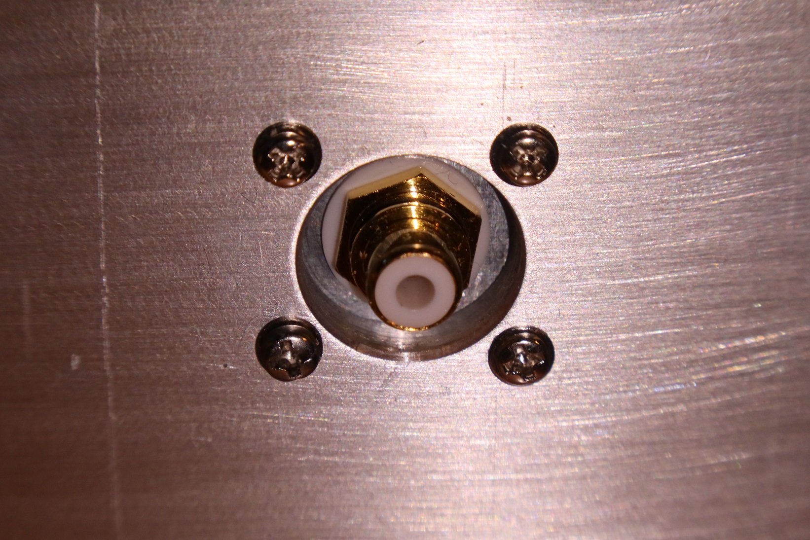

Also the back panel was supposed to be 1/8" plate, but I was sent 1/4" plate. That made cutting the opening for the IEC jack a lot more difficult. I ended up drilling a series of overlapping holes and then using a rotary tool with cutting disc to remove material for the hole, and then finished it with a file. The plate thickness was also a problem for the RCA connector. The connector was not longer enough so I drilled an oversized hole, mounted the RCA jack on a piece of light gauge steel plate, and attached the whole assembly onto the the back plate with the RCA connector centred within the oversized hole.
The chassis are now complete, with just a bit more sanding to do once the electronics and wiring are done.
All work was done using hand held tools. I do not have a drill press nor do I have room for a drill press. The work was tedious but quite manageable. I will do it again if I need another chassis or two, especially if a commercial chassis does not fit my needs.

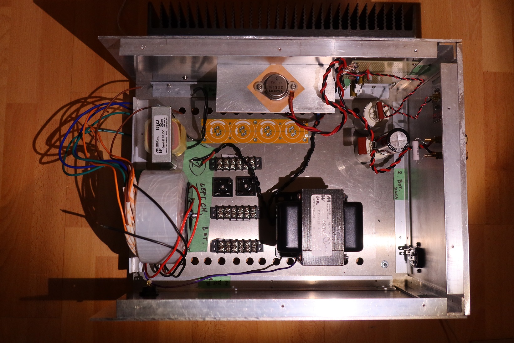

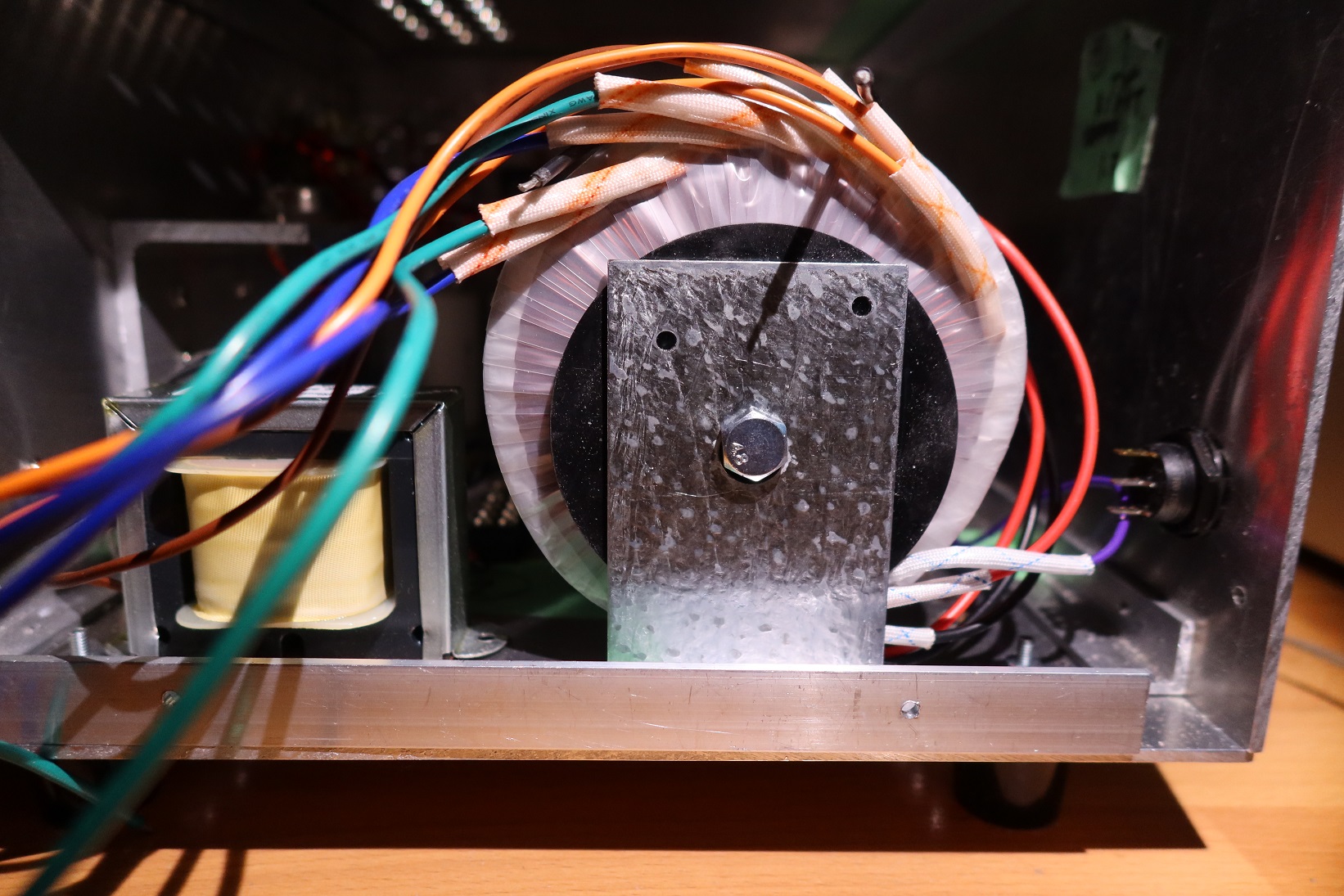

I have all the parts for the power supplies so the final push is on. Here is a shot of the power supply component layout, ready for more drilling.
Also the Simpson StrongTie A24 bracket (or similar by other manufacturers) is a great transformer vertical mounting bracket, available at local hardware stores.
