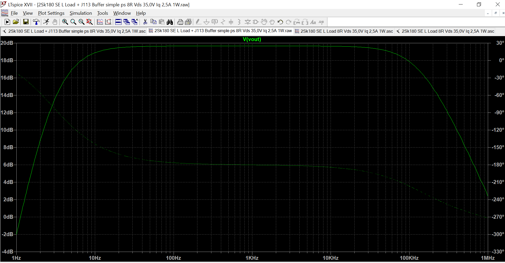

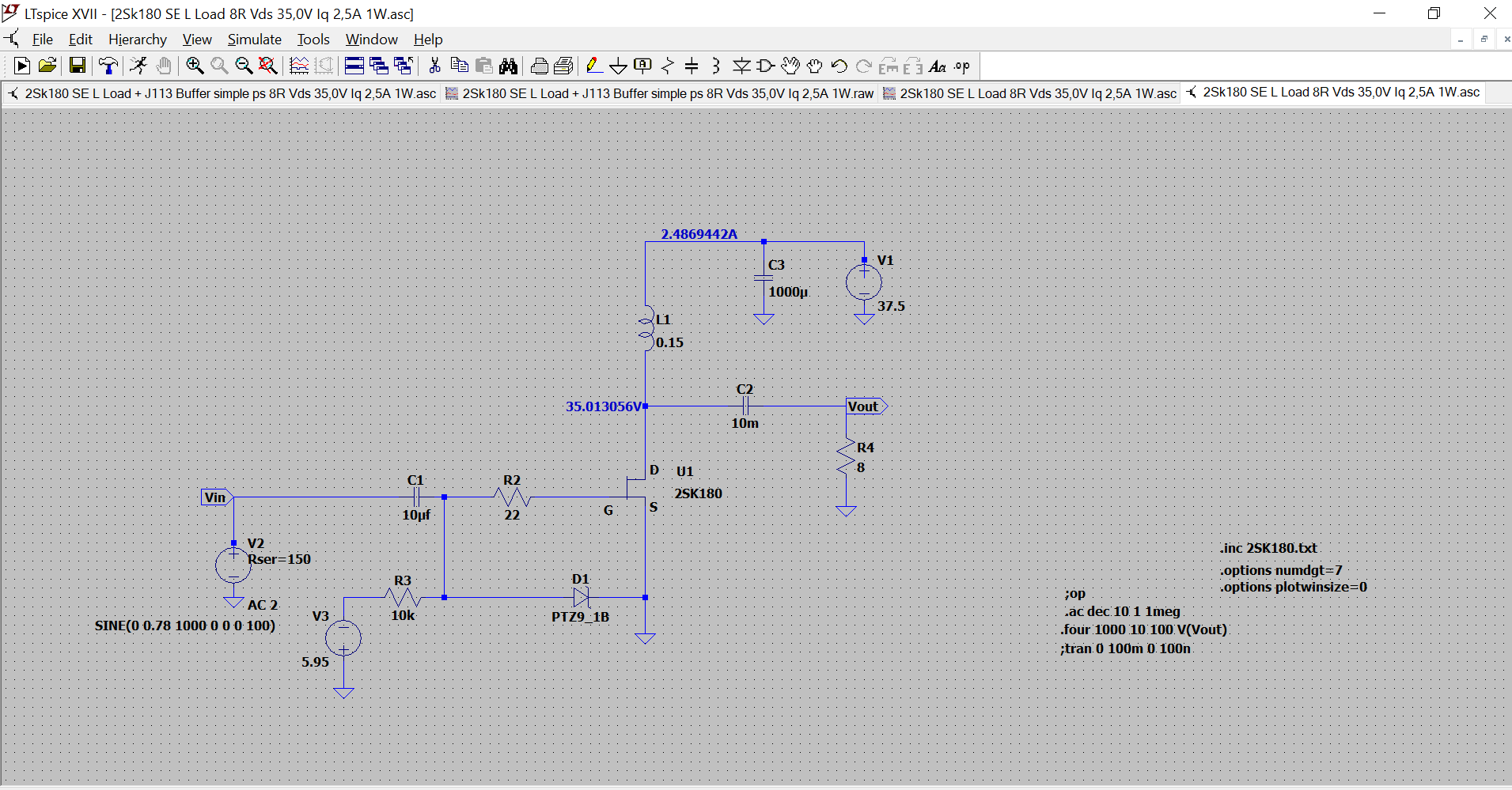

One characteristic of the Tokin SITs is their high input capacitance. According to spec sheets, it is 2500pF for both the 2SK180 and 2SK182ES, and 5000pF for the THF-51S.
This is a potential problem, depending on the output impedance of the source that connects directly to the amplifier, as the output impedance in conjunction with the Tokin device input impedance form a first order low pass filter. In the case of the 2SK180, a source output impedance of about 150 Ohm will produce a flat frequency output to approximately 20kHz, and then be 2dB down at about 55kHz.
So if a preamp or source that connects directly to a 2SK180 amplifier stage has an output impedance of 150 Ohms or less, there is no audible high frequency roll-off. If the output impedance is only a bit higher than 150 Ohms, perhaps the listener can tolerate a bit of roll-off. And as the output impedance of the connected source increases, the high frequency roll-off point becomes lower and lower.

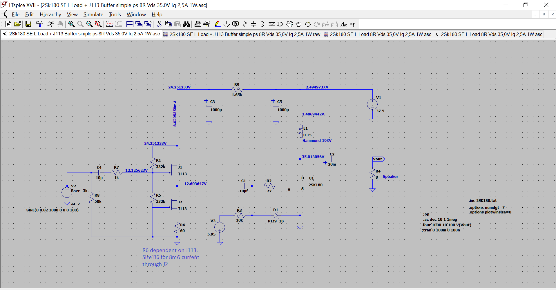

The solution to the problem is to add an input buffer to the amplifier.
My preamp, the Luminaria, has an output impedance of about 75 Ohms, so high frequency roll-off is not an issue. No input buffer is included in my build.
For those needing an input buffer, or just want one so that any preamp or source can be connected without any worries of high frequency roll-off, there are many buffer designs to choose from. Since people here are Pass fans and this is a Pass forum, a logical choice would be a B1 or B1 R2, without the volume control. However with the scarcity and price of those JFETs, a very acceptable choice would be J113 jfets as implemented in the input of the B1 Korg preamp. I say, if it is good enough for the B1 Korg, it is good enough for the 2SK180 L'Amp. And it is readily available at a low cost.
I have included two LTSpice simulations- without buffer and with buffer to show the effects of a buffer and also to show the schematics of the buffer circuit. The simulation with buffer shows a source output impedance of 3K Ohm, and flat frequency output to nearly 30kHz, and 2dB down at about 90kHz, so the buffer does the job.

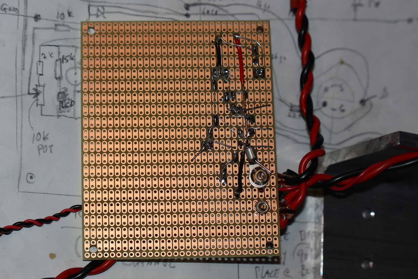

As can be seen in my pictures, I wired everything point to point. The actual amplification circuit is very simple with very few parts. Most of the electonic circuits is the bias supply and V+ supply. Before I took up solid state amplification a few years ago, I built tube circuits with point to point wiring, so I am used to doing point to wiring.

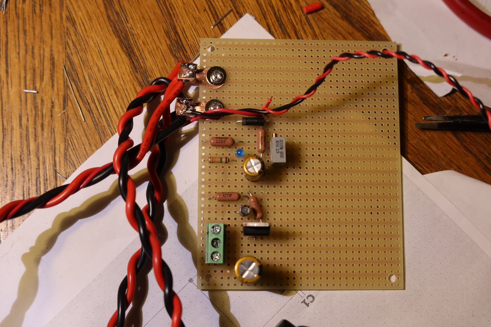

But all is not lost. Zen Mod has a pcb that does it all. It has a bias power supply and input buffer all in one. Just connect a V+ power supply and Hammond 193V, transformer secondary for bias supply AC, a 2SK180, and output coupling cap, and that's it.
The Zen Mod Singing Bush Lower/Gain PCB:
