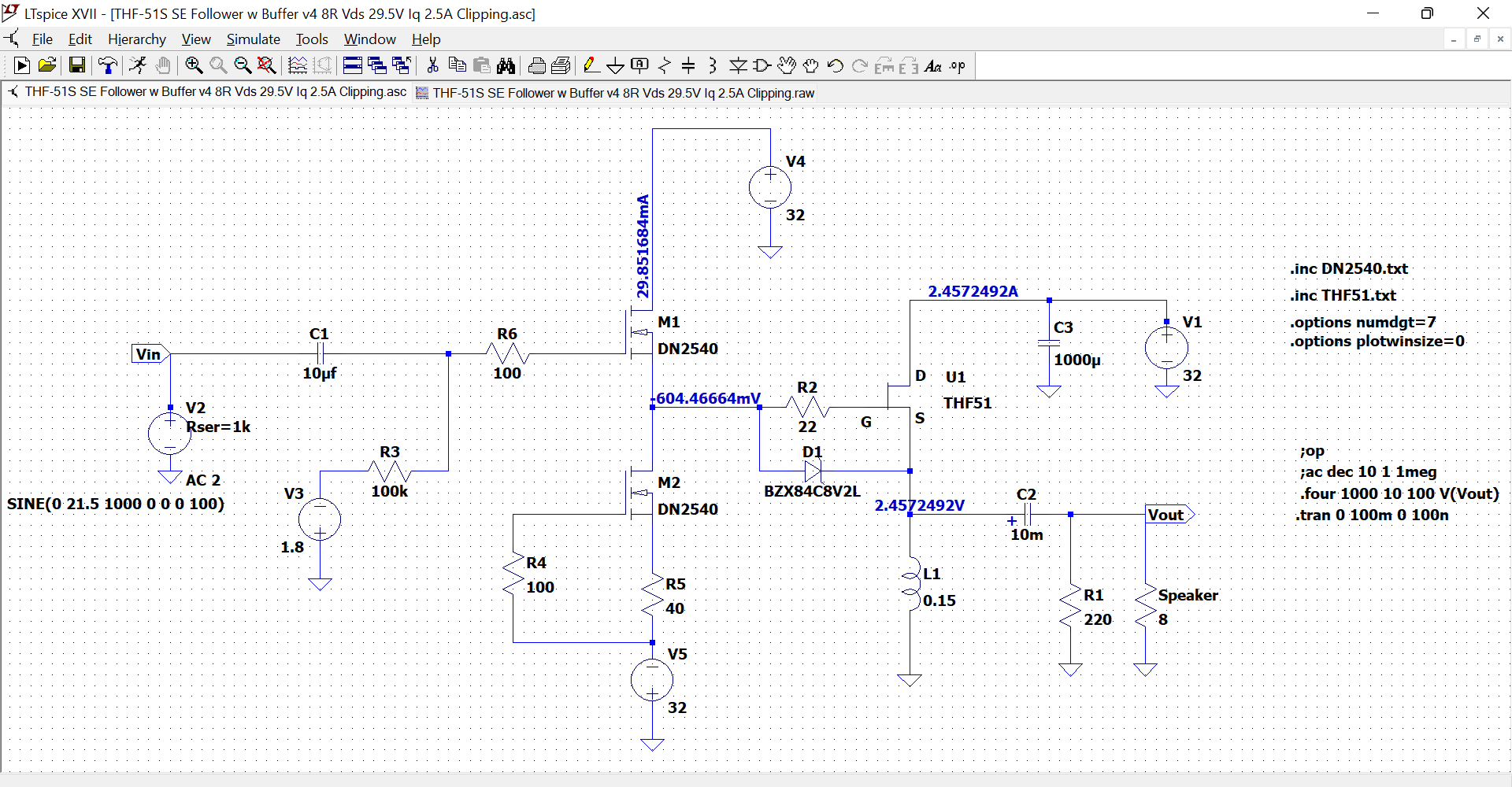

Yes, the DC coupling is intentional, the bias is set at the input of the JFET buffer. ZM had mentioned some pages back he took this approach to avoid issues with gate current / bias drift. I've done similar in tube circuits with DC-coupled cathode followers - bias at the input of the CF to set the output operating point and drive the tube grid in A2. And if you have capacitor phobia, one less cap in the signal path 🙂 if both the tube and VFET stages are put in the same chassis, a heater winding could be used for the bias supply, which is convenient.
Won't that zener limit the positive waveform too early?
It is borderline, any smaller and it would be a problem, but certainly could use more wiggle room, will increase it in the final, 15 or 18V.

You may consider a way to adjust the THF51 gate bias voltage for a real-world build.
Don't think so. The THF51 is configured as a source follower, so the source voltage will always be close to the gate voltage.Won't that zener limit the positive waveform too early?
I see it now. Yes, it is a cunning plan. Let the JFET buffer supply any gate leakage current to the big SIT.Yes, the DC coupling is intentional, the bias is set at the input of the JFET buffer. ZM had mentioned some pages back he took this approach to avoid issues with gate current / bias drift. I've done similar in tube circuits with DC-coupled cathode followers - bias at the input of the CF to set the output operating point and drive the tube grid in A2. And if you have capacitor phobia, one less cap in the signal path 🙂 if both the tube and VFET stages are put in the same chassis, a heater winding could be used for the bias supply, which is convenient.

Thanks! Still needs some work. Since the output has no gain, the buffer needs to swing a decent amount of voltage and clips just before the output, the complementary pair is already run near its limit. So perhaps I need to re-evaluate the buffer, or reduce the output bias current for a lower power design. I had originally looked at a common source config which would alleviate that issue and reduce gain needs of the tube stage, but the output impedance is quite high in common source and most seem to prefer common drain.
If I were to do a common source design, might consider something like this - gain requirements for the tube stage are not demanding, so could use step-down transformer coupling between the tube stage and JFET buffer with biasing through the transformer secondary. Voltage swing in the buffer then is low as the extra gain is made up for in the VFET stage. But distortion and output impedance are both significantly higher. My thinking is the common drain version would sound best.
I was wrong but not for that reason. There is about 4v between gate and source but i missed the negative bias in front of the jfets
source follows gate alwaysWon't that zener limit the positive waveform too early?
zener is protection device
Оne can argue that with a 24v supply for the buffer, there is little the zener achieves apart from sounding bad. Were the Tokins not supposed to take at least -20v at the gate? If i were paranoid i would reduce the buffer's supply to +/-20v and remove the zener.
if you're Chicken as ZM, zener is a must
I'm also blind how zener there results in sounding bad

One possible solution is to use a different device for the buffer. For instance in Michael Rothacher's Luminaria preamp a DN2540 is used for input buffering. I have that in my Luminaria and I am happy with the sound. If I were to build a buffer to handle high voltage signals, I would probably use a DN2540 or similar with a CCS and bipolar power supply. Here is an article that suggests two other devices and also compares them to the DN2540. Probably any one of the three devices would do - just have to play around with the voltages and current a bit. Unfortunately two of the three are hard to get right now:

Thanks Ben, I was thinking the same, going with a beefier buffer could be the easiest way. I only went with the 2SK170/2SJ74 due to their reputation for good sound. I'm going to explore some options over the next week or so. Oddly enough, I have a small stash of IXTP08N100D2 as well as TO-92-3 and TO-220 DN2540. Also should have a few AOT1N60 around, another popular buffer MOSFET. Might have a pair of Cree C2M1000170D too, I was doing a lot of experimentation with tube > source follower circuits at one time. I didn't realize the IXYS parts were becoming scarce, especially my favorite, the IXCP10M45S! This might be a problem for some other projects I have ongoing...let me do some research / run some sims and come up with some ideas for an alternative buffer.
I don't think choosing a Mosfet for the buffer will be an issue. You will be "hearing" the triode gain stage over it anyways.

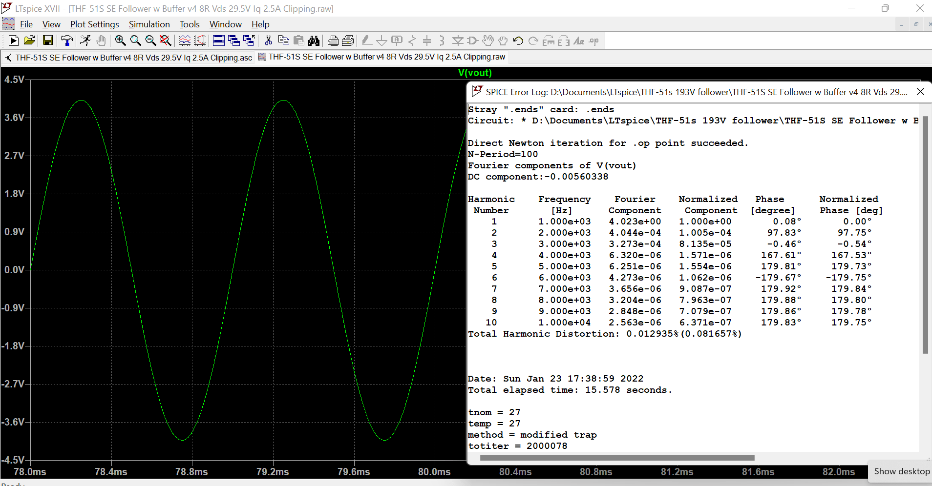

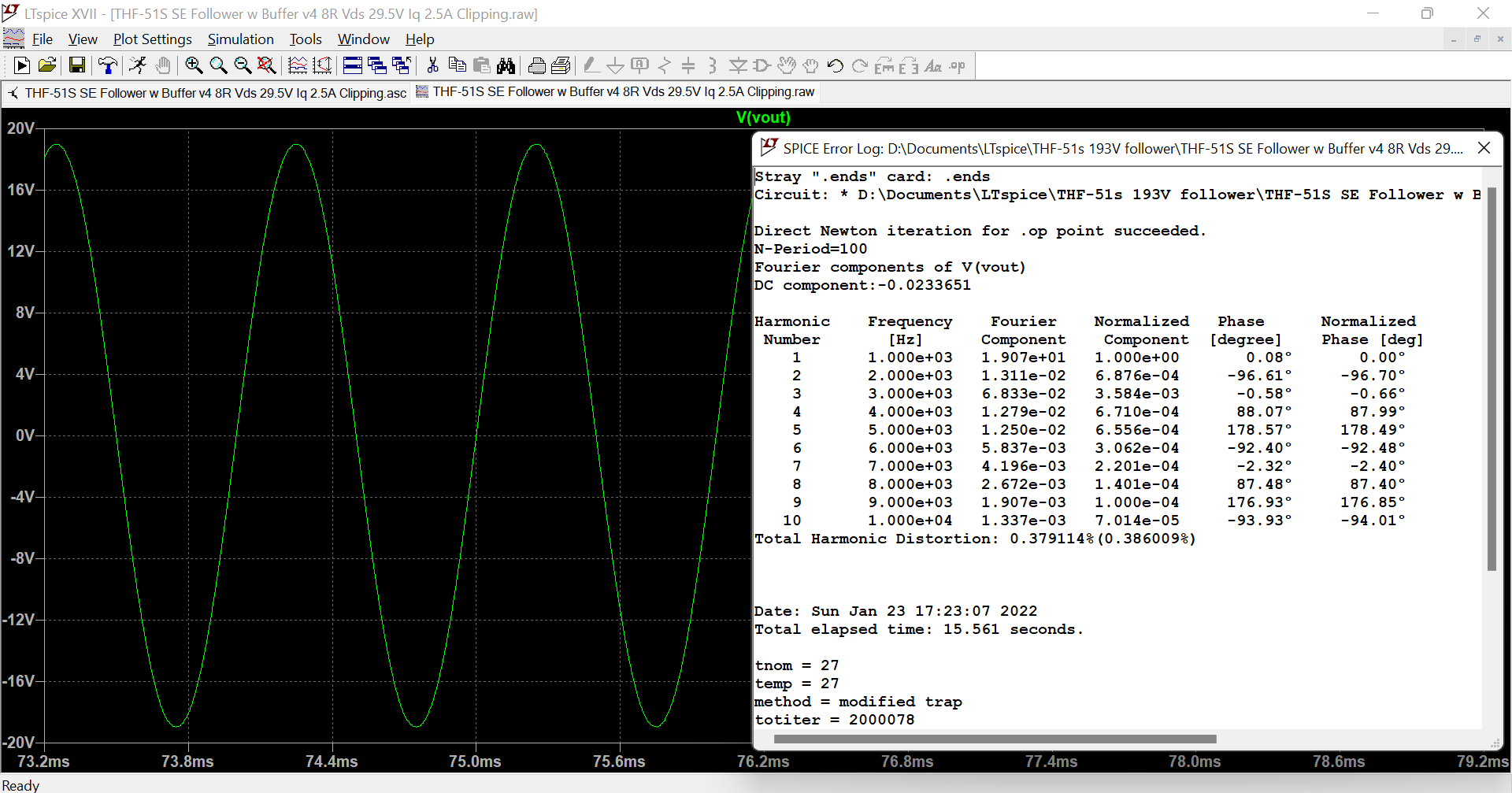

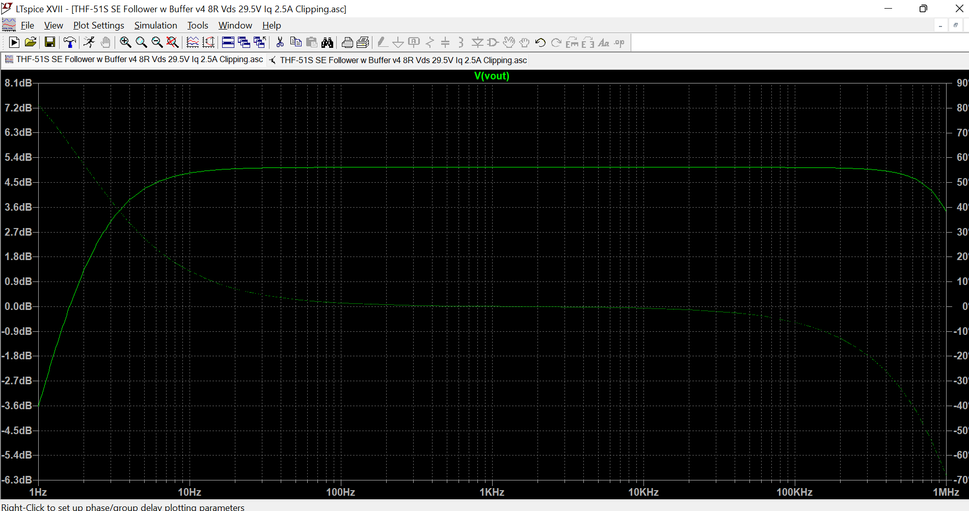

I did some LTSpicing and it is doable. Actual THD will most likely be higher.
At some point I will build a stand-alone voltage gain stage and I will most likely use the DN2540 or something similar for the buffer.
