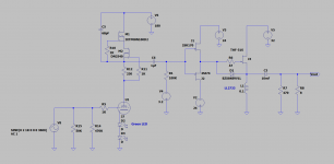

I posted on this thread some months ago as I was planning to build my first VFET amplifier. I gathered materials, but had to shelve the project to build some tube amplifiers and a DAC. Now I am back at it! Doing some planning and catching up on what has been tried here. Right now I am looking at doing a tube front end, followed by a JFET buffer, then THF-51S final.
Here is what I have in mind at the moment - type 37 CCS loaded tube gain stage wired as a hybrid mu-follower into a complementary JFET buffer DC-coupled to common drain THF-51S with choke load. This makes around 19W with a 1.5Vrms input sensitivity. Alternatively, the JFET buffer could use a pair of 2SK170 as a WCF.
Bandwidth is good in simulation.
I have some THF-51S, six in total, and nice thermal / insulating pads I bought way back when. Also a few examples of type 37 triodes. The amplifier could use type 76 as well.
Working on the power supply now, will post some more as things come along. Nothing finalized yet, just making plans.
That looks like fun. Maybe need a coupling capacitor to go from +/– 24V JFet buffer to +32 / 0 V output stage?
