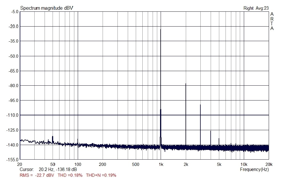

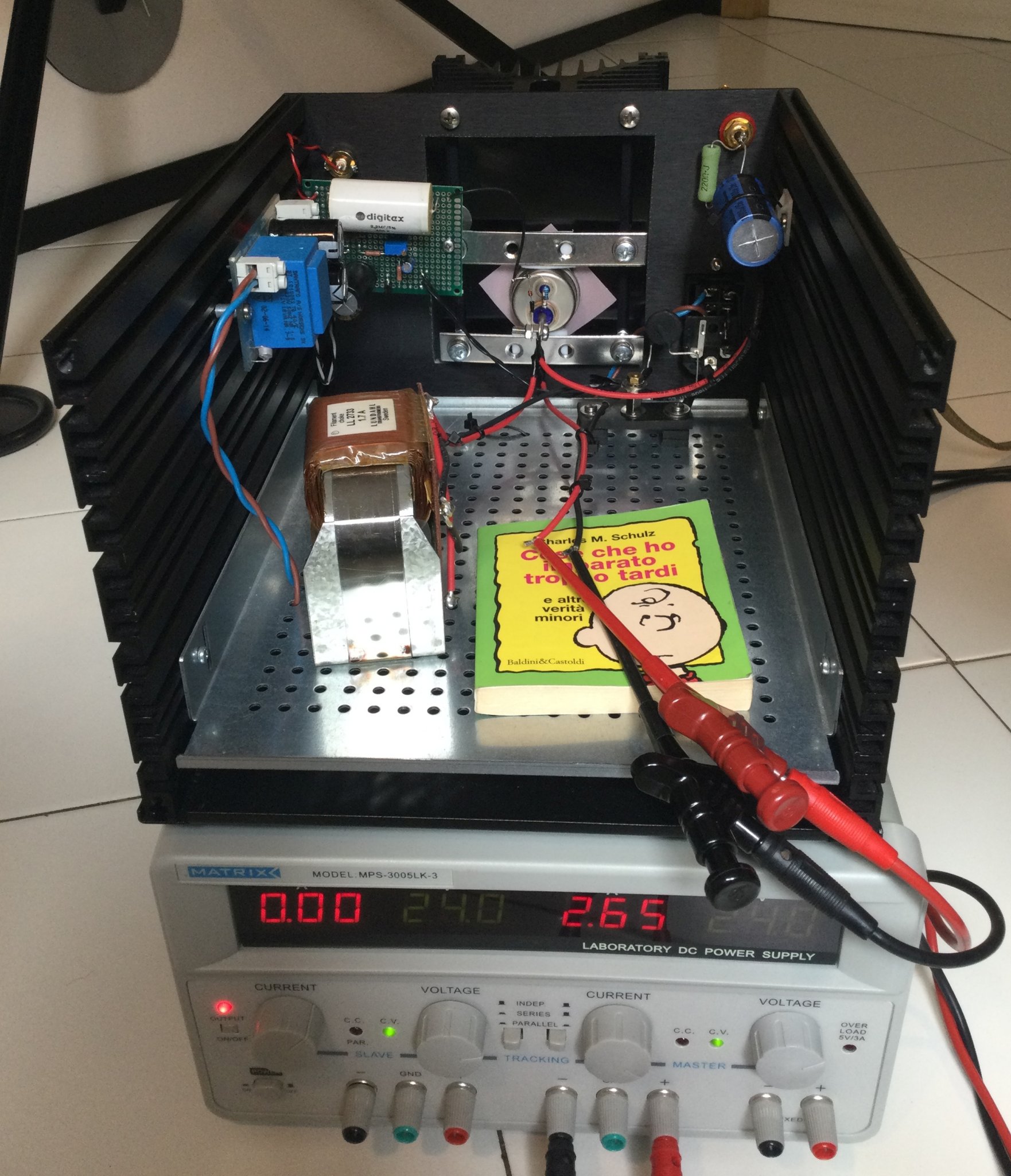

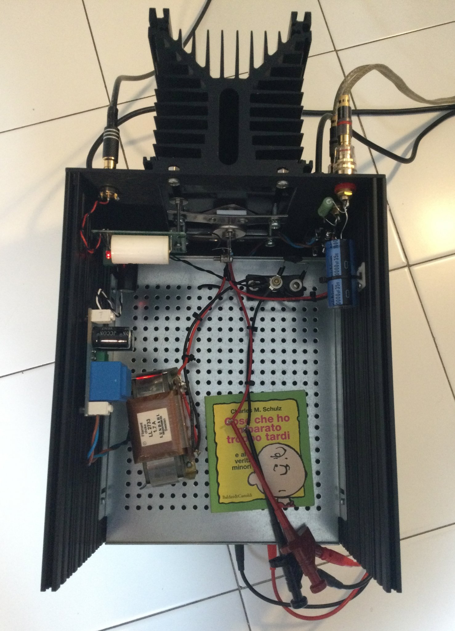

These are pictures from my last experiment with the THF-51S. It's a small FOKIN. The power supply is 24 Volt and the current about 2.6 Ampere. Only 60 Watt of Power Dissipation. The output power with 8 R is low. The measurements stop at just over 7 W. My measurements system does not allow me to go further. I think the maximum power does not exceed 12 W. The distortion is a little higher than Ben's FOKIN. However, weight and heat are more easily managed. Maybe it's not a bad idea to build the second channel and power each channel with a MEAN WELL (GTS160A24-R7B).

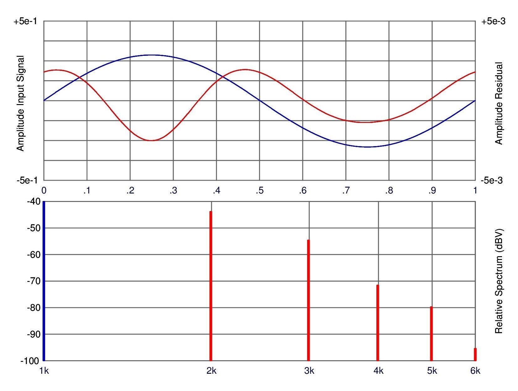

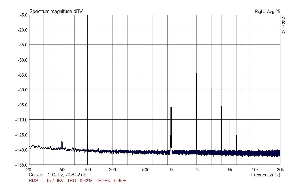

The Arta graphs are the measurements with 2.64 V, 5.84 V and 7.32 V on the load (8 R). The Diana residual (red) is with 7.75 V, the harmonics are normalized.
I used Peter Millet's interface for the DAC output and the ADC input of the sound card (EMU 1212). The chassis is the Galaxy 4U 230 x 280 mm + Base Plate 210 x 260 mm. The heatsink is 15 cm high and fits perfectly (after drilling) to the rear panel.

The distortion results look very good. I think you may be able to get more than 12W out of it with Iq at 2.6A, perhaps close to 18W at clipping. Choke loading is more efficient than CCS loading.
My choke loaded 2SK28 follower running at Vds of 21.0V and Iq of 1.5A clipped at around 12.5W at 8 Ohm.

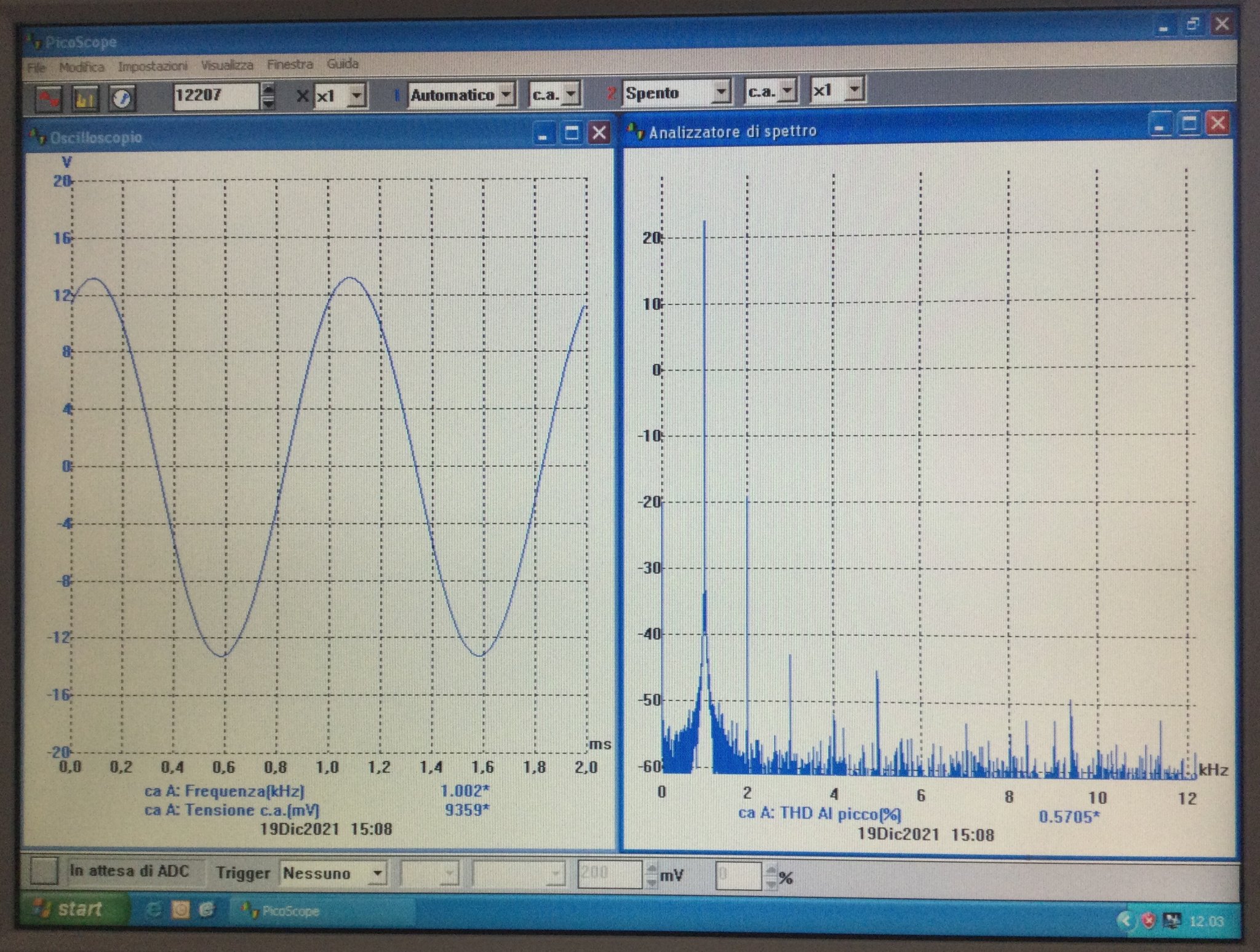

I have ran other test with the THF-51S. A voltage of about 23.5 Volt (Mean Well-24V + R-C filter) lowers the Vds too much. THD and output power deteriorated. It is a pity to use in this way a SIT with 400 Watt of the Total Power Dissipation. On the other hand, i have verified that the heatsink can safely dissipate about 67-70 Watt. A better operating point is this:
V+=28V Vds=25.7V Ids=2.67A
The triode-tipe distortion is good and the output power easily exceed 11W.
This is an FFT with my vintage gear (PICO + TEK SG505). The generator is at maximum. This way the project can continue.

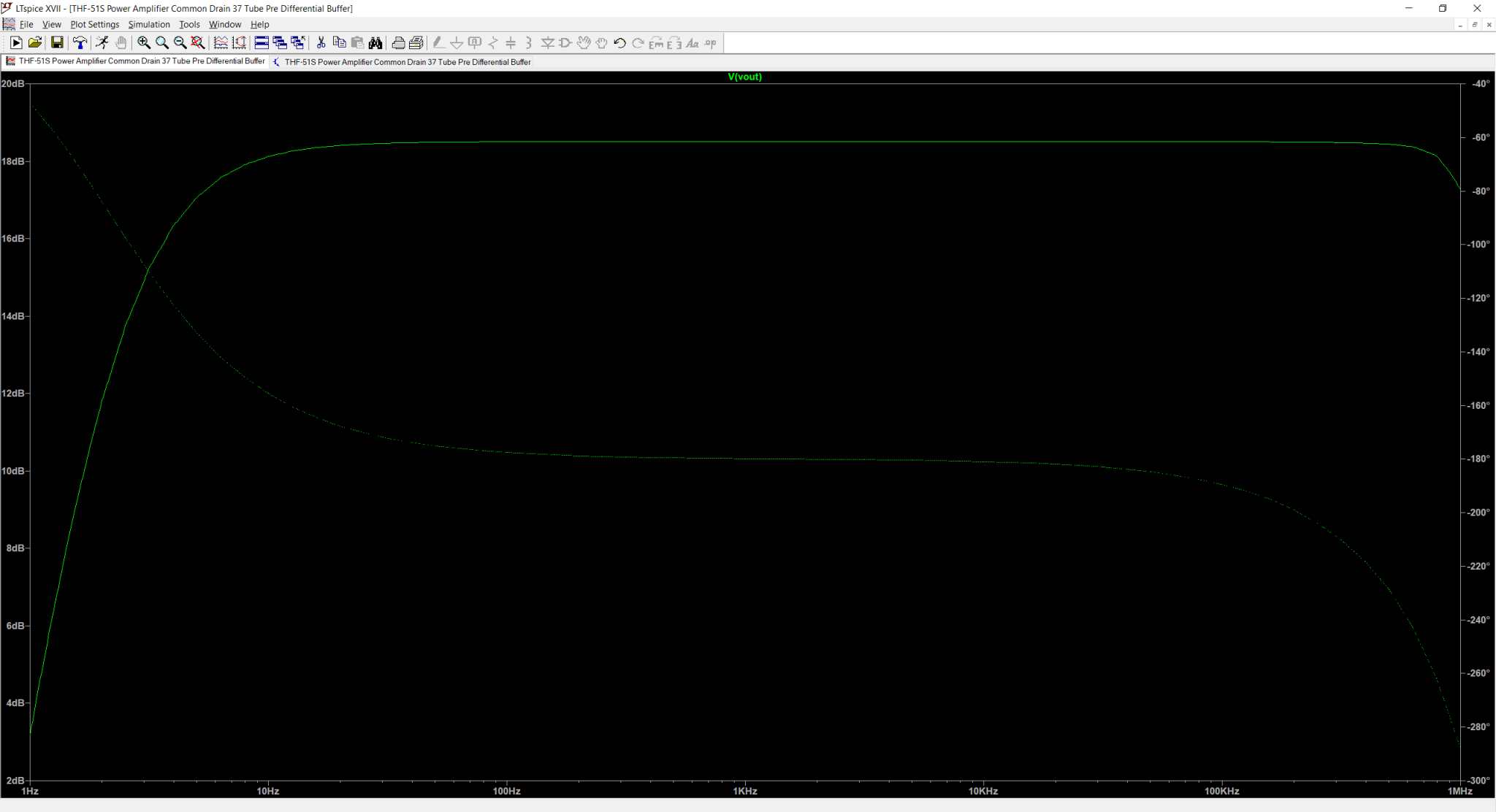

Here is what I have in mind at the moment - type 37 CCS loaded tube gain stage wired as a hybrid mu-follower into a complementary JFET buffer DC-coupled to common drain THF-51S with choke load. This makes around 19W with a 1.5Vrms input sensitivity. Alternatively, the JFET buffer could use a pair of 2SK170 as a WCF.
Bandwidth is good in simulation.
