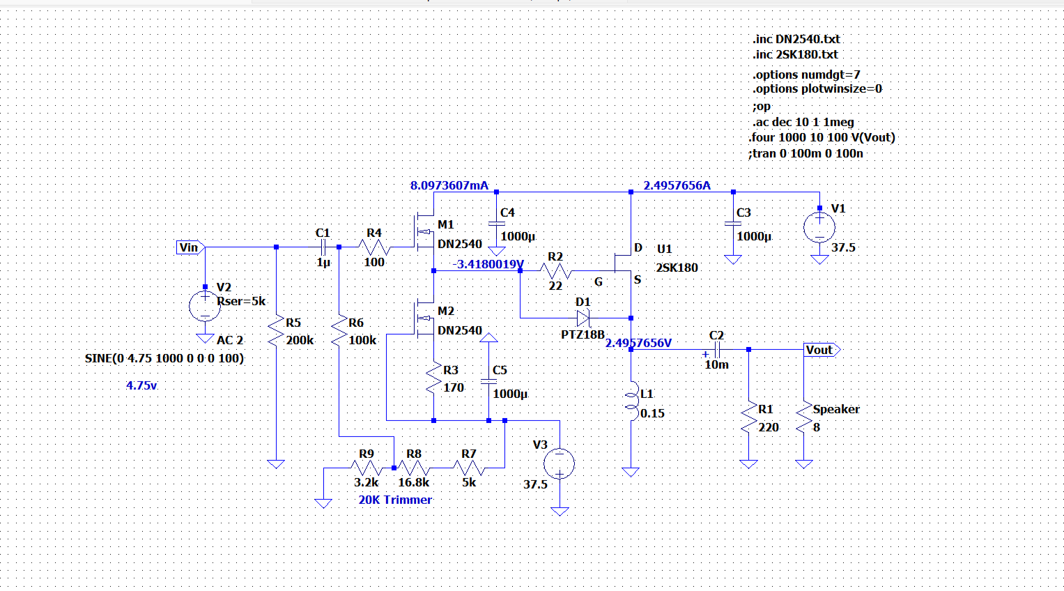

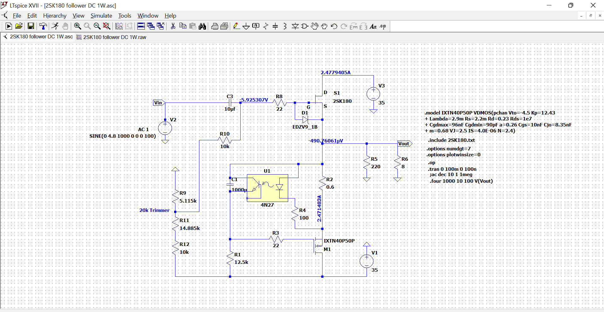

Here is something that I modelled in LTSpice that eliminates the output capacitor. Instead of choke loading, it is CCS loaded with a bipolar power supply.

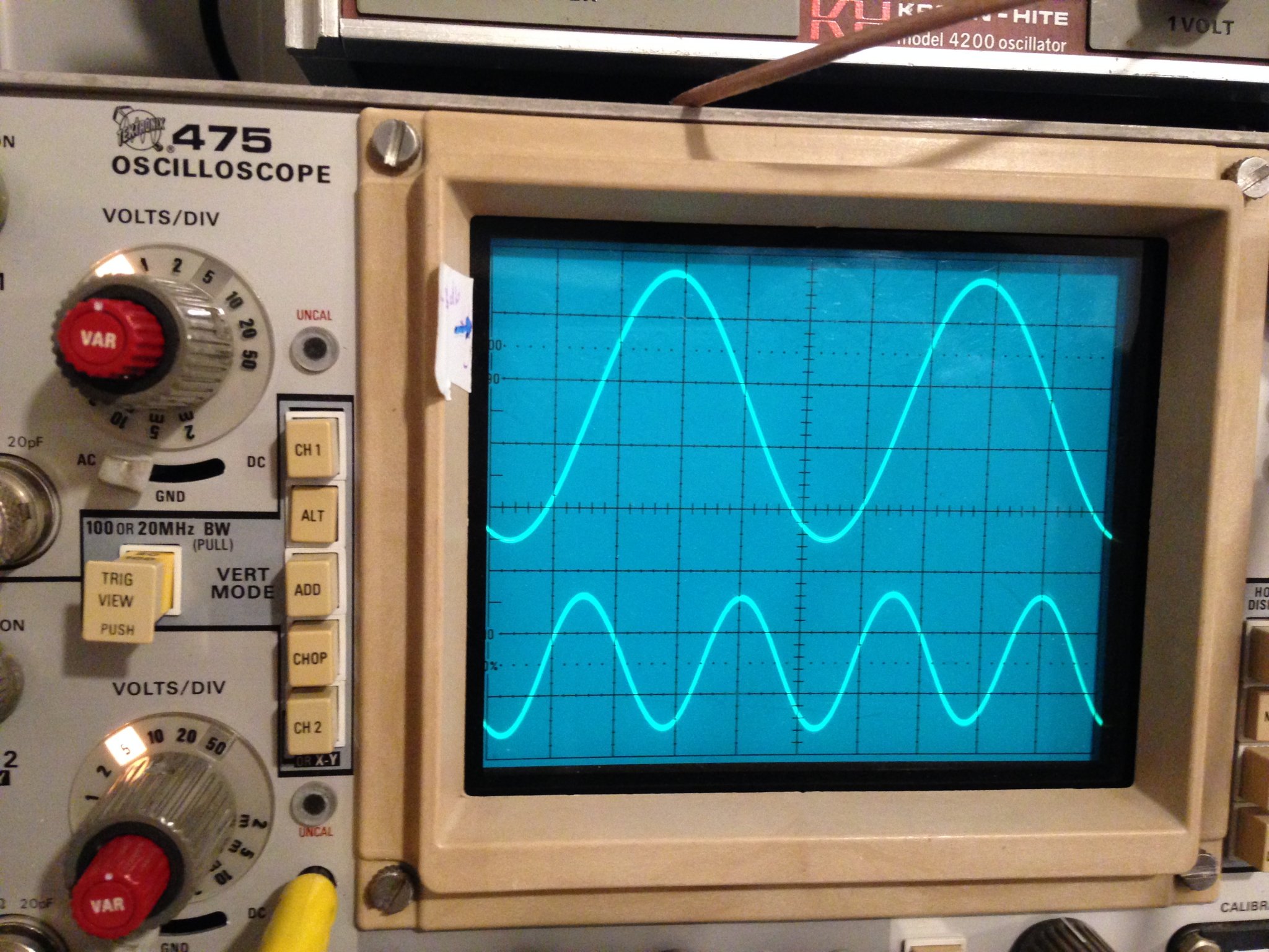

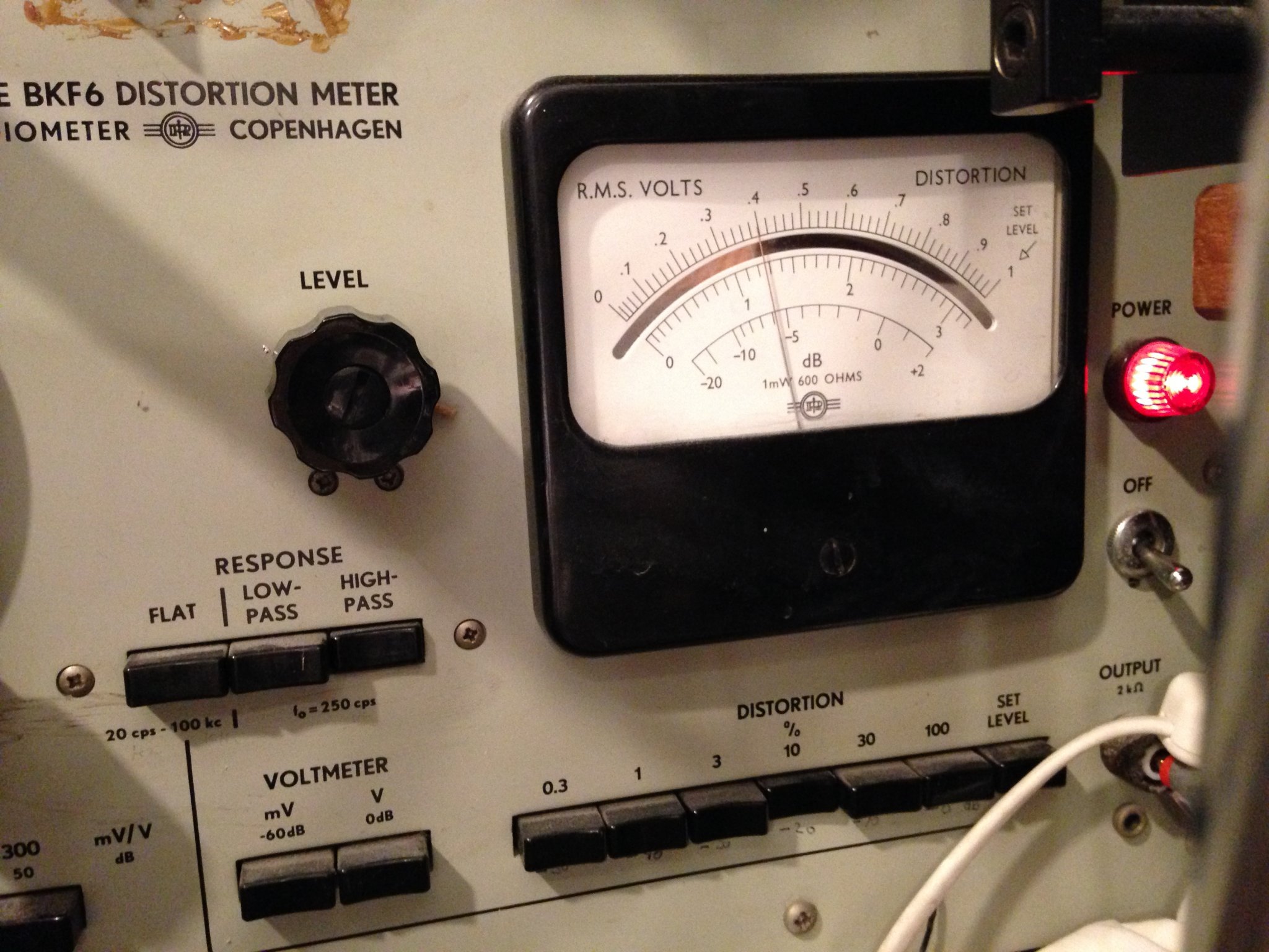

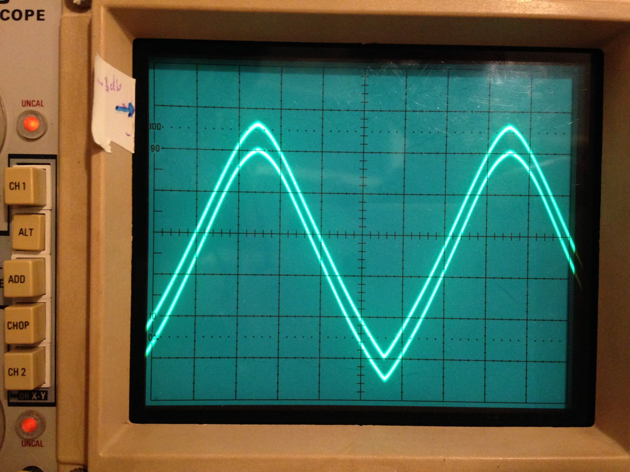

I have rebuilt my Classical Choke Loaded 2SK182 Amp (a champ) to run with a SMPS. It is great. I have a 6Amp common mode choke on the input, 0,1 ohm each winding, and some mhenries.
The drain-loaded circuit "distorts" like hell, but is very stable at that. It is 2nd harmonic, and the distortion is stable at a very wide range of bias.
I tested 7 Volt RMS out at 1.000 Hz and it was 4,6%. Aalso 4,6% at 1,8 Amp bias, 2 amp, 2,5 amps: as I change the operating point it stays the same. That means that the 2SK182 is very stable in the distortion it gives, that the distortion is independent of the actual signal.
At 5 V RMS it is 4%
At 1,5V RMS it is 1,2% which means the First Watt is less than 1%.
And yes, would I have an impedance converter (a transformer that is) then the distortion decreases a lot because it was seen that at 4 ohms the distortion rises (see the sawtooth: the blunt saw is a 4 ohm trace). I have drain loaded, a very heavy-duty choke. Finding a gapped transformer with the high current capacity is very very hard. So I will look for one without DC. So a transformer would be a simple 64/8 ohm transformer 'for transistor' that is, without a gap, that can be used after the output capoacitor (coupling cap). I have to look for one.

Yes, drain loaded common source will have those distortion numbers.
Are you running a fairly low Vds?
I have found that changing Vds changes harmonic distortion. Higher Vds gives higher maximum power output and has lower distortion at a given power output.

Hi Ben,Little steps for me. I understand your Singing Bush arrangement. I need to study your cascoded buffer and follower output.
I did a quick LTSpice model with the Singing Bush type of input bias: View attachment 1025881
What dose the power supply rejection ratio PSRR look like referencing the GND (load across the inductor) vs making the load across the SIT?

Hi Botte,
I don't have numbers but in theory with SITs, connecting their drain to ground is the quietest.
In practice, my 2SK180 follower with the power supply connected to the drain is very quiet. With my ear to my 103dB sensitive speaker I do not hear any noise. I believe that is because of the very quiet CLC power supply and also because of the attention to keeping loop areas very small (attention to wire routing, twisting of wires etc), and keeping AC power away from DC and low level signal.
So by keeping the power supply and power delivery quiet, PSRR becomes much less of a factor.
One noticeable difference between grounding the drain versus grounding the inductor is that the grounded drain seems to have a bit of power-up thump whereas the grounded inductor does not. I have a 2SJ28 inductor loaded follower with the drain grounded and it has a quiet power-up thump. However even with my sensitive speakers it is not loud so it is not objectionable to me.
