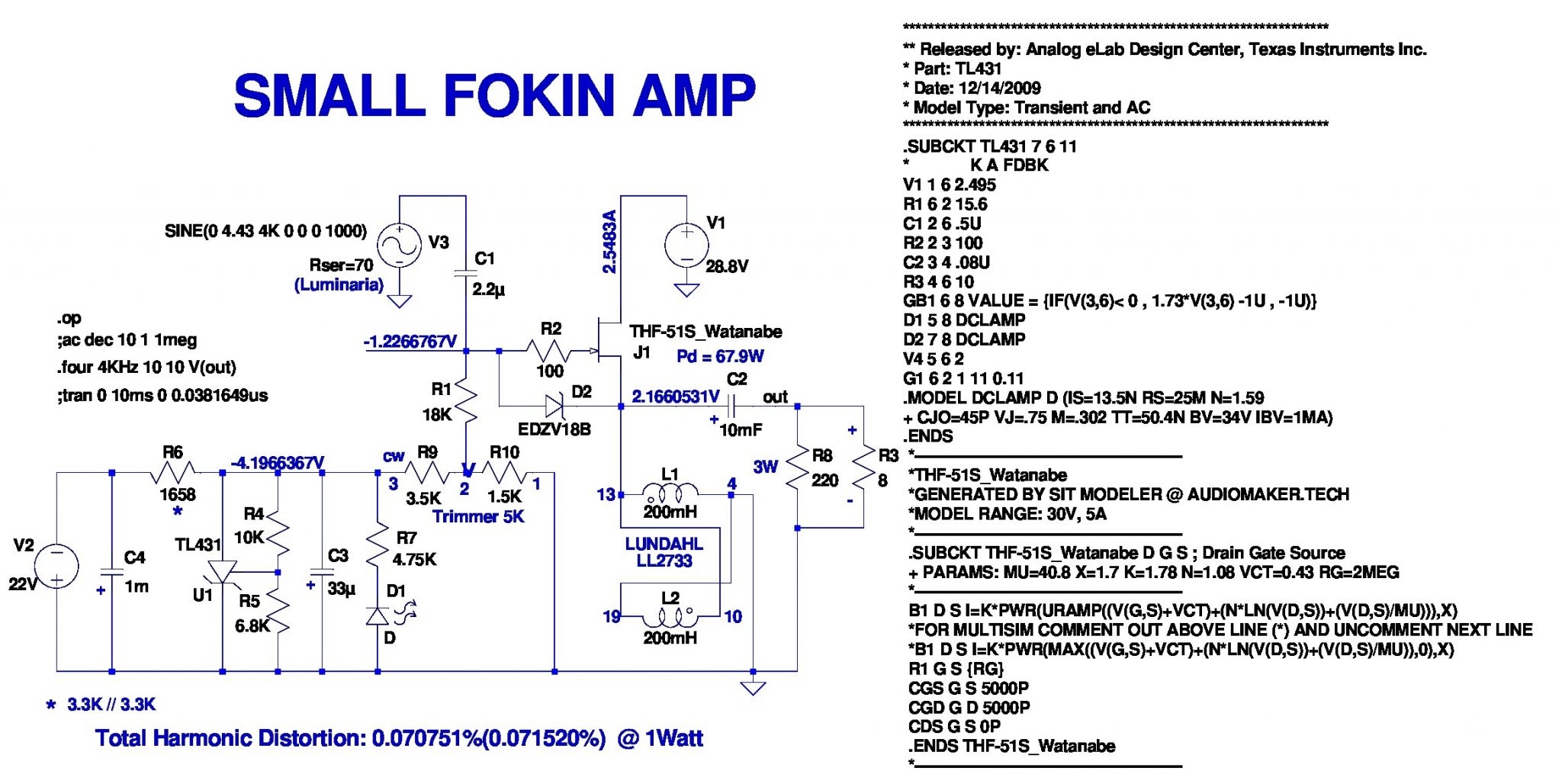

I finished building my little Fokin Amp. For now il's just a channel. This is the circuit diagram. Virtual voltages are comparable to real ones. I used this link to have curves similar to those of my two matched SIT- Watanabe:
https://blog.audiomaker.tech/sit-modeller/

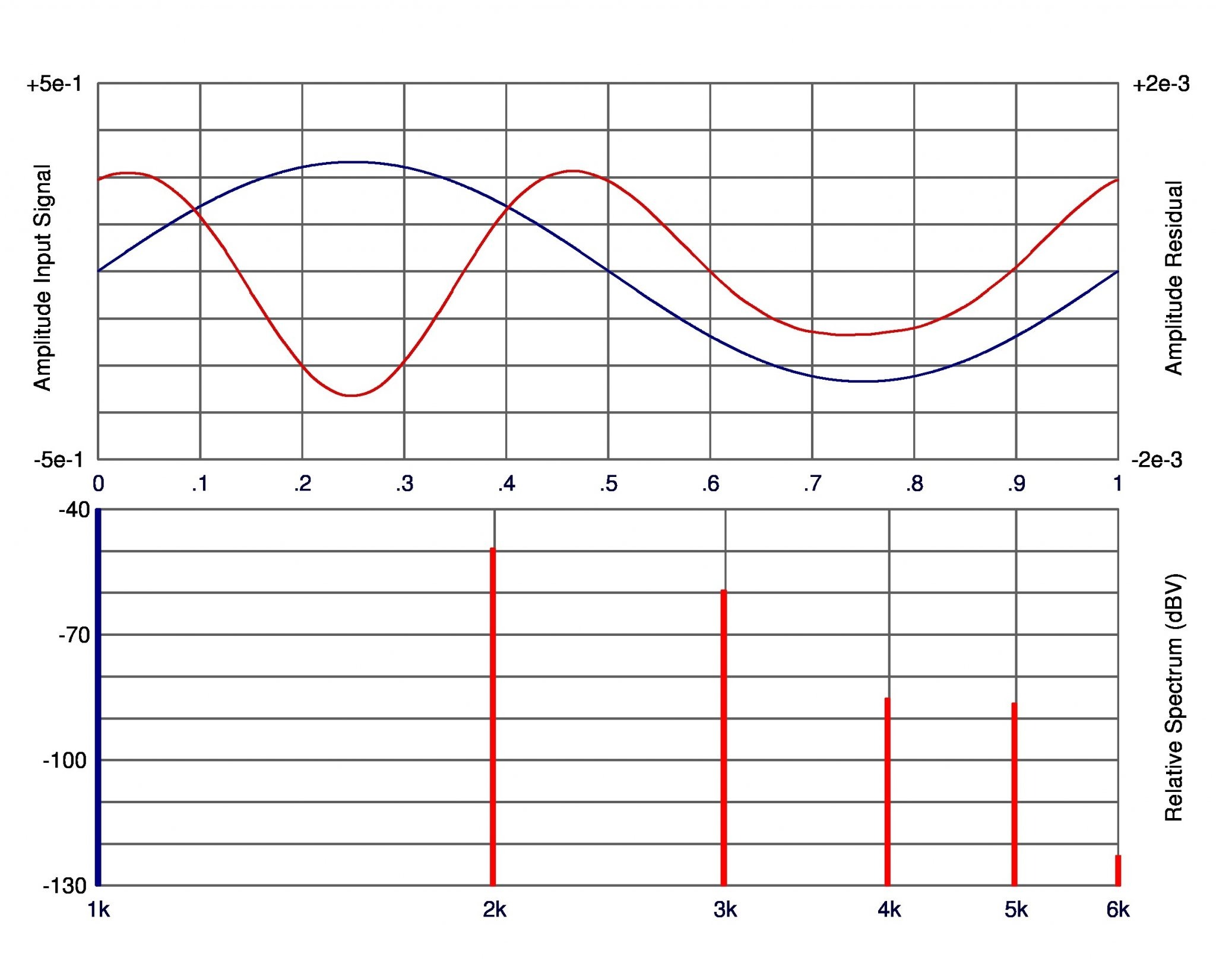

The virtual THD is a little lower than the real one. However, for different output powers, the relationships 2H and 3H are similar to those measured on the amplifier.
The second negative harmonic measured by Diana @ 7.82Vrms on 8R (THD=-49.1dB - S/N=84.6dB). The maximum possible with my measures system.

claudio52, Looks good. I have found that LTSpice simulations generally give lower distortion levels, but simulations are great to play with parts without building physically. So how does it sound?

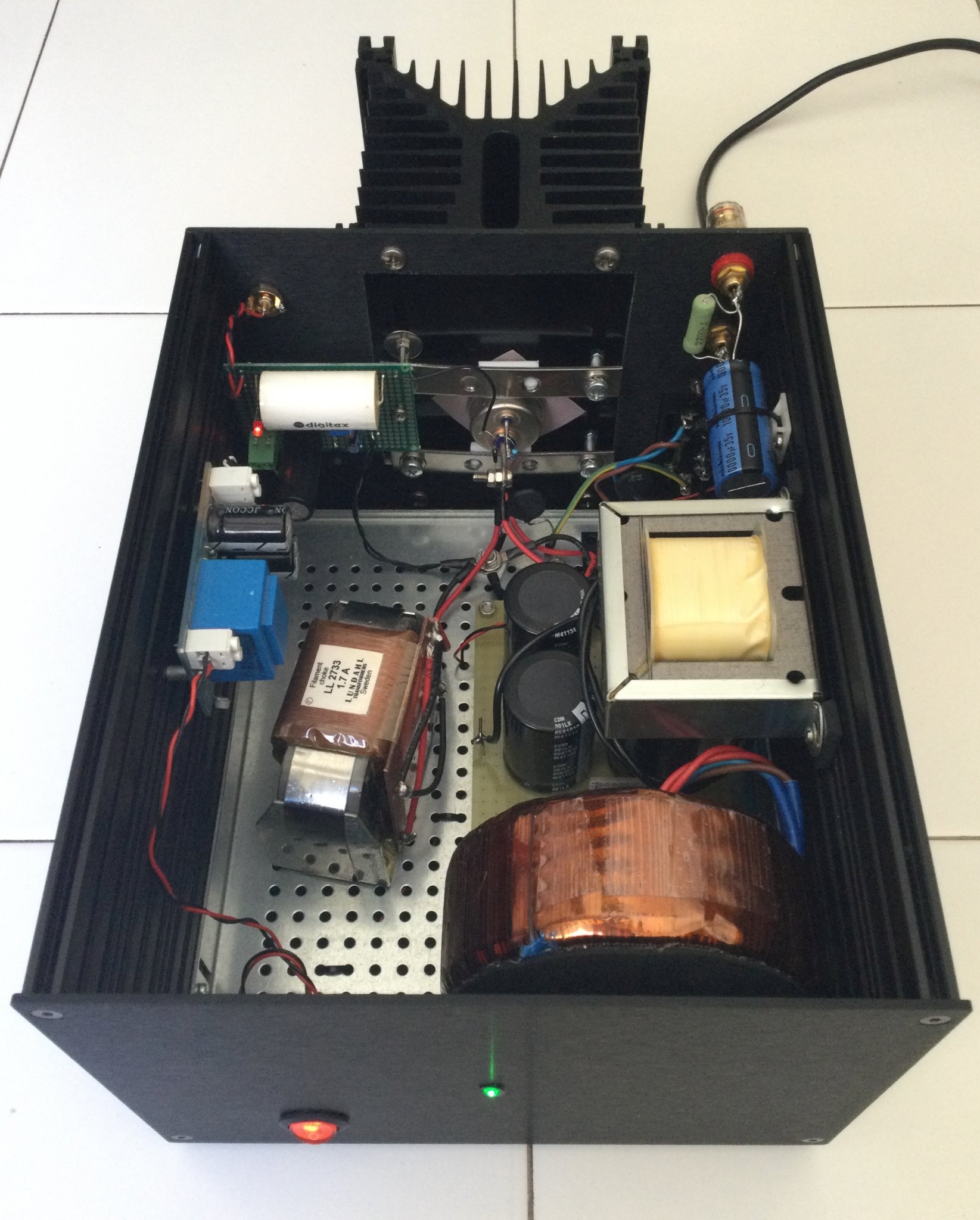

A bit more Fokin progress today, just about finished the wiring of the rear panel;
and installed the Tokin THF-51S SITs
And just to close out the day's work, I've bolted on the second heatsink. Just about on the home straight now!

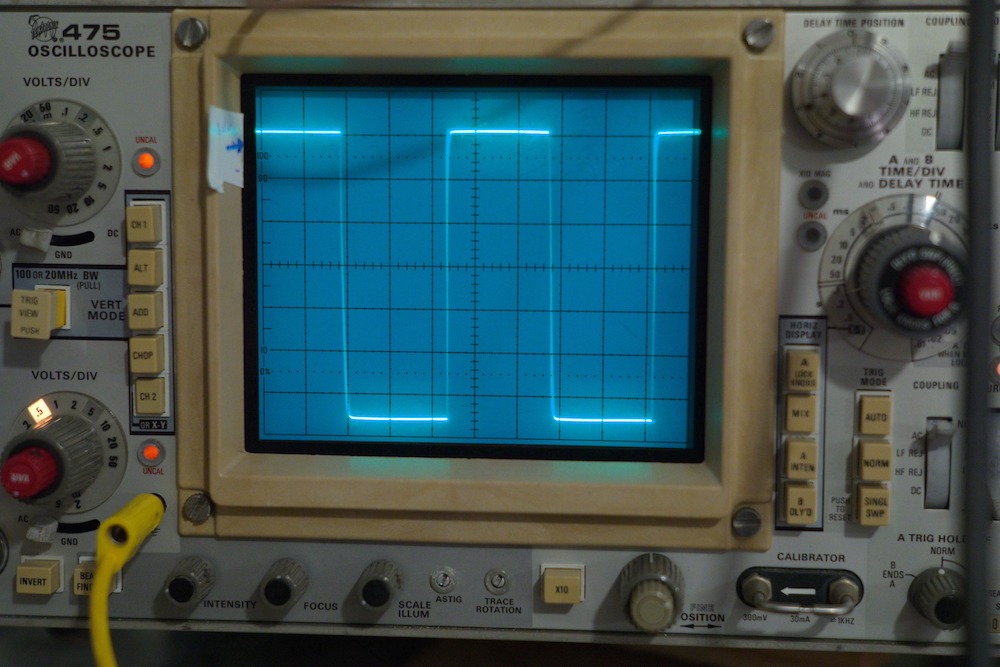

I rewired my 2SK182 choke-loaded build (choke on drain).
Output: 4700 µF//8µF MKT, supply is 30.000µF/2µF MKT, and 0.2 ohms to Meanwell SMPT.
Look Ma, no overshoot . . . 5 kHz/8 ohm. 2 amp. Paralleling this 8 ohm with a 15 ohm speaker 2A9 shows no reduction in dB's . .

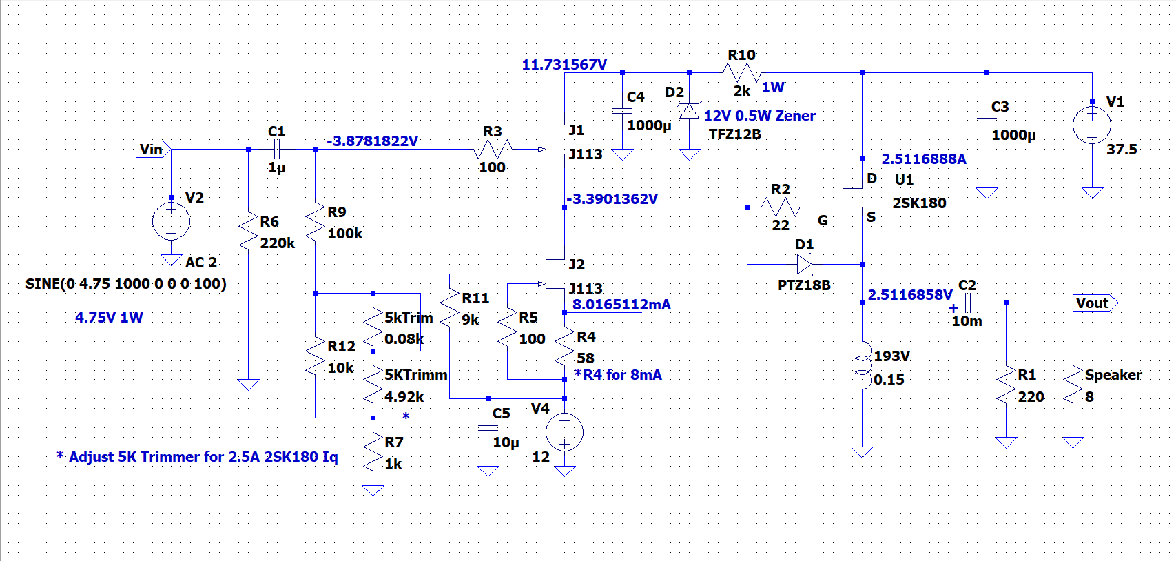

Gate Leakage Current, Instability, and Input Buffer Bias
One of my 2SK180s had high gate leakage current that caused me a lot of grief way back when, which led me to trying common drain (follower). It behaved better with the one Ohm DCR of the choke at the source but it still did not provide enough control. The drain current still crept up as the temperature went up. So I finally gave up on that particular 2SK180 and bought another one to replace it. The new 2SK180 had much lower gate leakage current and was stable at operating temperature.
Fortunately that one 2SK180 was the only SIT that I have that had high enough gate leakage current to cause problems. However, others have encountered this problem too.
Then Zen Mod, the smart guy that he is, came up with a solution to the problem, and it is incorporated into his Singing Bush amplifier circuit. He removed the SIT's gate leak resistor, direct coupled (no coupling capacitor) an input buffer (JFET follower) to the SIT, and moved the SIT bias supply to the buffer gate and biased the input signal. The biased signal carried through the buffer and biased the SIT.
The removal of the gate leak resistor from the SIT eliminated the detrimental effect of the high gate leak current.
So I played around with LTSpice and came up with a bias circuit based on Zen Mod's concept. I tried to keep it as simple as possible, as I like simple. Simple is easier to understand and easier to trouble shoot. The existing -12V bias power supply is re-used, for signal bias and also for buffer V-, and economical and readily available J113 are used for buffering. A simple zener shunt regulates the V+ to 12V for buffer V+.
The added bonus is the input buffer allows for a wide variety of preamps/sources that may have high output impedance.
I have not built this input buffer/bias circuit but it runs in LTSpice. This is the commpn drain (follower) circuit but it can also be implemented for common source.

After posting this I realized that the buffer that I showed is not capable of swinging the voltage that is needed to maximize the output power of the 2SK180. I'll need to change the buffer and buffer V+ and V-. I'm going to try the DN2540 that I used in my 2SK79 preamp.

By the way it should work for the common source amp as the buffer output signal voltage required is much lower since the common source amp has gain. The buffer just doesn't have enough output signal voltage for the follower amp which has no voltage gain.
I tried a quick and dirty single J113 buffer but didn’t like the sound. This looks better and more refined. Let us know how it sounds!
in choke amps I did use JFet(s) with real (flying) cascode (ref. to JFet source) , so fed above from main rail thus no problem with swing
JFets biased with discrete CCS, no need for JFets down
though, you need aux supply of same voltage as main one, to allow negative sine in same amount
see https://www.diyaudio.com/community/...oaded-follower-power-amp.387868/#post-7063202
