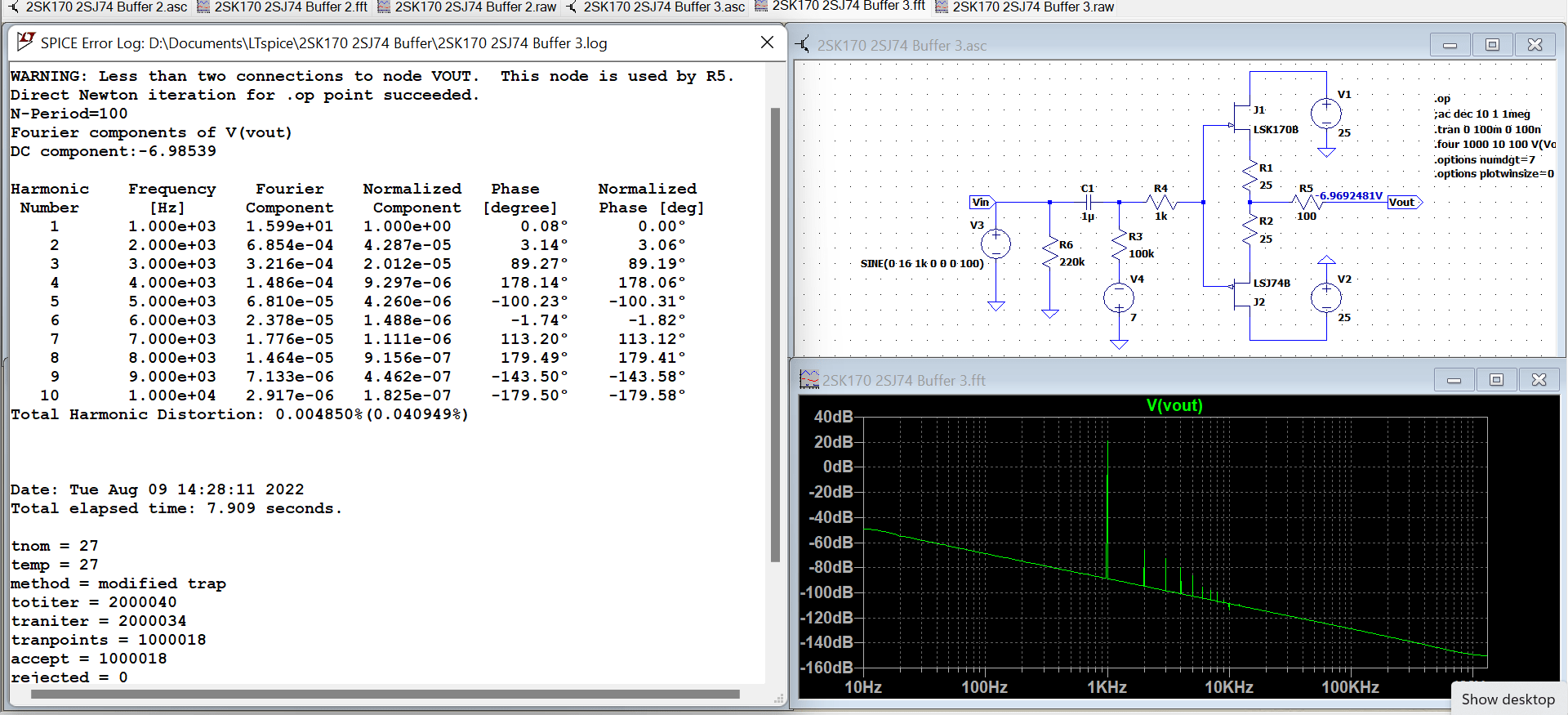

Ben, I have this running since june last year now. (& I have the standard 2SK170/2SJ74 pair of a buffer).
One additional trick: I have the Vb adjustable, and have it such that the Vb+ plus the bias is equal to the Vb-. So: 12V - 3.3 = 3.3 + Vb+; VB+= around 9 volts.
I my implementation with 2SK182 I have Vb- to start off as -25V, my Vbias= -6 or -7 volt, the bottom jFet sees 18 volts; and so my Vb+ is 11 volt so the top again sees 18 volts. I tried it lopsided with straight +/- 25 V but I found (imagined like everything is here) that it introduced some less sounding effects (less warmth).
Hi Al,
Doing a push-pull buffer increases the voltage limits of the signal so that is good for a follower output stage.

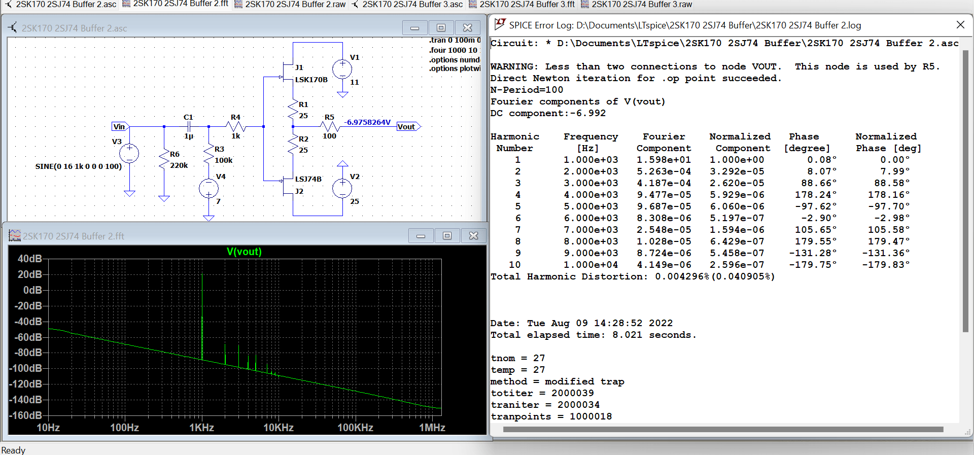

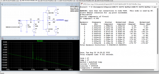

I think I understand what you did. Here is my LTSpice interpretation of the concept of your buffer.
The simulation did show though that the equal V+ and V- to the JFETs (unequal Vds) produced the higher distortion as I would have expected.
But the unbalanced V+ and V- (equal Vds) does equalize the dissipation in the JFETs which is a good thing as the SK170's dissipation would otherwise be quite high.

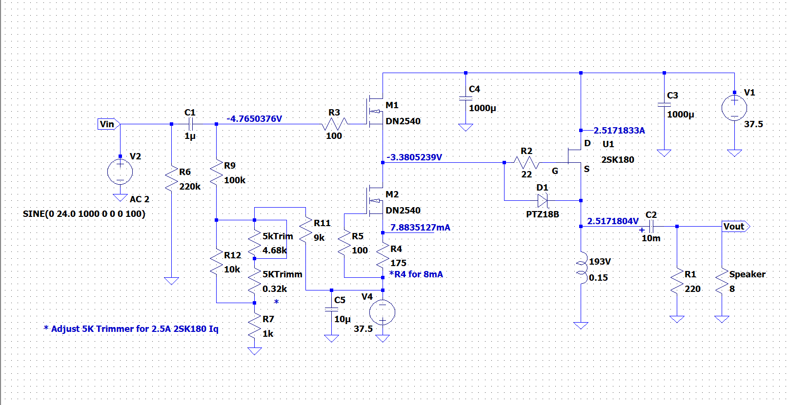

I liked it so much that I converted my choke loaded 2SJ28 single ended amp and my THF-51S Mu Follower amp to common drain follower amps:
My 2SJ28 Choke Loaded Follower
My THF-51S Mu-Follower Follower
It started out common source with the choke on the drain side and the output on the drain side for voltage gain. This is similar to single ended triode tube amplifiers. I enjoyed the sound for a while but I had one problematic 2SK180 that had high gate leakage current. After much messing around trying to tame it, I decided to change the amplifier to common drain and place the choke at the source, and taking the output from the source for follower operation.
Change to source follower: Common Drain - post #109
That helped to control the runaway tendency, and the big win was that I much preferred the sound.
I could have added resistance at the source to further control the gate leakage current but in the end I replaced the problematic 2SK180 with a well behaving one.
But the source follower implementation stayed.

I used a Hammond 193V which is 150mH at 3A because that was specified by Michael Rothacher for the choke loaded VFET L'Amp that I had previously built. It worked out for my 2SK180 amp as the frequency response and distortion levels were good, and there were no issues with the sound.
But I am no expert. Dave is, so you should tell Dave what your plans are for the choke and ask him for his recommendations.
