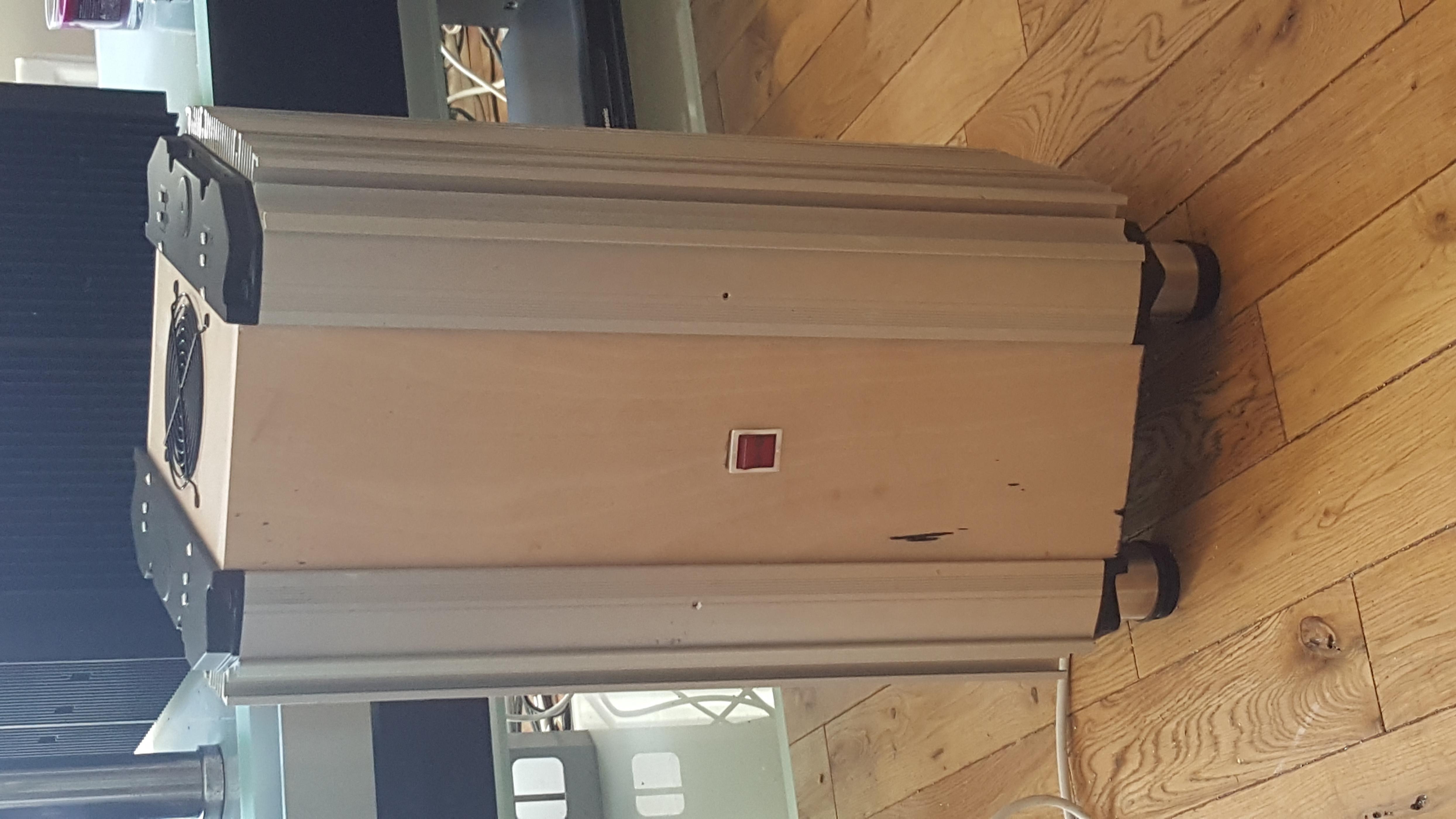

I got lucky yesterday
I went dumpster diving yesterday and found a couple of LED light fittings that had been thrown away. These heatsinks are enormous. I'm going to try these 25W amp modules with them to see if they can keep them cool.

...LED light fittings that ... are enormous
Do you have a washing machine in your living room?
They are moderate large, but such surface demands proper heat transport, often realised by a solid and thick bottom. These are meager however. Cast to fit the appliance I think. Have the heat sources distributed well over the area.
