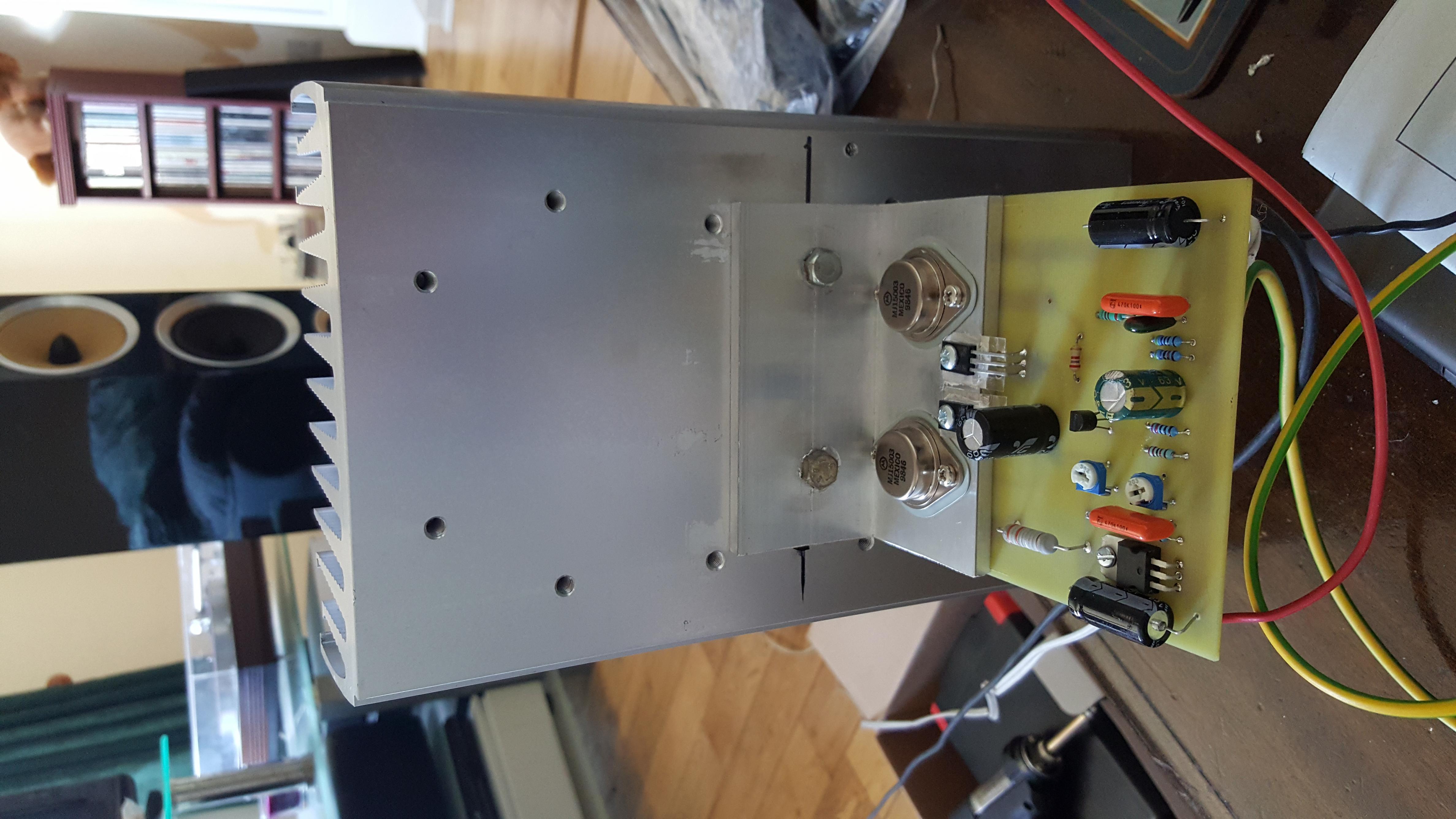

I finally completed the two amplifier modules and put one of them on test.
For such a simple design they do sound very good.
With the monster heatsinks that I have got they still run at about 56C biased at approx. 2.2A.
I've got no detectable hum with 15000uF caps per rail.

Before anyone comments, there were a few mistakes in my PCB design which resulted in two of the resistors residing under the board.
I managed to fit the 2 x 100uF rail decouplers into the original design by drilling an extra hole in one of the tracks.
R10 0R33 is running about 2W, I'm using a 3W component here but it is running hot. It's spaced away from the board to aid heat dissipation.

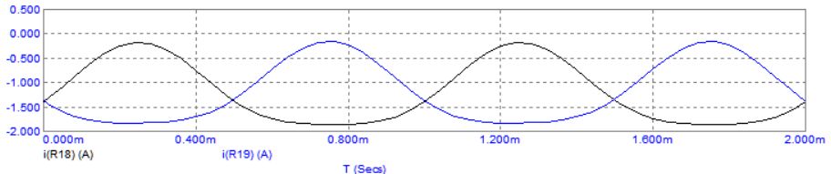

No, not really. The amplifier has to deliver 2.5A peak, but when one O/P transistor is fully on and the other fully off. When they are idling, the current should theoretically only need to be 1.25A.To stay in Class A, Iq must be 2.5A DC
But older transistors as has been mentioned many times (in the JLH thread) have a non-flat gain:current characteristic. At lower currents the gain is higher, so the Iq tends to be more than half the peak output.
JLH and L Nelson Jones discussed this. Nelson Jones missed this point. JLH suspected this I think, but did not quite say so. He erred on higher Iq than theoretical, correctly.
As a guess I would suggest the Iq only needs to be 1.5A to maintain low distortion.
I had them running at 2.2A and they did sound good, they did get rather hot though. My Aleph 4 runs at 4A and doesn't get quite as hot.No, not really. The amplifier has to deliver 2.5A peak, but when one O/P transistor is fully on and the other fully off. When they are idling, the current should theoretically only need to be 1.25A.

Not really. This is a single ended class A design - not push pull. The upper transistors form a constant current source and have to run at > 2.5 A to support full output power. Your 1.25A Iq is valid for a push-pull design where both sides can go up or down. That's the reason why single ended class A designs have such a lousy efficiency (125W DC power in, max 25W output)No, not really. The amplifier has to deliver 2.5A peak, but when one O/P transistor is fully on and the other fully off. When they are idling, the current should theoretically only need to be 1.25A.

John Ellis is quite right, the amp is designed non-switching, therefore it is designed so that neither output transistor ever switches off.Not really. This is a single ended class A design - not push pull. The upper transistors form a constant current source and have to run at > 2.5 A to support full output power. Your 1.25A Iq is valid for a push-pull design where both sides can go up or down. That's the reason why single ended class A designs have such a lousy efficiency (125W DC power in, max 25W output)
And from what I have learned, it seems that with more linear outputs (hfe vs current), the current waveform is more sinusoidal indicating better current sharing, and distortion is lower.

For long term reliability I do think that doubling up the output transistors would help getting the heat into the heatsink. The MJ15003s are within their SOAR and are only operating at 50C but that is HOT to the touch.
