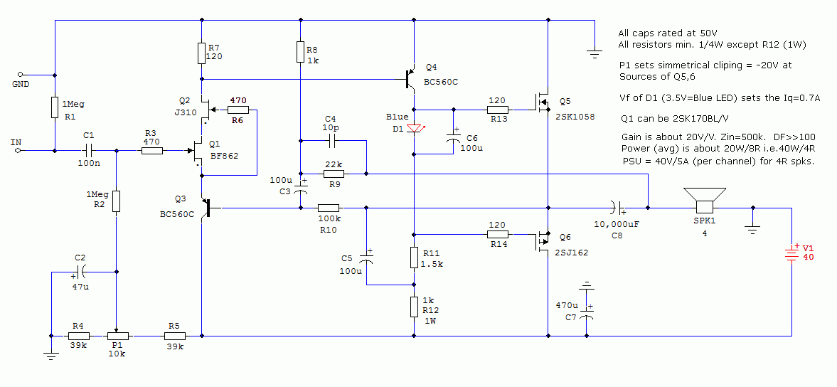

I've just built this amp and it's just amazing! I have used the Exicon Lateral Mosfets ECX10N20 and ECX10P20 for the outputs, everything else were respected from the schematic. Many thanks for sharing your projects with us!

Hi Phil,
please tell how much gain do you need ?
The amp already has 20 dB (10 V/V). For 6 dB more, just change R2 to 470R and you'll have 26 dB (20 V/V) which should be enough for most sources and just the 10k-25k pot at the input will suffice - amp's input impedance is high enough.
Many thanks for the reply and advice! I'll try the gain modification, I think will be enough for me.
Kind regards and ''Happy Christmas!" to you and everybody on this Forum!
...And one advice for everybody: - Go build this amp, you will be more than pleased!

Hi Phil, what changes need to be made when using those Exicon mosfet? Thanks.

Phil has already informed that everything else is as per schematic.
Exicons are more or less equivalent to renesas parts albeit with 200V rating compared to the 160V for renesas parts.
Replacement for 2SK1058/2SJ162 which are not available any longer.

Thanks, Prasi, for answering before me! I've just put the Exicons on the boards without any other changes and sound great!
The only change I did was to replace the R2-1K with 475R because I wanted more gain and didn't want a Pre before the Amp. That's all.
Phil
I highly reccomend this amplifier.....I am using just under 400mA as Iq and sound is superb!
After more than 5 years of living with this wonderfull amplifier, I have tried to make a small change in the circuit...
The idea was to change the feedback into two seperate loops, one DC and one AC, but keeping the gain as standard...
C10/C17 was exchanged with R2, so R2 now is connected to ground. R2 is changed from 1k to 470R (halfed).
Then a AC-second loop is made with a 10k resistor from output terminal to junction between C10/C17 and R2.
My simulations of the change, shows better bandwith and higher PSRR, but I don't know how reliable this is....but including the output capacitor in the loop makes the sound change to my liking...
Hi Skorpio,
I tested your 2-loops idea and it brings some improvement indeed :up:
I also changed the input device into N-JFET which made some other changes necessary and the whole thing now looks like this (and sounds somewhat better) 🙂
Please don't ask me about parts substitutes, power increase or to compare it with other amps/designs....
