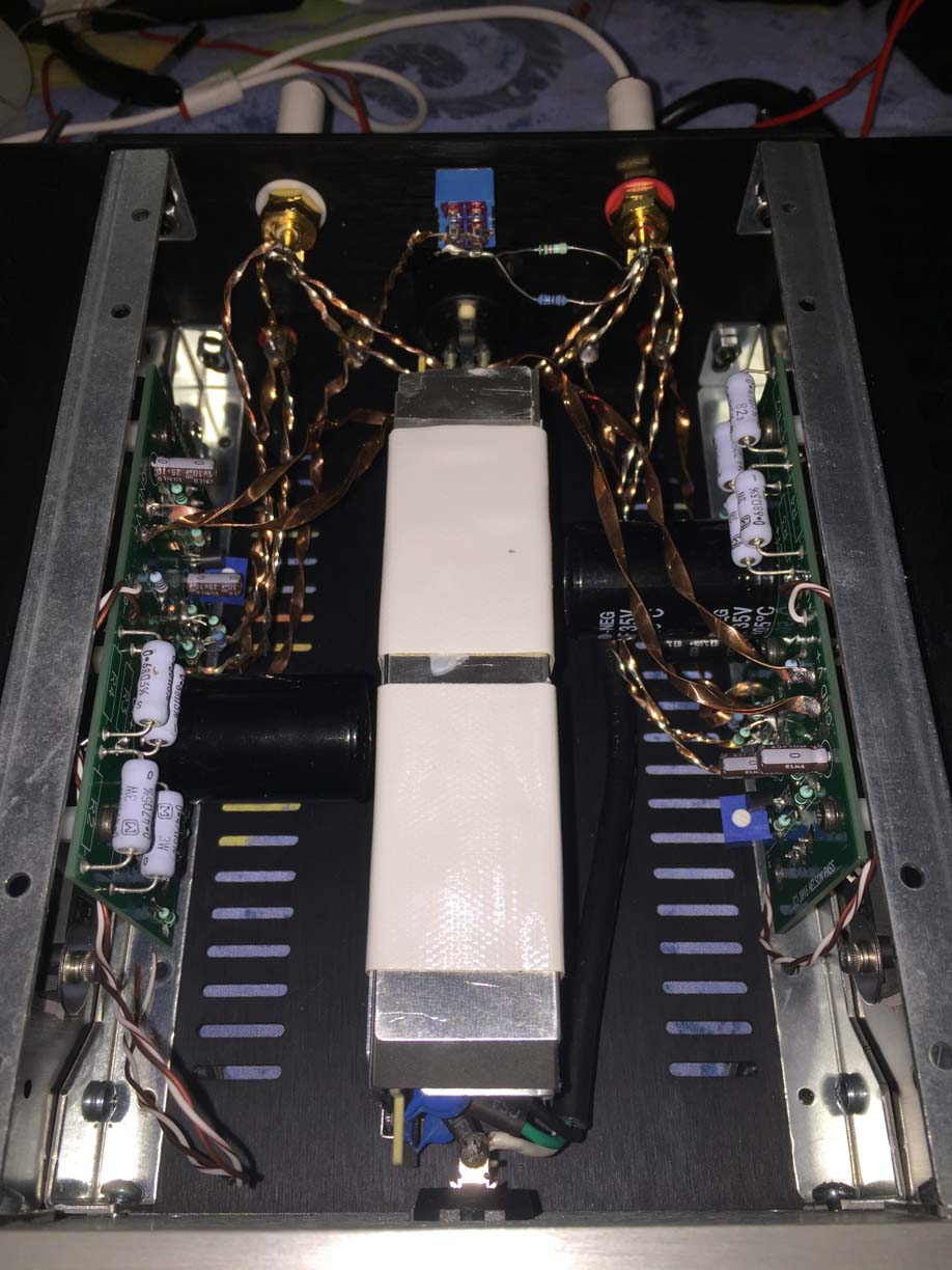

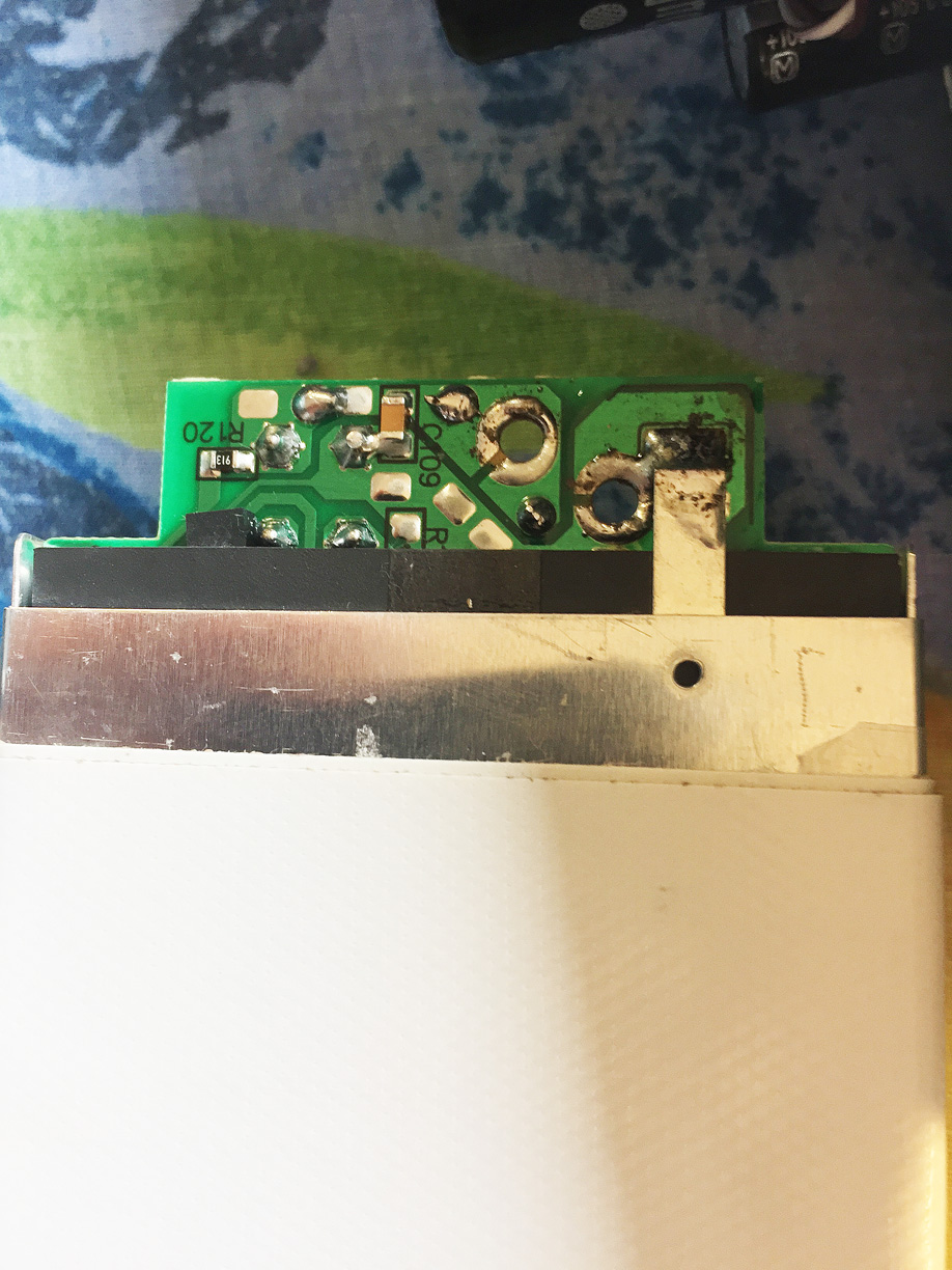

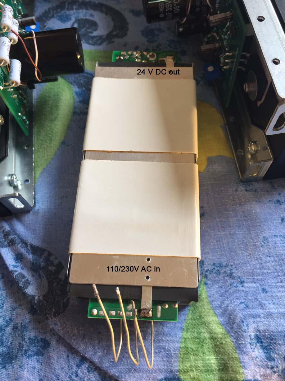

They are great. The only reason why they are not used more widely is the old-fashioned mindset that is so hard to change. But, they do sound great.
I have attached a few photos. You'll see that the metal shield is used as a connection (connector) between the mains supply earth, and the DC negative rail (DC return rail). This connection can be "lifted" at either end. So, for example, one could use two SMPS and make + and - 24V DC "symmetrical" supply.
I tested the ACA Meanwell; it had a sag of 100mV only, at 4A continuous draw, with minimal noise - exceptional.
The fan noise could be a problem; the ACA SMPS does not have it.
But to answer your question, yes you can use the SMPS if you can disconnect the mains ground connection from a DC supply return. Then DC + is a common, DC - is.... well it is minus and you can connect it wherever you want.
