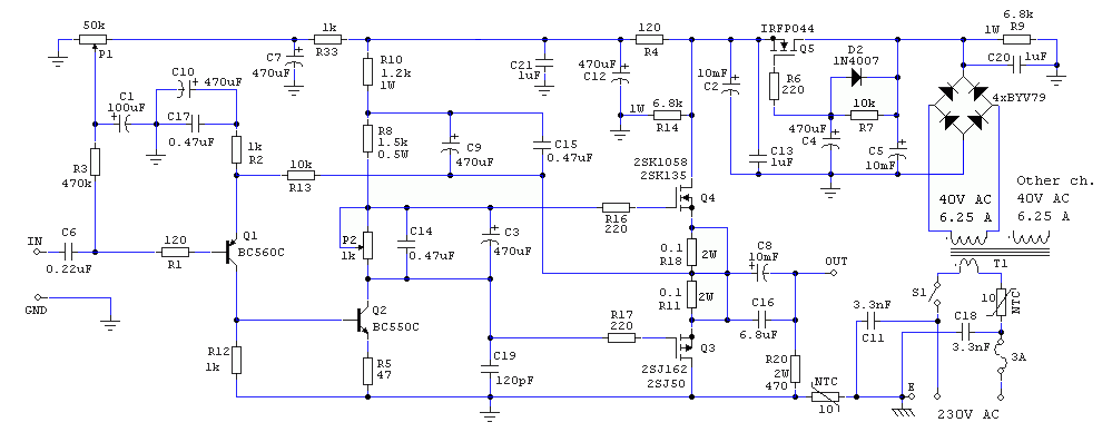

p.s. Little note: gate stopper resistors should be as near to the gate as possible.
In Your version - these are as far as possible 🙁
Also low power signal "GND" shares same trace as power "GND", this practice should be avoided. It should go with separate traces to star gnd poi1nt.
I agree. This PCB was designed some year ago, and in speed. Though, I made amp with that PCBs and.. In a very serious system, with serious source, serious speakers and sound absorbers and diffusers - this amp shined like a true star... So I decided not to make new modified PCBs 😀
Also low power signal "GND" shares same trace as power "GND", this practice should be avoided. It should go with separate traces to star gnd point.
This is actually better implemented than most amplifiers here 🙂 It is hard to achieve good result without understanding the issues and how to avoid them. Many people just follow the "golden rules of thumb" and still the result is not good. As an example, sometimes "star grounding" is used only to make things worse.

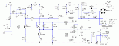

This is a nice amp design, Juma. I had a hard time finding the schematic though as the images on the first post don't work. on the .RS website, the schematic appears as a small icon and enlarges if clicked. Would be good to have this directly linked as a image on post 1 without clicking on two links.
Not any more (post #1 has it too now) :... hard time finding the schematic...
R10+R8 are the current feed into Q2.
But Q2 collector voltage varies with signal.
The result is that the varying collector voltage changes the current coming from the supply rail.
Using C9 fed from the output, the top of R8 tracks the output voltage. This gives a nearer constant voltage across R8 and results in near constant current for Q2.
Hi Juma, I don't know if it's only my browser, I can't see the pictures in your original post. 🙁
They are linked from another forum, the place where I published it first, but the links are mucked up in the meantime. Original thread:Hi Juma, I don't know if it's only my browser, I can't see the pictures in your original post. 🙁
