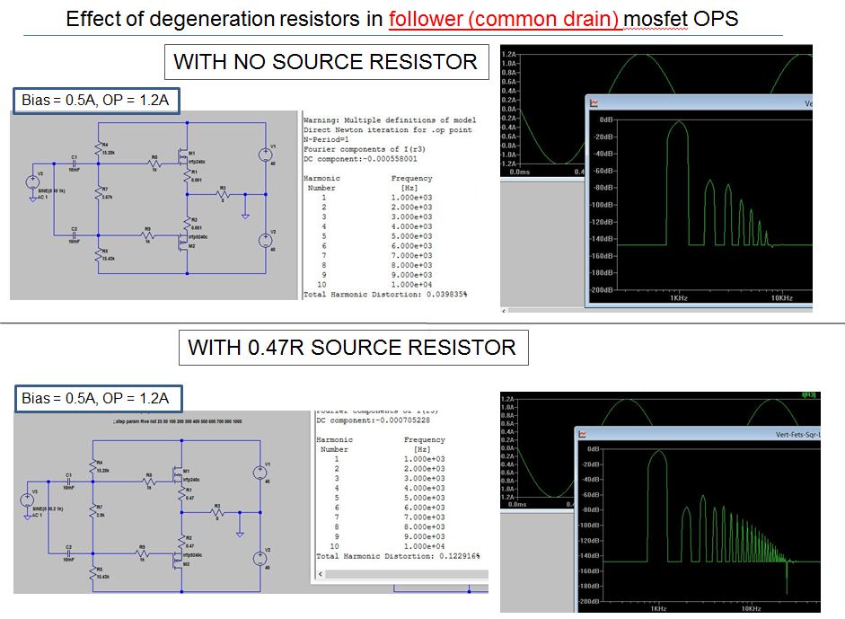

Sorry, but my scope (and the sim for that matter) shows the same thing as Mr. Pass' paper does. Also, check the post #41 of this thread.
So, there is a clear class A extended region in the common Drain (Source follower) mode:
as promised i did some work on this and contrary to my previous post - you are correct, we do see the effect in follower stages. Apologies for any confusion that I may have caused 😱
As penance for my mistake, i present the comparisons below - that should (hopefully) go some way in convincing Andrew. Note that the op stages are all operated deliberately outside the 2*Iq rule to show that that this effect is due to a larger class A region.....
