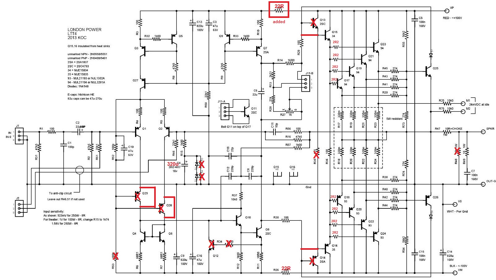

Terry, is it possible to show on circuit diagram, the exact circuit uou have after your mods,
Maybe print out original circuit, and edit it with pen and "white-out". Then take photo of edited circuit, and repost here.

I am attaching a marked up schematic. I used 2N5551/5401 for the small ones, MJE340/350 for the VAS, MJE15034/35 for the drivers and MJL21193/94 for the outputs.
Is c10 and r52 still in circuit?? Also noticed its current mirrow design in the long tail input stage plus cc stage at the top of input pairs.. Also look in the the vas stage a little more.. Read up on g randy slones design book he talks about such rethinking of these stages.
Regards A.
Regards A.
Would it matter if the drivers mismatched considerably? Those can.. . .MJE15034/35 for the drivers. . .
Maybe 2SC4793/2SA1837 or 2SC5171/2SA1930 could fix it?
Just a guess.

Hi AndrewT
Removing D2 and D4 greatly reduced the offset. Offset at one point was 3.5V. You questions have caused me to go back through the thread and read through all the hassle we went through trying to get this amp to work. I had hoped that the little bit of gained understanding I have acquired would help me but I see that we are really just rehashing the same territory we covered back then. I'm afraid without Struth's involvement we may never get to the bottom of what he had envisioned. PCB's are cheap to have made these days. Wasting valuable parts trying to get these working is looking a more and more like a big waste of time and effort. I agree with Jason, Kevin should have pulled the design from his website until he was able to get it working.

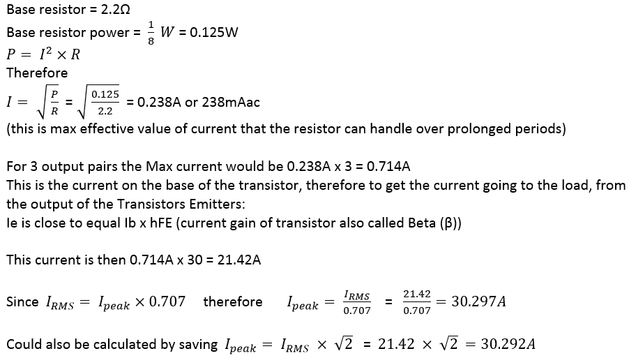

do the sums.
Imax = sqrt(P/R) = 238mAac
That is the maximum continuous base current into each output device.
Peak base current capability will be higher (*sqrt(2)) and much higher for fast transients.
Maximum output current ~ 238mAac * Number of devices * output device hFE
I'd guess for a 3pair output stage, you can easily get in excess of 30Apk to your load on long duration transients.
Probably nearer 50Apk on fast transients.
No idea what you just said. Is the correct wattage of the base stoppers hidden in there somewhere?

just noticed that the Output Zobel is located after the R||L.
That means the output Zobel is physically located further away from the output stage. That increases the impedance and reduces the effectiveness of the Output Zobel.
The high frequencies that the Output Zobel is providing a load for is now 10r + 10r + 100nF, i.e. 20r+100nF
That is quite high and combined with the added inductance as above may not be stabilising the amp correctly.
ADD a second Zobel right at the output devices and connect to the nearest Power Ground connection using the shortest possible lead lengths. 5mm (1/5") max is a good guide for short, 2mm (1/12") is better.

as statewd earlier base stoppers can easily pass normal working currents.My Slewmaster uses 1/2 watt 4R7 base stoppers without issue. Where is the need for such large resistors in this amp? Spice shows 333uW across those 2R2 resistors.
If you were to short the output while a large signal was applied the Outputs will draw very high base currents. High dissipation base stoppers could survive this abuse.
Low dissipation base stoppers may act as fuses, maybe, but are they too slow to protect the output devices?

If you don't understand a particular sentence, or phrase, or acronym, then just ask...............I didn't understand a single thing that AndrewT wrote or how to apply it to this need.
If you really mean that you don't understand a single thing then tell me what that "single thing" is and I'll try again to explain differently.
The resistors are rated in watts. Your explanation was all about mAvac. I have no clue what you were suggesting with that.
These 1/8W resistors were simply cut in as an experiment to see if they would solve the oscillation. They were what I had on hand. They were never intended to remain nor even play music, just to try and find a way to stabilize the circuit. If they worked I would replace them with larger ones. So far, they don't seem to have had an affect.

Attached is the longer version of Andrews calculation, maybe its easier to read this way.
