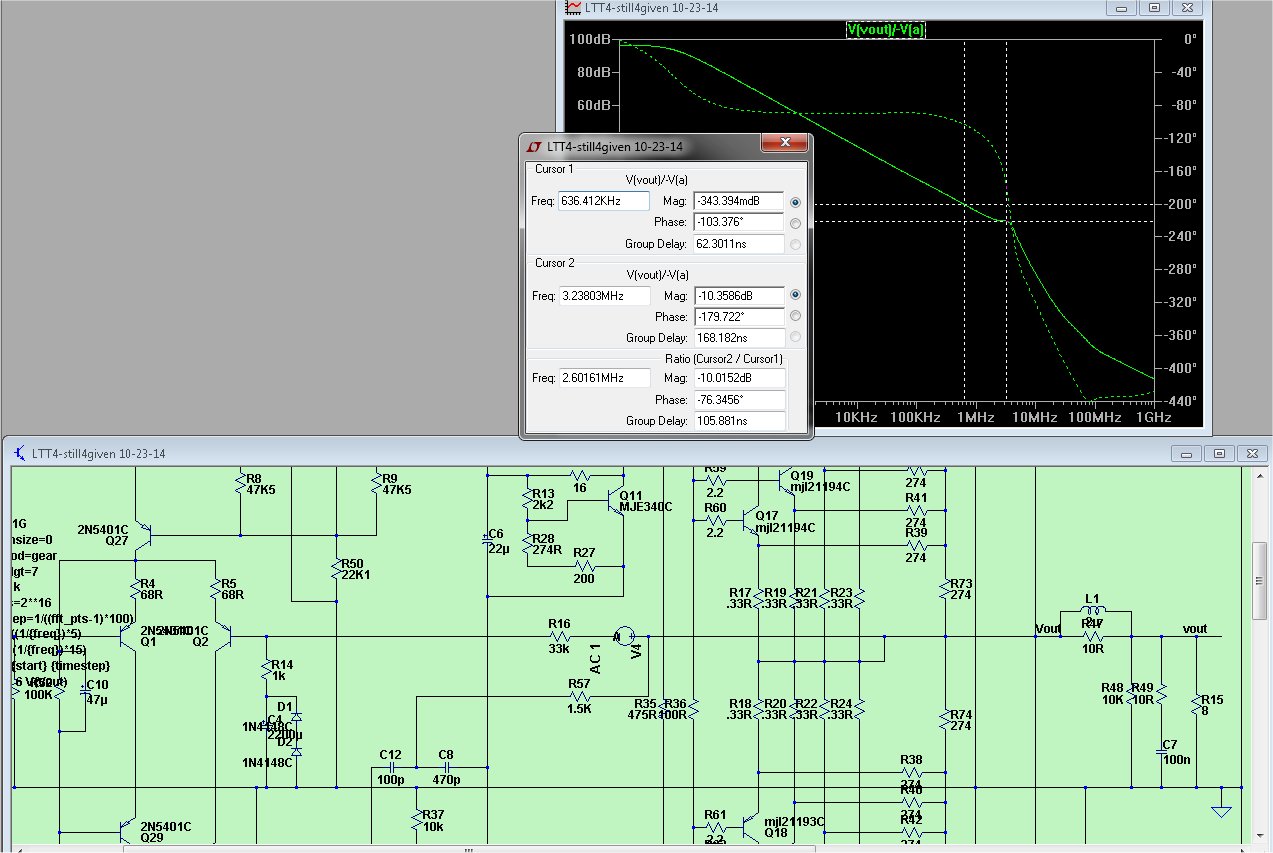

Your .asc was good.

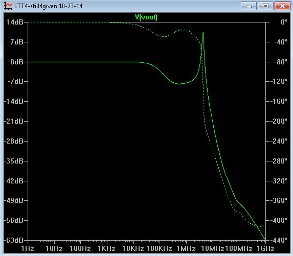

First look at the "peaking" at output in the bode plot (below 1).
This is a unstable amp.
Next , we find out why ??? (below 2 ) The design has MIC comp , lead comp.
and TMC all at the same time. 3.3mhz peak (oscillation ?)

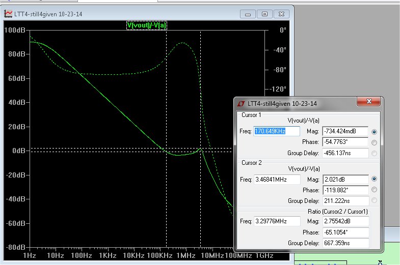

Ahhh , lets fix it !
Eliminate MIC/lead , 470p-100p /1.5 K "badger" TMC = (below 3)
76 degree margin / 636khz unity gain = close to the "badger" (stable).
This amp should now rock !
All those extra caps so it could oscillate ??? 🙄
PS - I changed gain to 33X (more reasonable)...
OS

R4 / R5 = 68R , this increases unity gain point to 636K and closed loop gain
to almost 100db (lower THD20K).
edit - and C12/ c8 in a 1:4.7 ratio (100p/470p) - this could also be 68p/390p or 47p/270P (higher UG). these reduced values might require
R4/5 to be 100R for stability. optimum would be 68P/390P with R4/5 at 82R. 10ppm THD20K would be achieved (close to the wolverine).

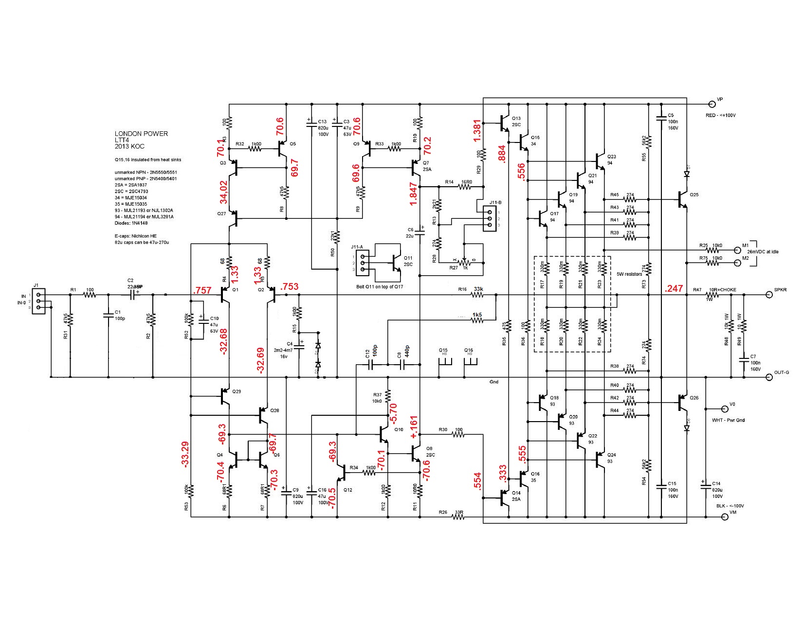

OK I got the chance to make the changes. The closest I could get for the caps was 100p/480p. I installed the 68R for R4/R5. R16=33K, R57=1K5
Offset went up to 240mV. Oscillation is way better but set with the bias pot at 1K it will actually play music but I can see oscillation on the signal. If I play a sine wave I see oscillation at about 1.2Vac output. The - side of the VAS is not turning on all the way. I'm attaching a schematic with the voltages I am getting. Now if I turn the bias pot to raise the bias as soon as the bias starts to rise, it starts oscillating and the bias shoots up hard. Getting closer, just not quite there. Waiting for some more suggestions.

I was playing with your simulation file and was getting all kinds of fuzz on the display when measuring current between the diodes and Q25 and 26 with the input shorted. That's why I'm curious if they are just for protection. I'm wondering if that fuzz oscillation in the simulation?
Your last file runs terrible for me until I remove the diodes at the emitters of those transistors.
I'll try lifting them and see what happens.
I need to learn how to do more than just run a sine wave through Ltspice.

It would be nice if it was something as simple as overactive protection.
You likely know more about LTSpice than I do. Jason told me to short the input cap or bad distortion readings happen.
I'm still learning simulation tricks. I can finally get that nice flat 'floor' on the FFT graph. I played with the simulation of this one some time ago and was never really satisfied with it. I will have to fire it up again sometime soon and see what else catches the eye, keeping OS's suggestions in mind too.
Terry, you are using the lower ft MJL2119x devices on this one if I'm remembering correctly. Seems to me triples in general work better with faster devices.
As for protection, I tried the simulation with all protection related components removed and it wasn't any better. Sketchy at best. I'm not thinking the protection is likely at fault, but almost anything is worth investigating.
