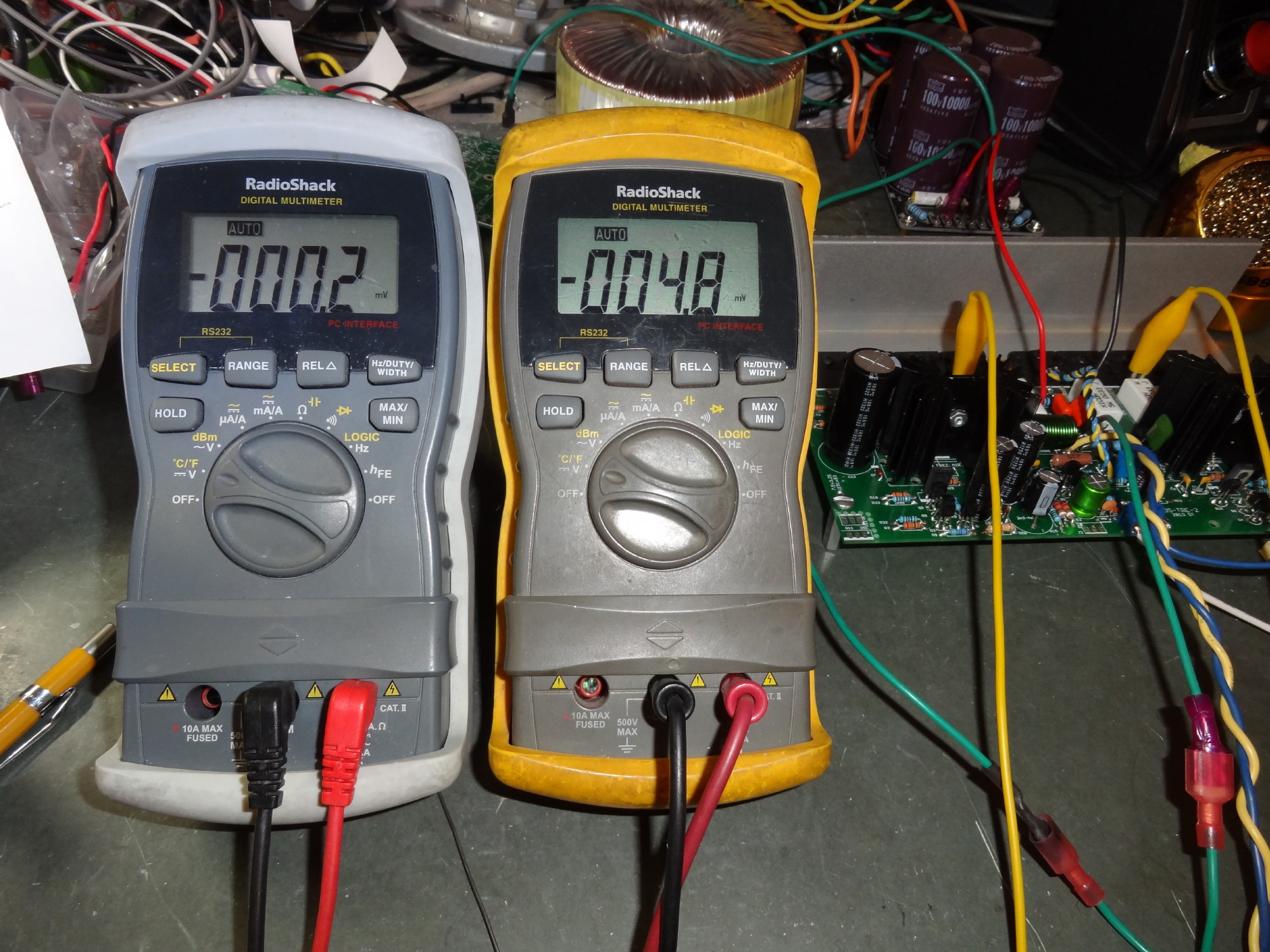

Hi AndrewT
Removing D2 and D4 greatly reduced the offset. Offset at one point was 3.5V. You questions have caused me to go back through the thread and read through all the hassle we went through trying to get this amp to work. I had hoped that the little bit of gained understanding I have acquired would help me but I see that we are really just rehashing the same territory we covered back then. I'm afraid without Struth's involvement we may never get to the bottom of what he had envisioned. PCB's are cheap to have made these days. Wasting valuable parts trying to get these working is looking a more and more like a big waste of time and effort. I agree with Jason, Kevin should have pulled the design from his website until he was able to get it working.
Ranchu said he was finally able to get a working model but was uninspired with the sound and the boards were so butchered by then that he wouldn't use them. I guess enough time had passed that I had forgotten just how hard we had tried to get this amp working. Sorry I drug all of you through it again.
Blessings, Terry
Blessings, Terry

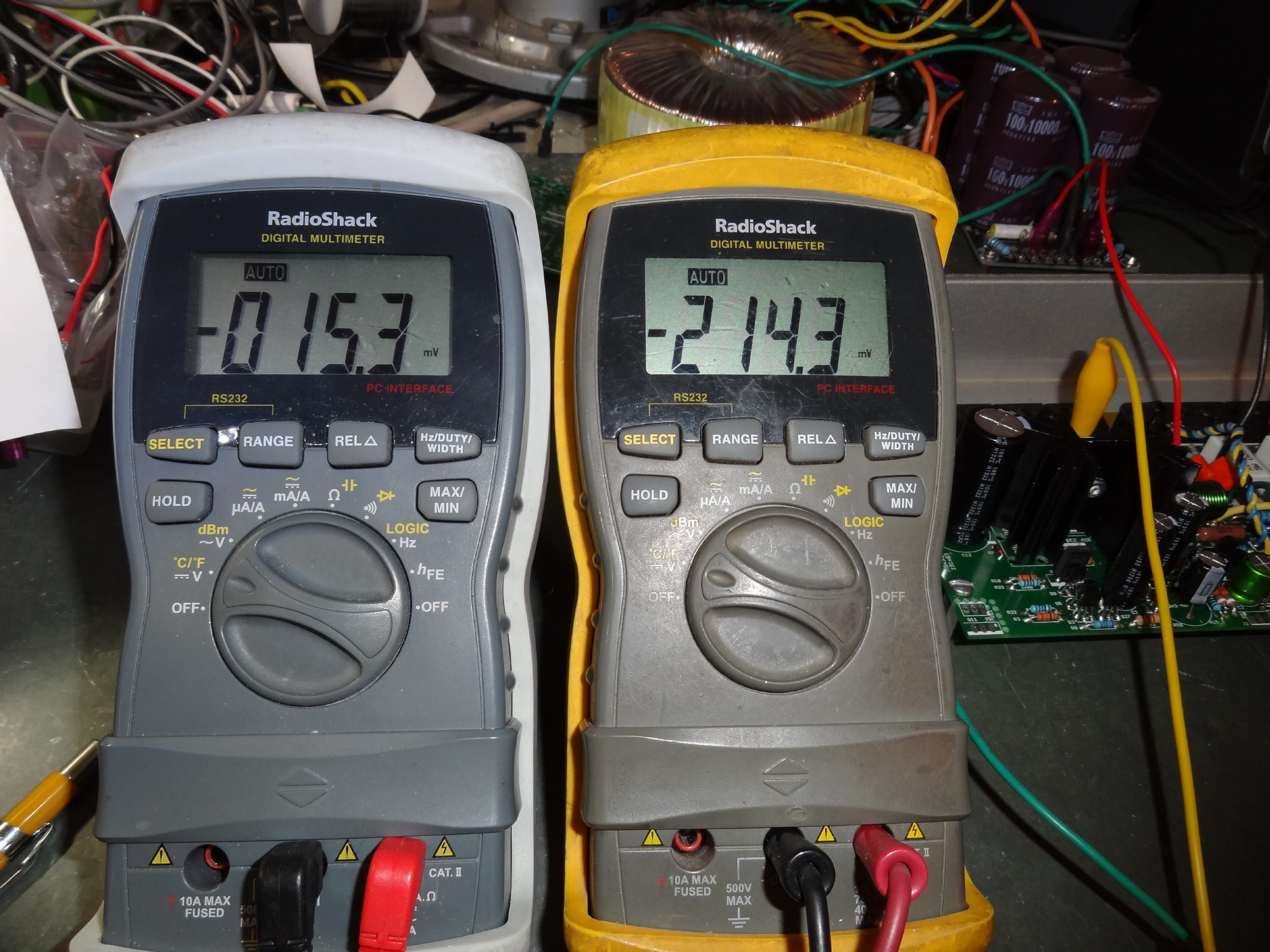

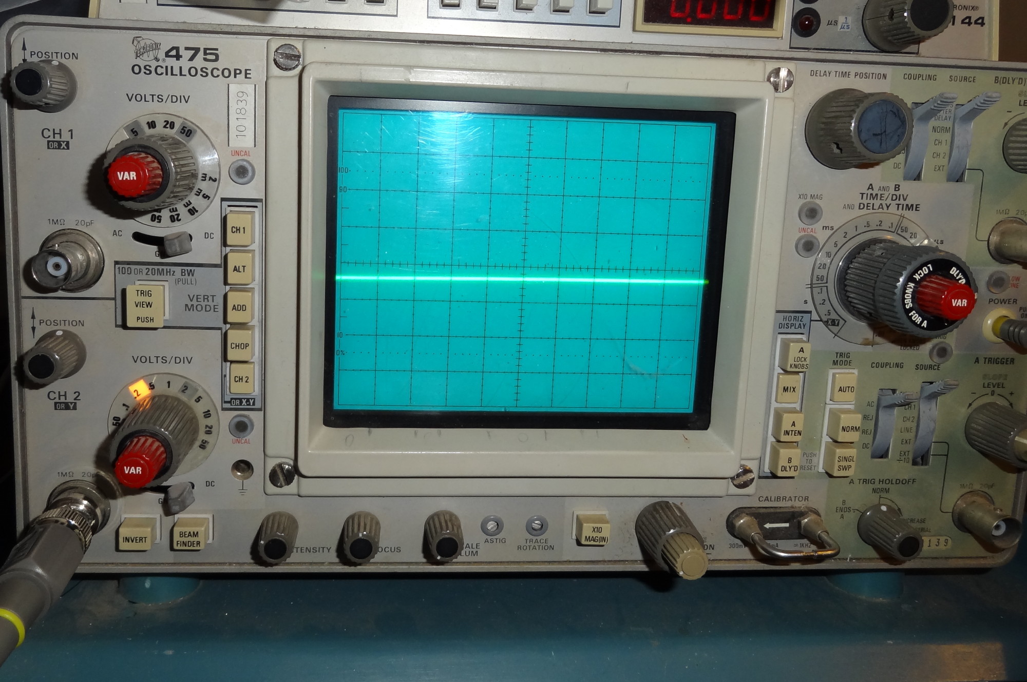

I felt like playing around with it some more to see if I could learn something. I pulled out the board that I had installed base stoppers on. I pulled the rest of the components and installed the 22R resistors in the rails so it now matches the schematic in post 659 except I also pulled R53 to disable C10 and R52. Now when I fire it up offset is very close to 0V. I have the bias turned very low during these tests. Now, as soon as I touch the DMM probe to low side of R26, the offset shoots up and so does the bias. I settles at about -200mV offset and the bias to around 12mA per device from 0mA. I see a sawtooth image on the scope. It will play a sine wave but of course it is a fuzzy one. I'm attaching some pics of the event.

which output offset? The 24Vdc that lasts a few seconds or the 40mVdc that drifts a bit?................
Removing D2 and D4 greatly reduced the offset. .............
If you mean it reduces the 24Vdc offset, then yes, that is in effect a fault condition. The DC blocking capacitors will during the fault condition see a high DC voltage. The caps must be rated for the fault condition.
The inverse parallel diodes will pass current during high offsets.
Removing them will affect that.
But the diodes should NOT affect normal operation. Even D.Self uses diodes across the DC blocking cap. It allows a 10V electrolytic to be used where otherwise a 50V to 100V cap would have to be specified.

One more thing, the board that I am toying with now that has the pre-drivers removed doesn't display that huge offset at startup. It starts at about +2V and settles at about -4mV.
