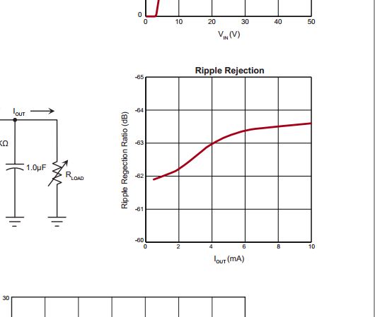

TL783: Min current to maintain regulation: 15 mA. --> Not suitable in this design (see Post #1). It may work stand-alone in a preamp with low B+, but you'd get better ripple rejection by using my design.
The LR8... can only provide 10 mA which isn't enough to power much of a power amp.
That's what I get from glancing over their data sheets. I have no personal experience with the devices.

The TL783 from TI does have a mimimum current of 15 ma. but this is easily absorbed driving output tubes.
http://www.ti.com/lit/ds/symlink/tl783.pdf
The LR8N from Supertex doesn't have the 15ma. min current requirement. It works well in preamp applications with low plate currents.
http://www.supertex.com/pdf/datasheets/LR8.pdf

Tom,
I appreciate your circuit but give the chip its due. 50 db is minimum, typical is 60 and current max is 30 ma. ,not 10, more than enough to run a line amp. At 57 cents a piece from Mouser you can use two (or more), one for each tube in your amp, now they have 60 ma. capability.
Zener's are noisy devices and far inferior regulators.
Rob

Tom,

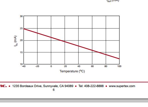

Actually, the current listed in the LR8 datasheet is the current of the current limiter. I.e. the chip will limit the current at minimum 10 mA, maximum 30 mA. So I wouldn't plan on getting more than 10 mA out of it.
I read datasheets for a living so I tend to read the limits rather than the typical numbers - unless the typical numbers are backed up by statistical data that's published in the datasheet. Sorry. That's how I work.
72 cents. Yeah, if the performance is good enough, that's very tough to beat.
As I said earlier, many ways to skin a cat. I'm obviously rather proud of my work, hence, biased in that direction.
~Tom

Tom,Current limit is an aspect of device dissipation.
From the data sheet:
"The LR8 has current limiting and temperature limiting. The output
current limit is typically 20mA and the minimum temperature limit
is 125°C. An output short circuit current will therefore be limited
to 20mA. When the junction temperature reaches its temperature
limit, the output current and/or output voltage will decrease to
keep the junction temperature from exceeding its temperature
limit. For SMPS start-up circuit applications, the LR8 turns off
when an external voltage greater than the output voltage of the
LR8 is applied to VOUT of the LR8. To maintain stability, a bypass
capacitor of 1.0µF or larger and a minimum DC output current of
500µA are required."
So I disagree with your 10ma. assessment, especially considering that I have used this regulator with good results.
Again, I' m not attacking your design nor have I said that it is without application.
My design philosophy is simply to use the best component for the specific application. I offered the LR8 and the higher current TL783 as alternatives for designers to consider, that is all.
Many, many times in my articles readers have asked why I didn't use an alternate component and many times it was because I wasn't aware of a simpler solution for my specific application. Taking their advice, examining their alternatives, and often employing them has made my overall designs better. Again, that doesn't mean your design is without application only that there are applications where other components are better suited.
Tomorrow you may find a better component for your design as you found better components for the original design, that's what advancing the art is all about.
It is the designer who myopically adheres to his design who loses out in the end as those with the flexibility to change surpass him or her.
Rob

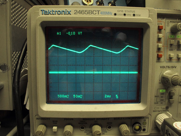

i have to rejigger my setup for measuring PSRR and Zout for high voltages, and my other Tek gets very unhappy when more than a few hundred volts are presented to its vertical amplifiers -- but here's a before and after -- the load is pretty light @20mA. 400 Volts in, 280 Volts out:
Nice!! That's what I'm seeing with 475 V in, 400 V out @ 200 mA as well.
I am curious to see what you come up with to measure the PSRR or line rejection. I tried with a transformer in series with a lab supply to inject a disturbance on the input voltage to the regulator, but the lab supply got cranky and its output voltage dropped significantly. I'm not sure why...
I suspect a source follower with a modulation signal applied to its gate would work. I'll give that a whirl at some point.
Thanks for posting your results. It's good to see that the circuit is reproducible by others.

The problem you get with transformer based current injectors is that they get saturated pretty quickly (unless it's a really, really expensive transformer) -- you're running the AC + DC current through it. The Dieckmann Current Injector scaled for HV is probably a good bet. Per Audio Precision you should check the transformer linearity and distortion at higher and higher currents.
Had you seen Jan's article on the "T-Regulator" from Elektor March 2009 -- he waxed poetic on the merits of the LT3080 as a replacement for the MC1466L. You can still find the MC1466L datasheet and apnotes on the web although On-Semi (nee Motorola) discontinued the part over 20 years ago.
