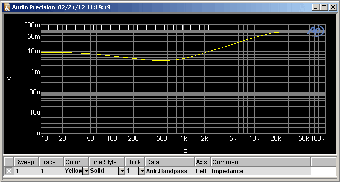

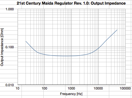

I used George's method for figuring the output impedance (thanks George!). I rigged the regulator to my 300B SET and cranked the signal generator. I measured the AC component of the B+ and the AC current drawn by the amp using a 10 ohm resistor in series with the OPT primary (that I have in there for easy bias point check anyway). Result's attached. Around 60 mOhm across most of the audio band. Not shabby...
I question the validity of the data below 100 Hz, though. I find it odd that the output impedance would be higher at DC than at mid band. But until I get a better test rig, this will have to do.
~Tom
~Tom
Try lowering the value of C5.
If you want to measure values below a a milliOhm, Kelvin Clips are almost a necessity, and you want to measure Zout as close to the regulator as possible.

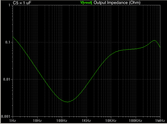

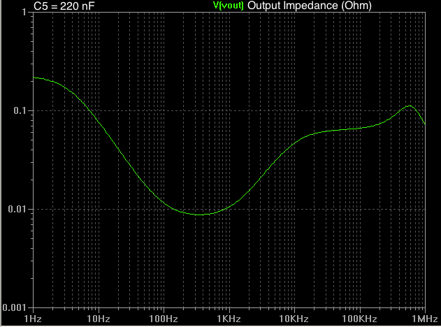

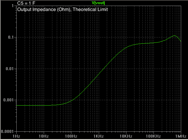

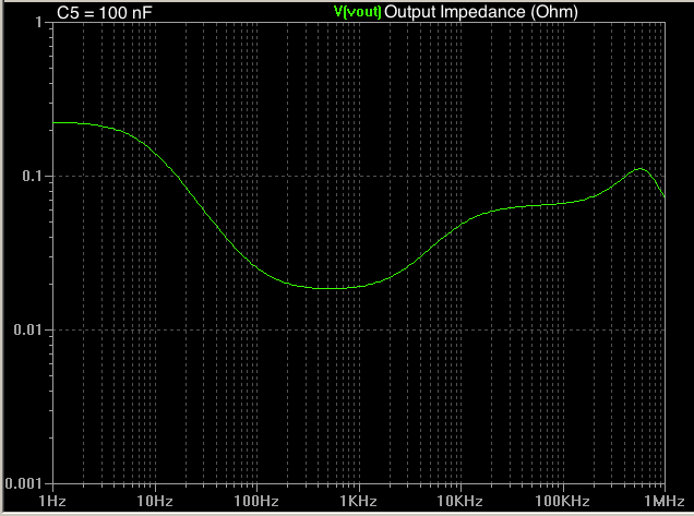

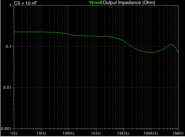

I beg to differ. Please stare at attached simulation results.
Graphs show the effects of varying C5 from 10 nF to 1 uF. I included C5 = 1 Farad as well to show the theoretical limit (ain't simulation wonderful).

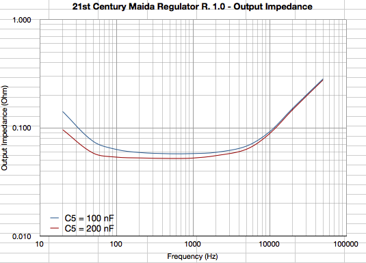

It must have been a while since I looked at the output impedance in the simulation as it correlates very well with the behavior I'm measuring in the lab. The simulation predicts a mid-band output impedance in the low 10's of mOhm. I measure 60's of mOhm. I bet the difference is the routing resistance on the PCB as I measure at the output connector, not at the output of the regulator IC.
I'm considering increasing C5 to 220 nF, but I'll try it in the lab to see if it makes that much of a difference. I may just add a footprint for the bigger cap if it'll fit nicely on the board. I don't see a point of going much beyond that as the resistance of connectors and wires from the regulator to the load will negate the (marginal) improvement in Zout caused by a higher value of C5. Remote sensing (as jackinnj pointed out earlier) would be nice, but that's a project for a different day.
BTW, the Q of the complex pole pair at 570-ish kHz comes in at around 0.75~0.8 implying a phase margin around 60~65 degrees.
~Tom

Make room for the new king, the 200 nF capacitor takes the crown. And everybody now runs out to buy heavy duty silver wire for the hookup. All kidding aside, this is a great result combined with stability and phase margin and ripple. I look forward to using it.
