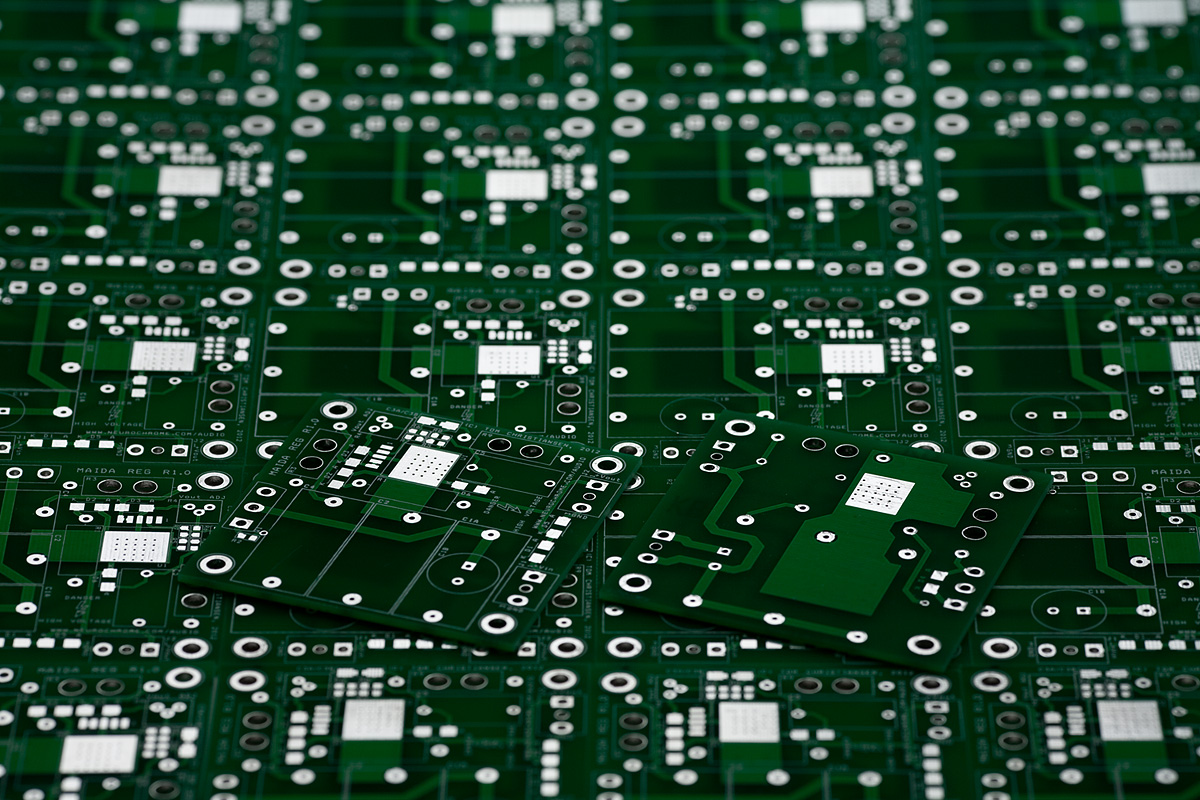

Boards are in
The boards arrived about 30 minutes ago. I've sold about half of them so if you are thinking about buying one, you may want to convert thoughts into action... I can, of course, always order more if there is sufficient interest.

I'm trying to find the LT3080 TO220 somewhere in europe; only one who can order them seems Farnell, but they ask a 25€ fee for transport from US 🙁
Anybody a better idea?
Paul
Paul
Hi Paul!
Why TO220?
Dissipation only 0.4-0.5W.
Farnell stocking SMD version (EU stock/UK stock).
LT3080EST#PBF - LINEAR TECHNOLOGY - IC, LDO REG, ADJ, 1.1A, SOT223 | Farnell United Kingdom
Why TO220?
You'll need the surf mount DD-PAK 5-pin package for this board. The TO220 will NOT fit.
