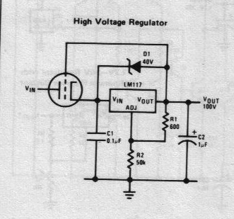

The 1970s National Data Sheet for the LM317 included a 'serving suggestion' for a HV 317 regulator with a triode to hold off some of the unregulated voltage, not unlike the "Maida".
This circuit should work well enough, provided you have some protection against static overcurrent. A suitable triode (or more Likely - a very low cost Russian power pentode or Beam Power Tube) is much better placed to cope with transient overvoltage or thermal stress events - that might blow a FET to short.
Very cool. Yeah, that'll work. It'll suffer the same disadvantages as the regular Maida circuit - 10 mA needed through the LM317 - but it is handy to be able to dissipate the majority of the power in the tube.
That circuit should work just fine with the LT3080 and my 21st Century Maida Regulator. Just increase the breakdown voltage on the Tranzorb (D3) to 30 V or so. The regulator IC can handle up to 36 V (40 V ABS MAX).

Regarding the zener, it will limit the Vg of the cascode tube to 30-ish V, right? Then looks like in some cases where high Vin-Vout and low loading current present, tubes like 6С19П might not work?

I got curious and looked at triode strapped 6L6GC and KT88 just as examples. Even at moderate currents (200 mA), the voltage across the tube is well over 100 V for values of Vgk that would allow the LT3080 to regulate. This severely limits the amount of current the regulator will be able to supply. So if you don't need that much supply current, the tube cascode may work well. But then so with a MOSFET with a small heat sink.
Duong,
If you need more grid bias voltage, for low current, you can always add a Vbe-multiplier (in the cathode wire) to add any voltage you like.
A Zener can do the same thing, but adds unpredictable amounts of noise.
Endstage Beam Power Tubes like 6L6, KT88 etc are designed for high voltage operation, and won't serve for high current.
The story is very different for purpose-designed series pass triodes:
6AS7 or 6080 can do 300mA for about 70V headroom and 10V-20V bias;
And if we are trying to feed some steaming beast, call out for the Ulyanov 6C33C (6S33S), who will answer with 600mA at 60-80V headroom.
If that's not enough, Parallel more bottles, get any unreasonable amount of current!
