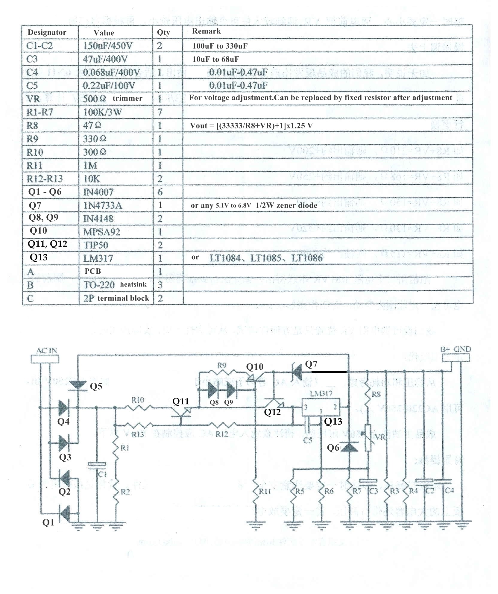

@tomchr
I've got an initial need for two adjustable high voltage regulators for a tube tester.
Since I cannot work with chemicals anymore and have limited movement in my hands I ordered two PCB's from evilBay. Before I order parts to populate I would highly appreciate your input on what / how I can improve while keeping costs down.
The original brief of the Maida regulator mentioned something like 180V at 25mA max and I like to go higher with the voltage and current,. The seller mentioned it will go to 285V but don't know if it is capable of delivering a higher current.
For the tubes I like to test up to KT66,/ EL34 and will need in the order of 120mA. I do not want to go above 300V, if it turns out I cannot go above 275V then I am OK with that too. (plus the pre amp tubes but those current draws are not the problem).
I've been thinking about replacing the TIP50 with the E13005, what are your thoughts? Another alternative is using a darlington or mosfet but then I'll start to get into trouble with the layout.
I am aware of the dissipation issues but will address that with a tapped transformer.
I am attaching the diagram and parts list.

It looks like you purchased something which is NOT Tom's 21st century maida regulator, so you may want to start a new thread w/ your question.
Yeah... That's not my circuit. I can probably help you figure it out, but I think that would be best served in a separate thread. You'd attract more help from others that way as well.
I generally suggest to build things according to the assembly manual and verify operation before modifying it. Or at the very least set it up in a circuit simulator and play with it there.
~Tom

I think I understand. Can you verify?
The DC in becomes the relative ground for the regulator, and the trim pot can adjust the voltage that is riding above the DC out of the resevoir capacitor, but the only way to lower the voltage below the DC in across R9 which is from the set voltage to ground?
Sorry I'm not a power supply guy by any means,
Thanks,
Scott
Both the input voltage and the output voltage are referenced to ground. The regulator forces 2 mA through R9 and this sets up the output voltage from ground to +Vout of 2*R9 (R9 in kΩ).
What I think may cause some interference in your mind is that both the LT3080 and LM317 are floating regulators. This means the regulator IC itself does not know where ground is. In case of the LT3080, the IC supplies a precision current out the IREF pin and drives the OUT pin to the same potential as the IREF pin.
~Tom
~Tom
Tom,
I managed to get some LT3080 for testing and the result was a big improvement in comparison to original Maida circuit.
By the way, I just had an idea of using tubes instead of Mosfet as cascode device, but I'm still not really sure how to do it, do you have any suggestion?
Thanks,
Duong
Thanks,
Duong
Using a tube as the cascode device. That's a pretty interesting idea. If the tube can handle the power dissipation, you should be able to use a circuit to mine. Just increase the zener voltage on D2 such that you end up with at least 1.6 V across the regulator IC under all operating conditions (excluding the over-current condition, obviously) and you should be fine.
Test the transient response of the circuit, though. The output impedance of a tube cascode (cathode follower) is relatively high compared to that of a MOSFET follower, which may affect stability of the regulator IC.
~Tom
~Tom
Thanks for your tips, I will keep them in mind.
Embarrassingly I'm not familiar with how the transient response is tested, so further explanation is really appreciated.
Anyway I will try this idea when freetime arrives, the tube might be Russian 6S19P (6С19П) or 6AS7...
Thanks,
Duong
Thanks,
Duong
