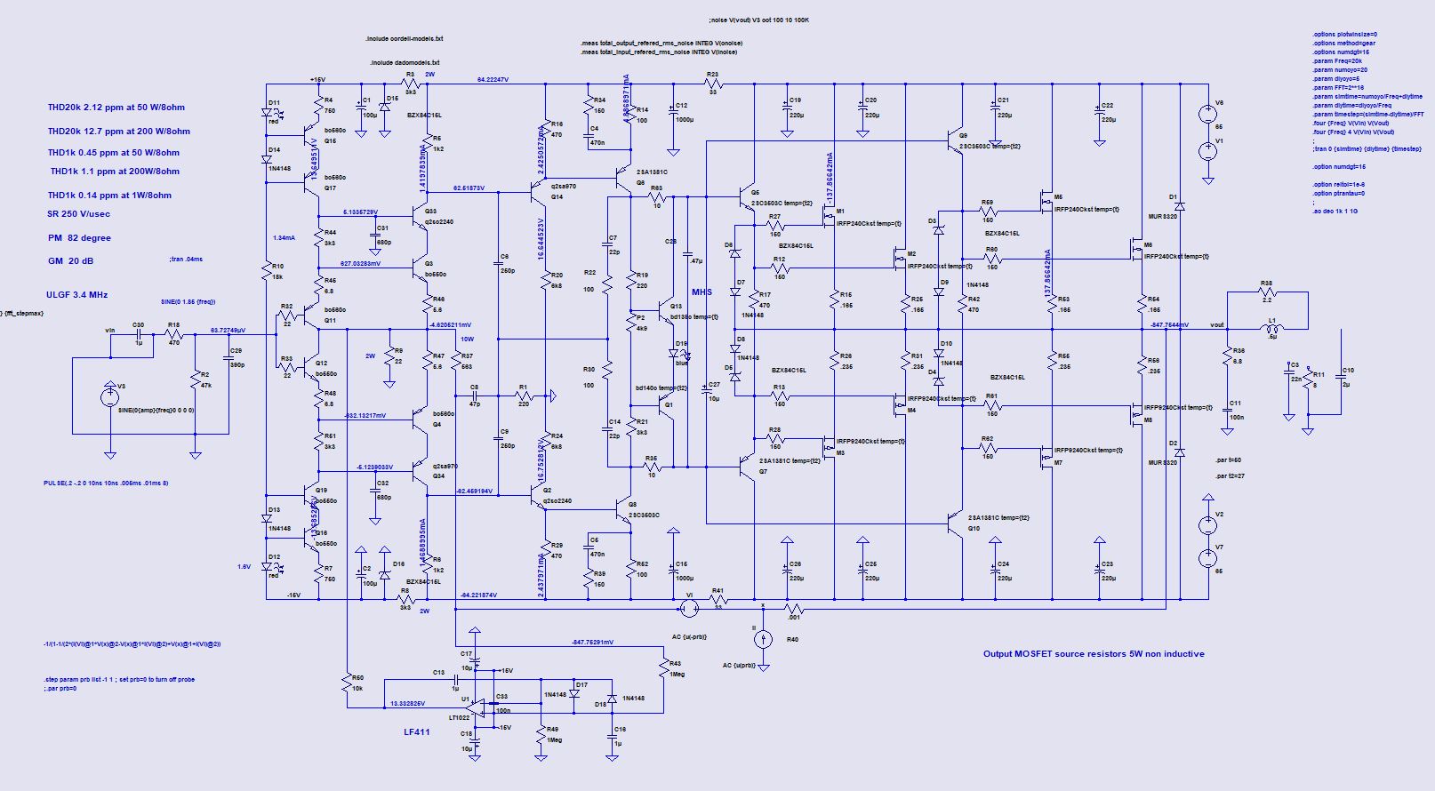

Here is the last 200W-CFA-VMOSFET zip file with .asc and models files.

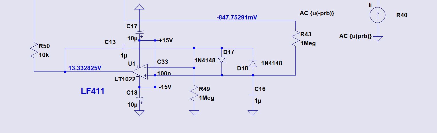

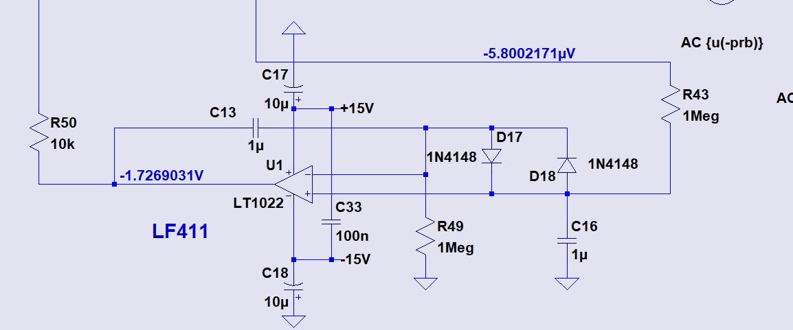

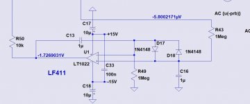

Hi Damir,
I may be wrong but I believe there is an error in this asc from your post #775 200W MOSFET CFA amp. C33 which goes between the two 15v rails, appears to shorted to the + input of the LT1022.
I had connected the cap like this in the modded version of the 100W CFA and could not adjust the DC offset after much poking around I realised what the problem was.
When I ran the sim with the input shorted and load open to check the bias and offset, I got -847.7544mV DC offset. Removing the short as per your 100W CFA attached allowed me to make/ test the adjustment.
As I say I may be wrong and will defer to your knowledge.
200W-VMOSFET-efVAS-mc-RC-150-0_47u-OIC-DCservo- VDMOS ksubthres models-Vbe_blue.asc24 KB · Views: 394

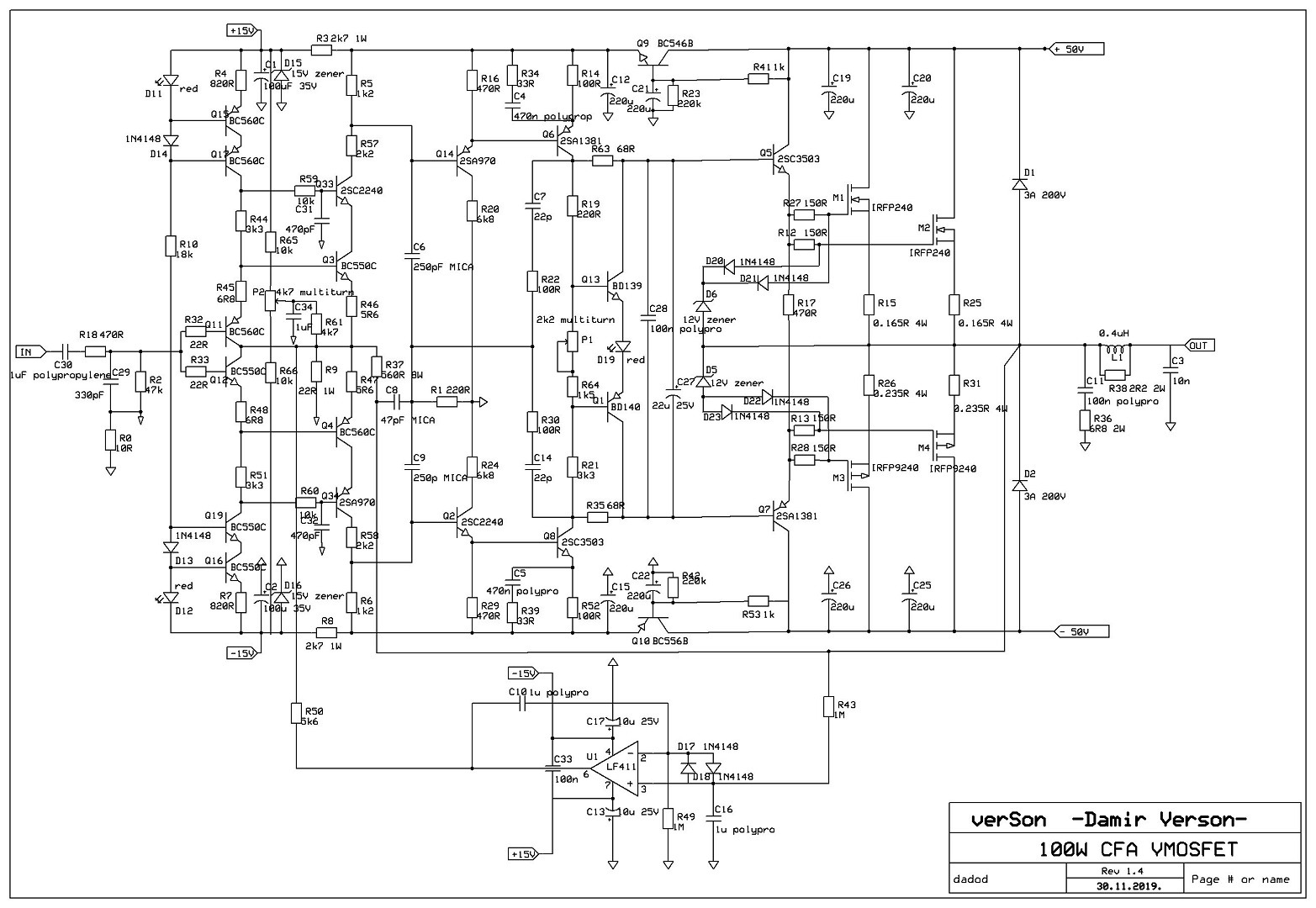

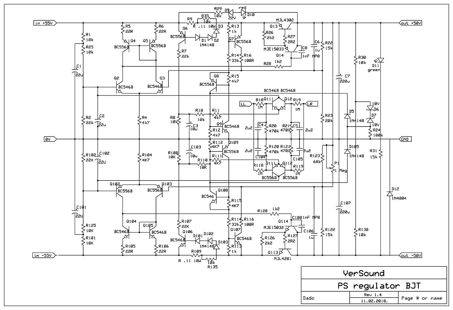

I would like to offer gerbers for my 100W CFA and corresponding Power Supply.
I hope more people will build this amp.😉
Probably, but first I would like to see if any interest to build 100W version. 😉and whether you will also share up to 200W MOSFET CFA gerbers
Hi Damir,
The 100W circuit uses BC550 and BC560 transistors. The BC560 is not easily available/obsolete now.
Looking at the specs, would the use of BC549 and BC559 be ok. The BC549/BC559 has a Vceo = 30V, as compared to the BC560 Vceo = 45V.
I notice there is a 15V zener diode limiting the rail voltage where the BC550/BC560 transisors are used.
My thinking the BC549/BC559 pairing should be ok in the transistor positions of Q15/Q17, Q11/Q12, Q16/Q19 and Q3/Q4.
This would allow the use of the lower noise BC549/BC559 transistors, similar to the BC550/BC560.
kind regards
steve

Hi Steve,Hi Damir,
2SC2240/2SA970, may these be replaced with KSC1845FA/KSA992FA
Kind regards
steve
Yes. 😉
Hi Damir,
Thanks for the quick reply.
Was I also correct with the substitution of BC549/BC559?
Yes, instead of BC550C/560CHi Damir,

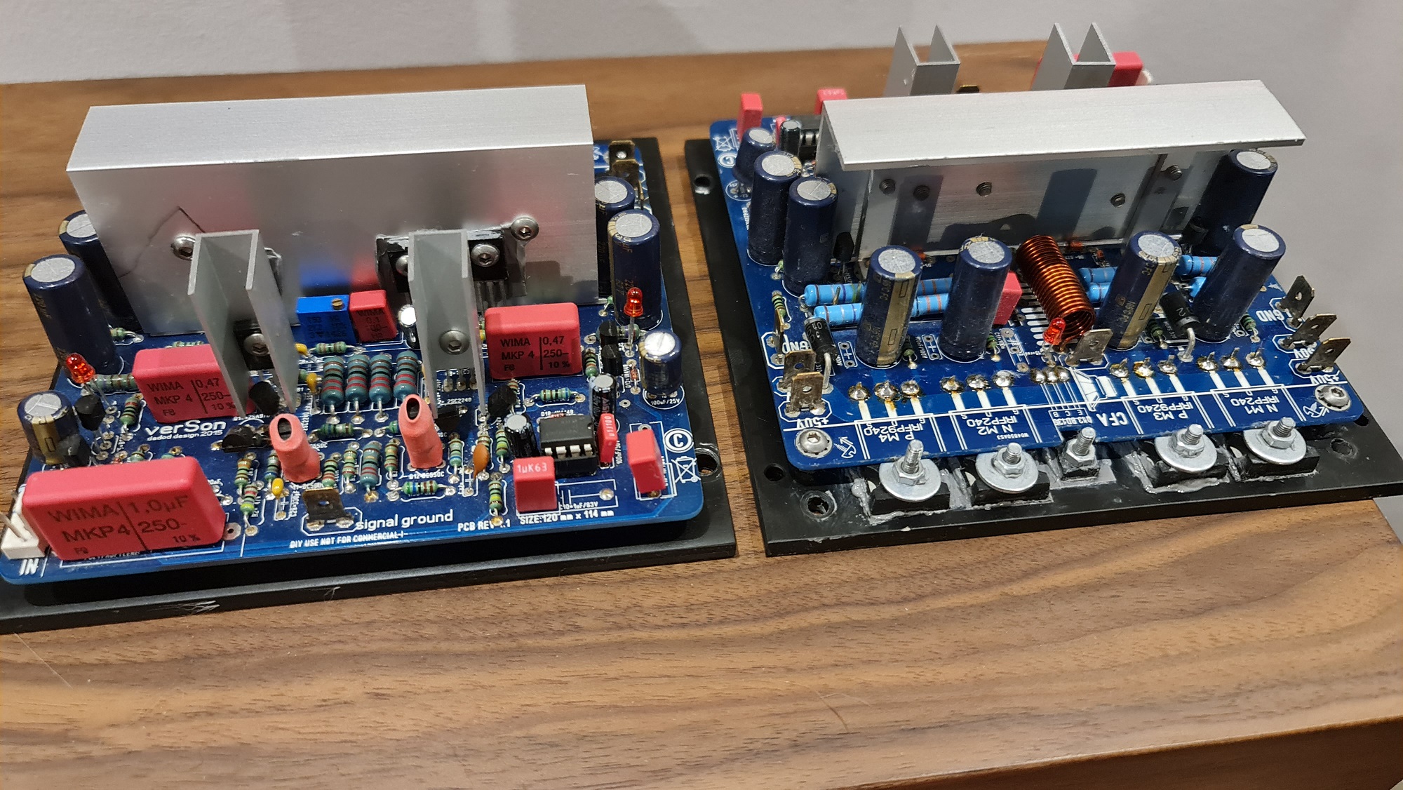

It’s hard to resist such a good offer. I just ordered pcb and plan to build it along side Astx’s amp.Any fruits born from offered gerbers? 😉
Good, show your progress here.It’s hard to resist such a good offer. I just ordered pcb and plan to build it along side Astx’s amp.
