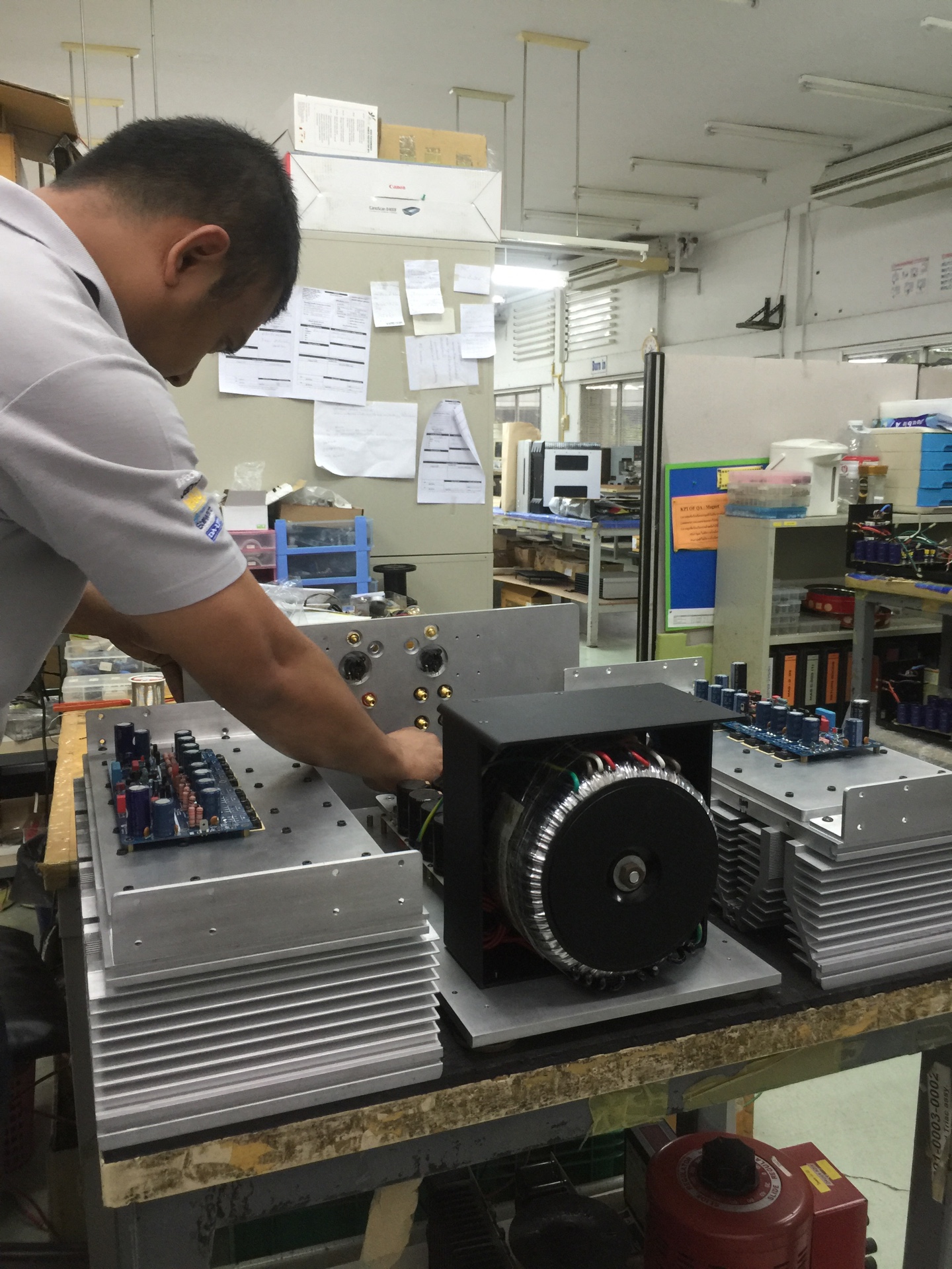

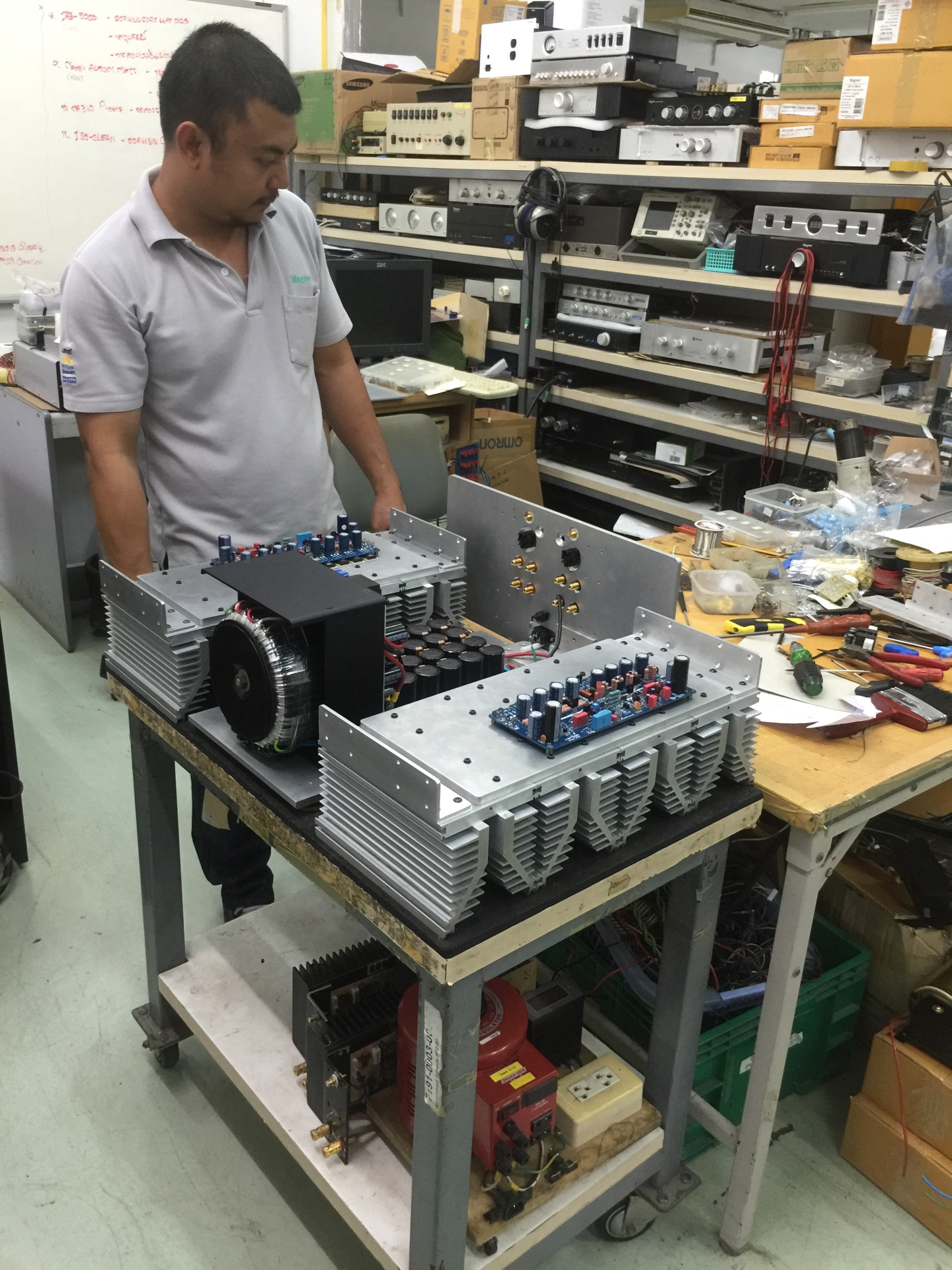

Here is my incarnation of your amp. My tech support is out of Thailand.
I will need two stereo amps for use with active crossover/DSP (800Hz) for my new speakers.
THx-RNMarsh
This looks very similar
I am back in Bangkok, Thailand and I got to listen to the amplifier. I never heard such good pin point imaging and same for the depth... front-back layering. Wow. Amazing.
So realistic sounds. A challenging DIY project but SOTA when you are finished. The combination of CFA, high SR, ultra low distortion and especially that the distortion doesn't change with load Z or freq or power... makes for such accurate imaging and details in reproduction.
You can easily hear the individual differences in sound character of several preamps with this PA.
THx-RNMarsh
