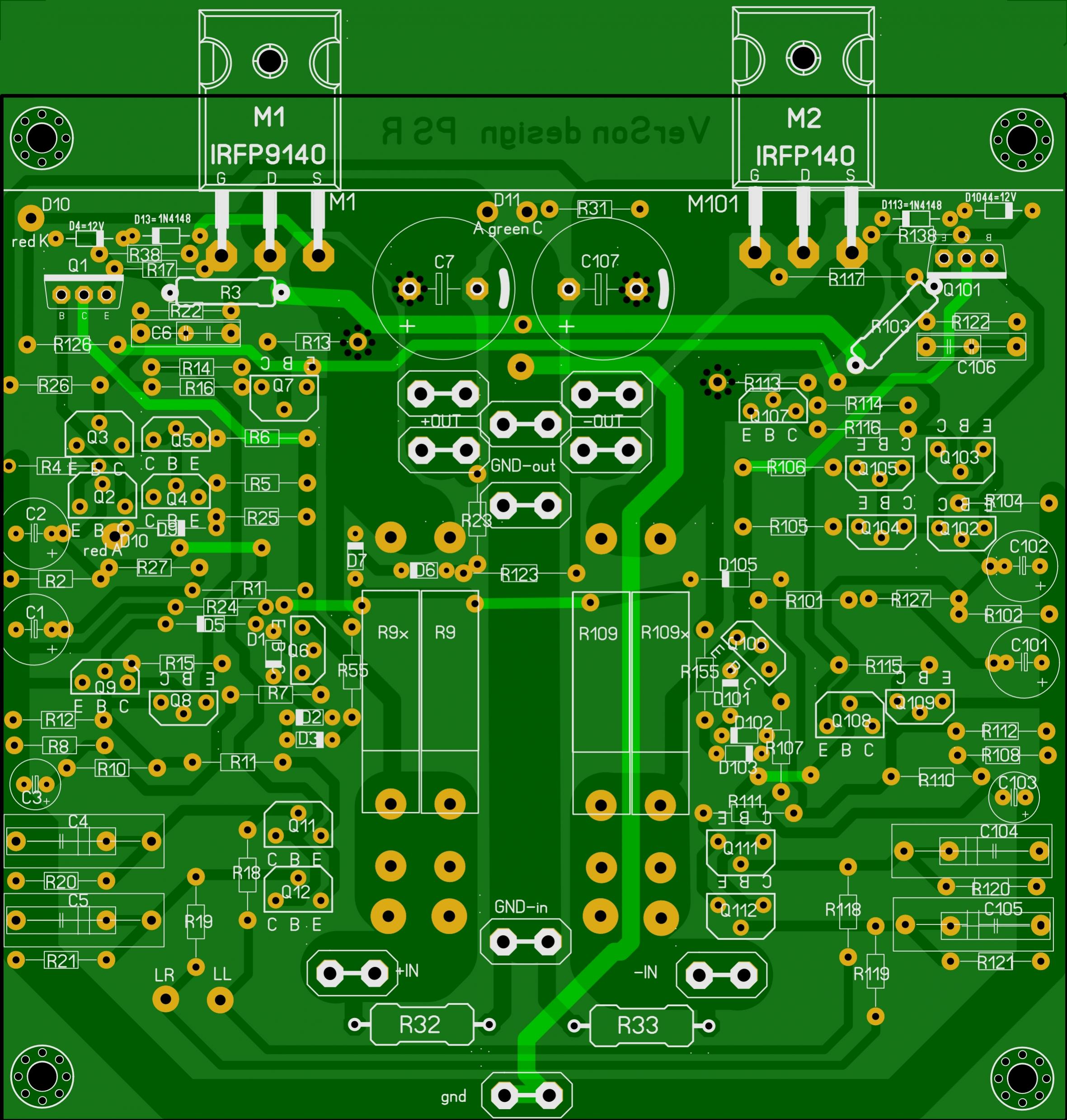

Now I have question. Attached photo view of the PS regulator board. Different between this boards and amp board is that PS board silk screen shows element name and numbers not the values. Is this OK with you or I need to put the values? It will take a time and cost a bit more.
Damir

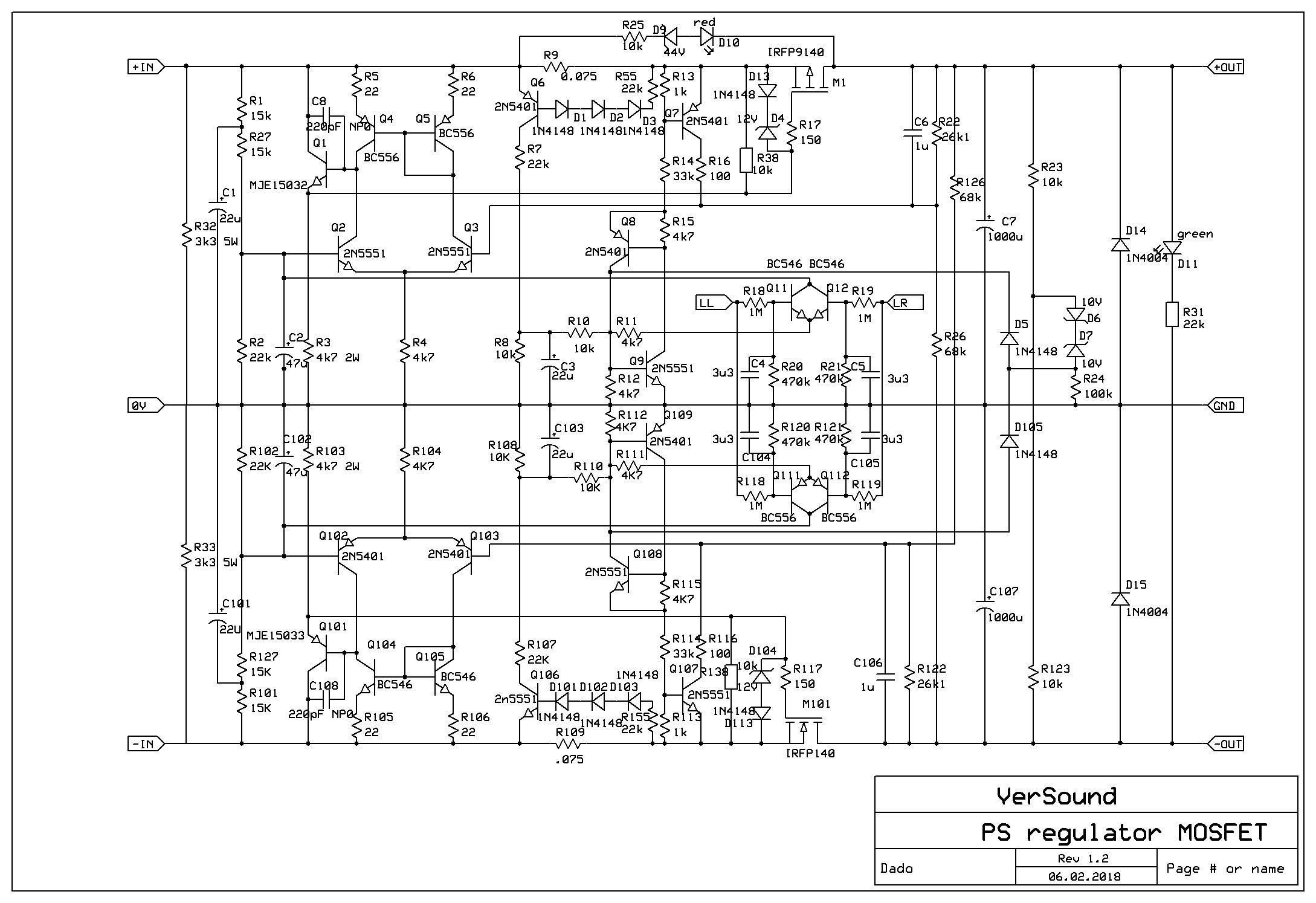

Hi Dadod,
I read that the PS regulator board includes a short cut/ overcurrent protection. If I'am right, this board does not open the connection to the speaker. It switches only of the power supply. Is this fast enough in case of a short cut?
Hi Dadod,
It monitors the DC voltage on the output( you have to connect LR, LL or only one of it to the power amp output). In case there is DC voltage higher then 10 V it will switch the PS regulator off.
I had ones bad solder in my power amp and full DC voltage on the output, PS switched off and nothing happened to the loudspeaker. It is important not to have to big caps in thousands uF after PS regulator
