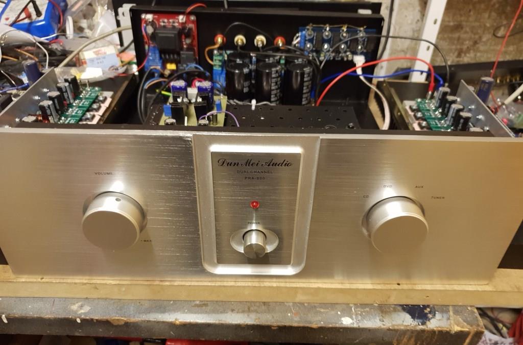

It impresses you all - crystalline voices, very beautiful and articulated bass (even at low volume), very silent. Having a lower voltage (+ _45V) and a generous heatsinks, I set a 300mA bias on the MOSFET. The sound was special. I will come back with pictures later, this amp deserves to be put in the beautiful case.

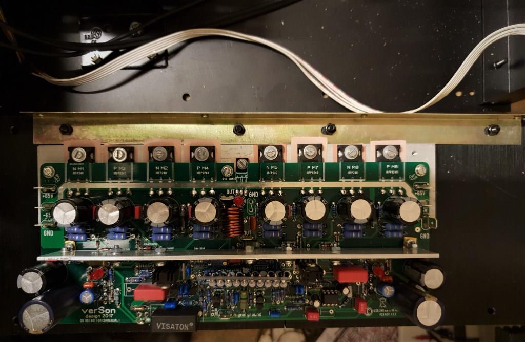

I am not ready yet. A few parts are still missing. I have just adjusted the bias current and made a few measurements. The amplifier is very broadband. With my 2 MHz frequency generator I could not determine the upper limit frequency. Attached some pictures.

Hi Gerd,
It looks good. I'll wait for your listening impression and measurement.

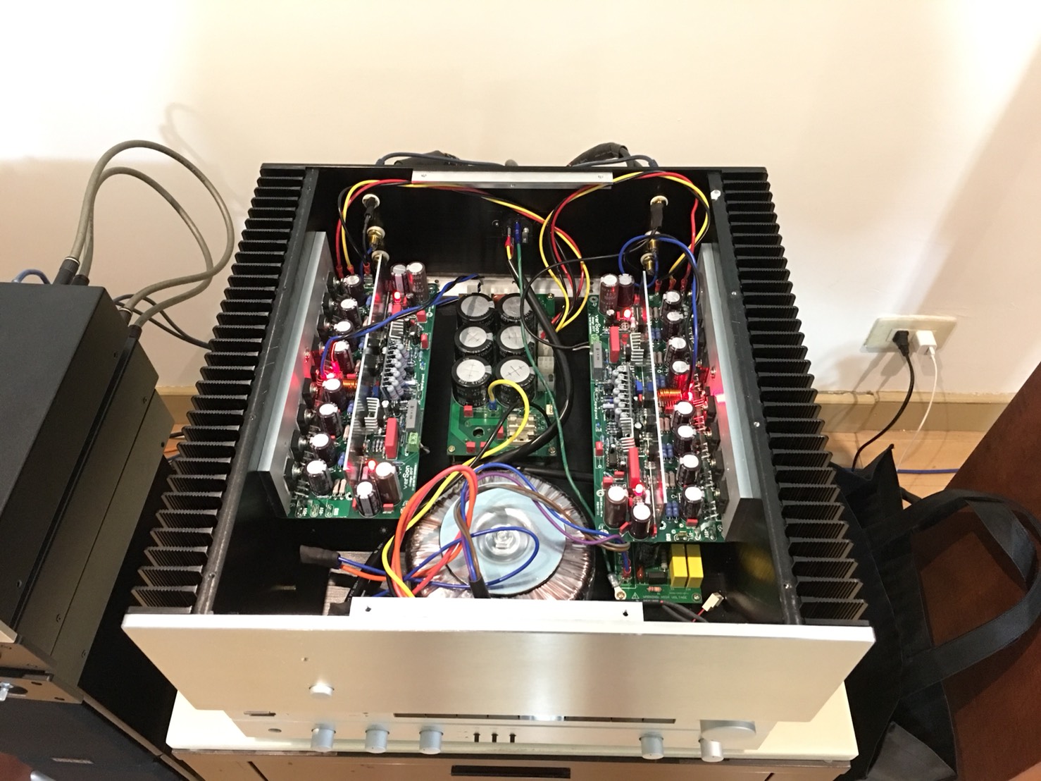

Build finally done, first impressions
Used a F5 turbo recently as my main amp. I wanted to try something with a totally opposite design philosophy to hear and compare for myself, so build the 200W CFA amp.
I consider myself as experienced builder, but this was for sure not an easy build.
I build the front end first, left VAS, drivers & output empty to test to avoid fireworks. Then completed the amp and tested with small SMPS so a mistake would not directly be fatal. After all test, build in case with bigger classic power supply.
Measured distortion is very low, actually lower than my test setup for amps currently can measure reliable.
Wanted to listen quickly, so my build is quick & dirty. Will clean up and make it a little more safe later.
For listening, I have pro-audio background. So first thing to do with a new amp? Turn it up until clip :)
The amp sounds very good, most interesting is it also sounds very good when pushed very loud, close to clipping. Many amps loose precision at loud volume, especially in the high side of the audio range. This amp keeps sounding controlled, even at ear bleeding volumes.
Need to do some serious listening later but so far very promising.

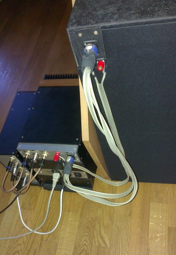

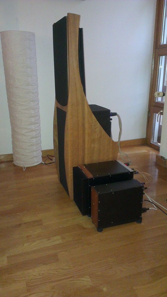

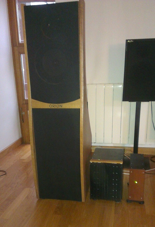

After long time, finally, I finished my three channels CFA 100W VMOSFET amplifiers. I use them to drive my ORIONs loudspeakers. Small box is ORION ASP Crossover/Equalizer, with my shunt regulator inside.
Damir
