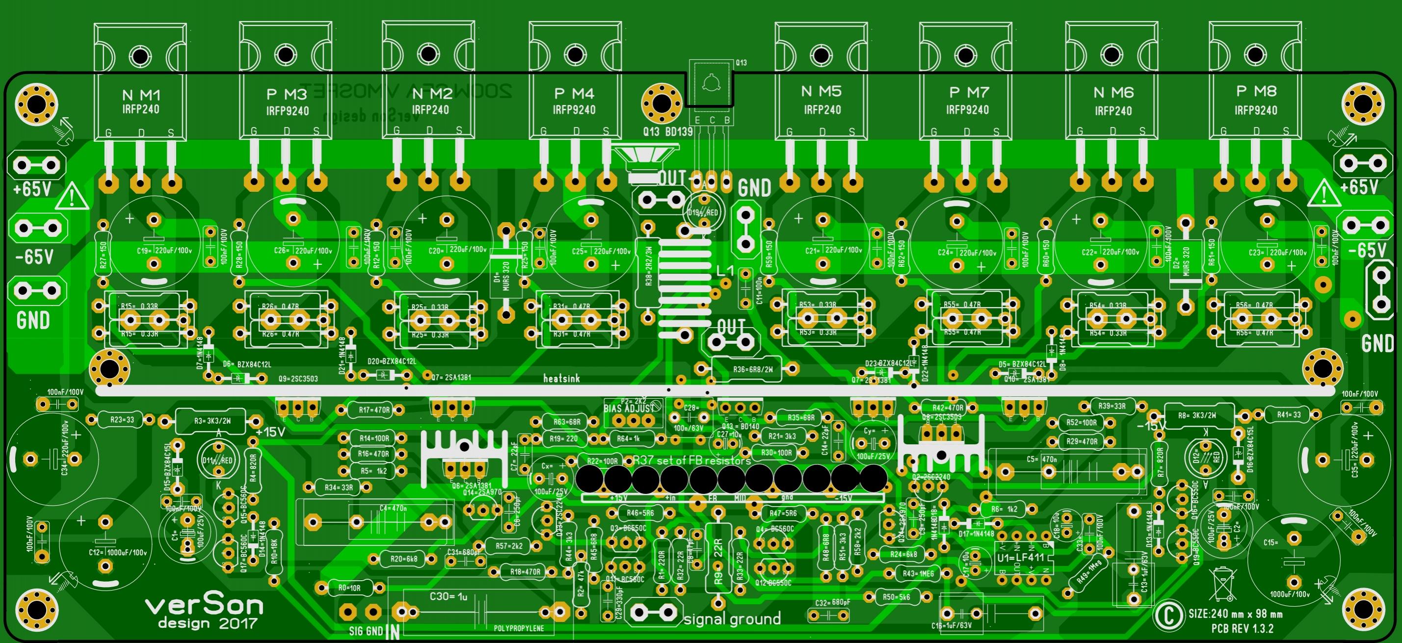

A longer feedback path isn't a problem as shown in SA2014 simulation and measurements. Of course a completely changed pcb routing can have some good/bad influence on distortion results. I will have a look on your older pcb variant and will compare this with Richards one (a link to Richards pcb version would be helpful).
BR, Toni
Hi Toni,
Unfortunately I don't have measuring equipment and can't confirm any result. My opinion, short feedback part is important. I don't remember what was ULGF of your SA2014?
Last layout is just few post back.
BR Damir

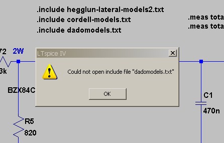

Hi dadod, for over a week ago I downloaded your .asc files packed into a zip folder for the 120W lateral FET amp, but only until now I wanted to play with it but LTspice fails to simulate because it misses the .dadomodels.txt file, I now went back in this thread to try find the original post to check if I missed something but I can't find it, what should be in the missing file?

Sorry Michael, I forgot to add dadomodels.txt file, it's here now.
Damir
Ok now it works better, it's many years ago since I used PSpice and am now trying to re-learn using LTspice, thank you Damir very kind of you.

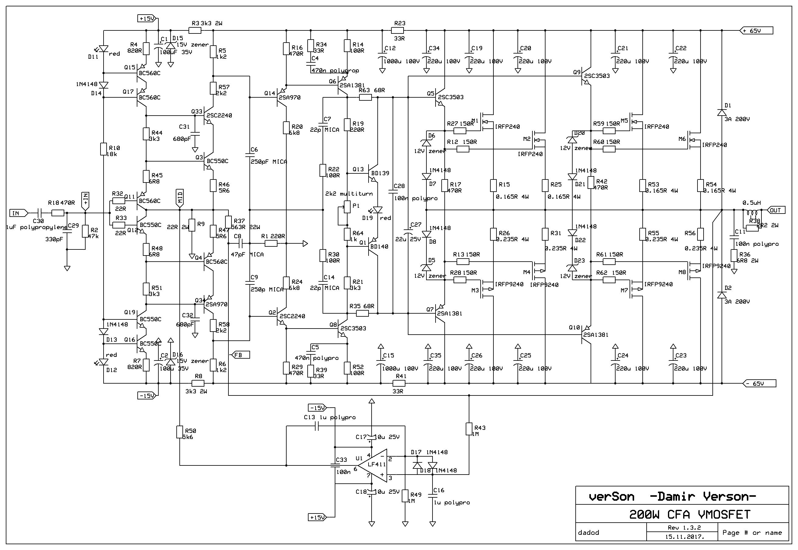

200 W CFA assembling instruction
This describe how to assemble the 200W CFA and what is important to take care of.
Those transistors should be matched on Vbe, and Hfe, 5% is OK result. If matching is not so good than output offset could de higher but DC servo will take care of it.
Q11/Q12, Q3/Q4
Those transistors should be matched on Hfe.
Q33/Q34, Q14/Q2, Q6/Q8, Q5/Q/
The 15V zener diodes shoul be matched for the same voltage (D15 D16)
The LEDS D11/D12 matched for the same voltage at 2 mA.
Output MOSFETs should be matched but if bought from the same batch matching should not be the problem.

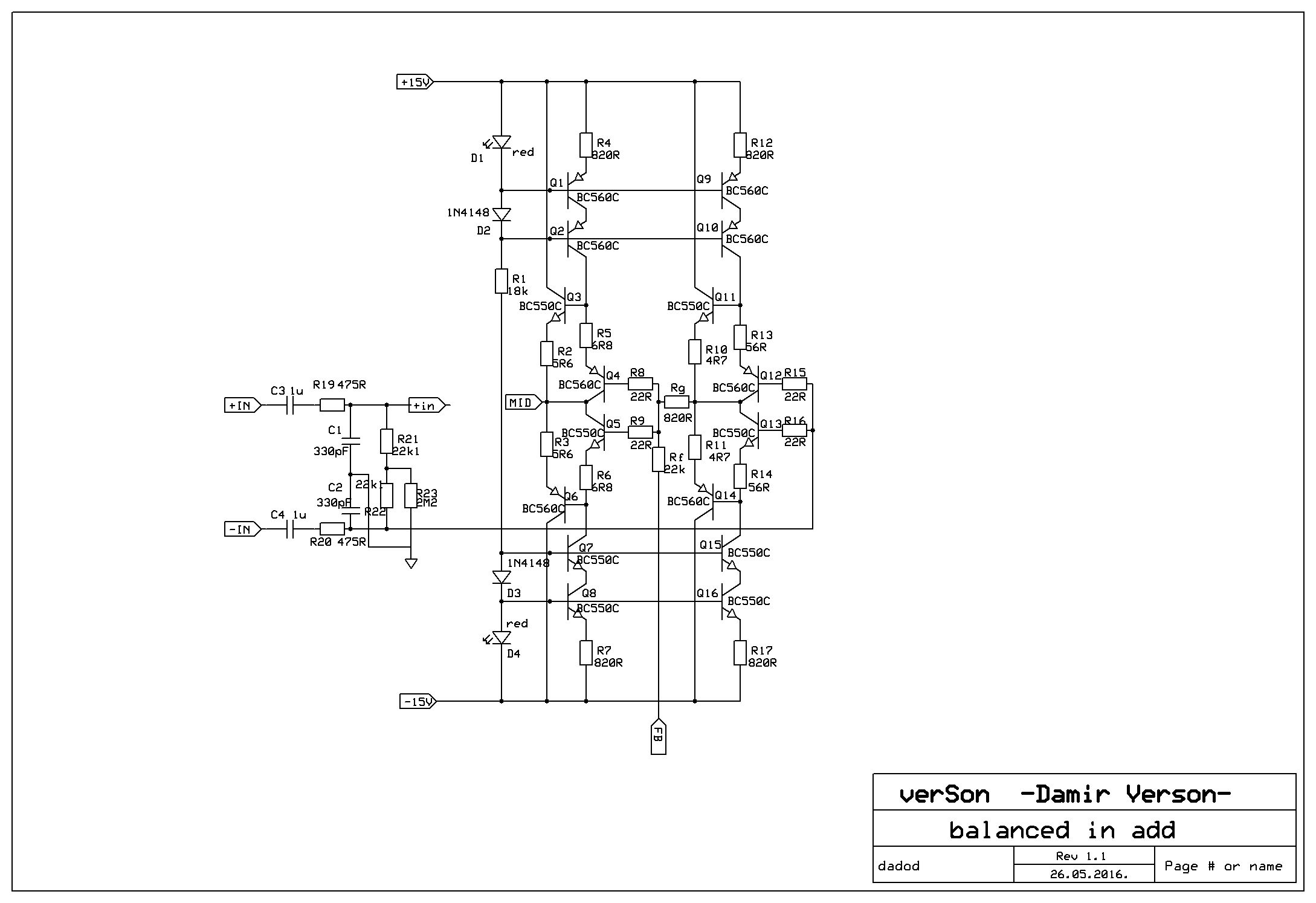

There two possibility how to configure this amp, as pure CFA with small FB board (eleven 2W resistors in parallel) or for those who bought the balanced add board the amp will become VFA with all advantage of CFA, current on demand, symmetric complementary configuration with no thump at power switch on, very stable operation good clipping behavior.
From the attached BOMs and schematics is visible how to assemble different configuration.
If the amp is going to be CFA with only non balanced non inverting input all Materials from the amp BOM is needed, but nothing from balanced add board BOM.
If the amp is going to be VFA with balanced inputs, some material is not needed from the amp BOM but all from the balanced add board BOM is needed.
I did not defined manufacturer for resistors and capacitor, just the type and you can decide if to go for more expensive components. I only suggest that you use Wishay for the output MOSFET not IRF.
To put the amp under power you should be careful. First check that the trimmer P1 is set to maximum. I use external workshop power supply with current limiter for first trial. Otherwise also good way is to use 100W incandescent lamp in series with the power supply transformer mains side.
If the VAS current stays between 4 to 8 mA (measured on VAS emitter resistor) all is probably OK, after that try to set the bias current measuring the voltage drop on the output mosfets source resistor. You can chose between 120 to 200 mA, depends how big heat sink you use.
On both schematics there are marks as +IN, MID and FB. Those points are connected together if balanced add board is used.

Voltage range for this board?
The printing on the board suggest a power supply of +/-65V. This suggests a transformer of about 2x 48VAC.
When using analogue power supply, the voltage will vary a lot from loaded to almost unloaded.
What is the maximum and minimum voltage for the board?
I get +-58.5Vdc from 230:dual45Vac transformer operating on 240Vac mains power.
A 230:dual45Vac on 240Vac should give around +-65.8Vac
On 230Vac a bit less, maybe +-63Vdc.
Your guess for 230:dual48Vac on 220 to 230Vac mains power is probably about right for +-65Vdc.

The amp will work with no problem from +-60V up to +-70V. If you want to drive low impedance loudspeakers go for lower voltage.
