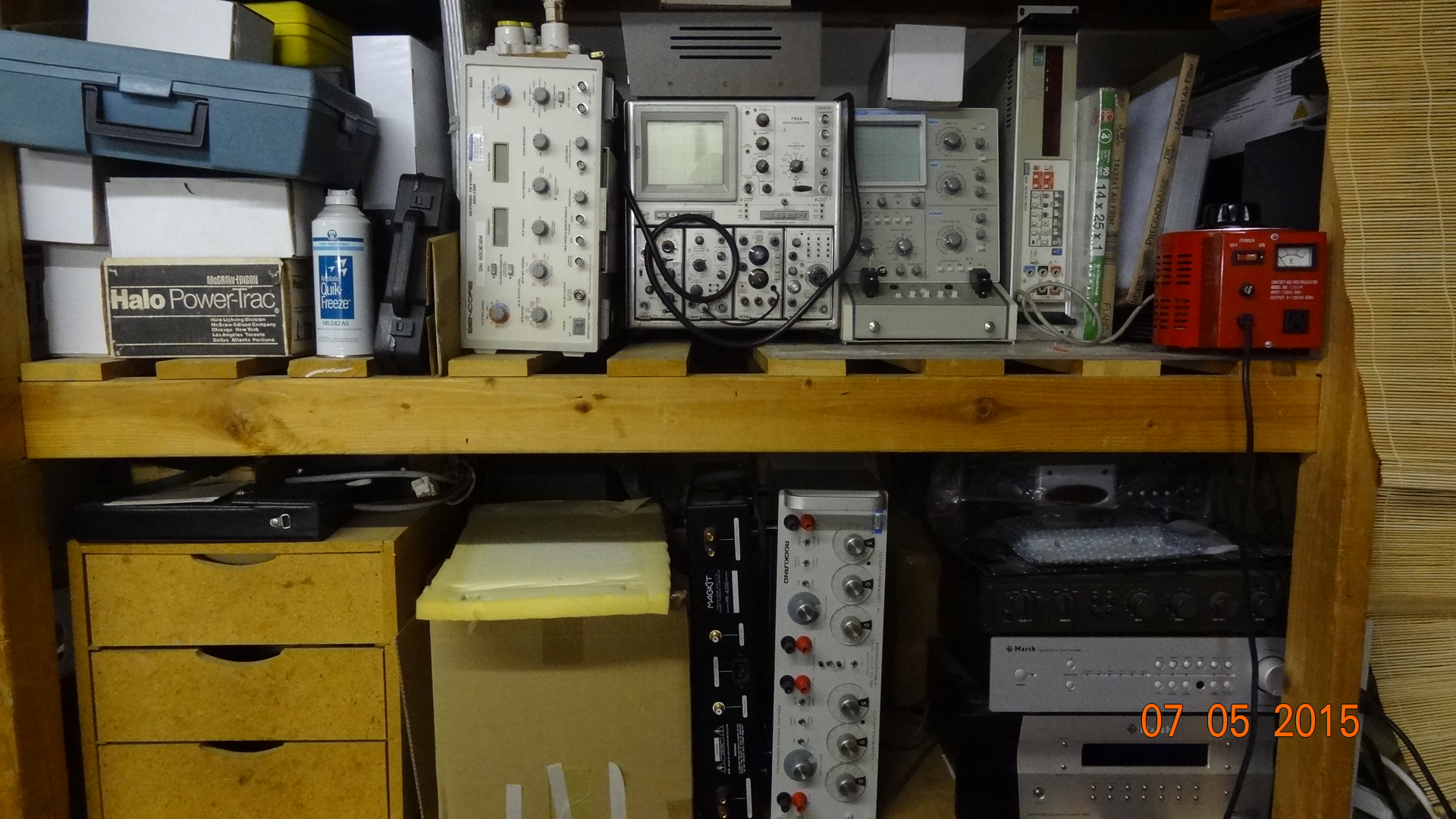

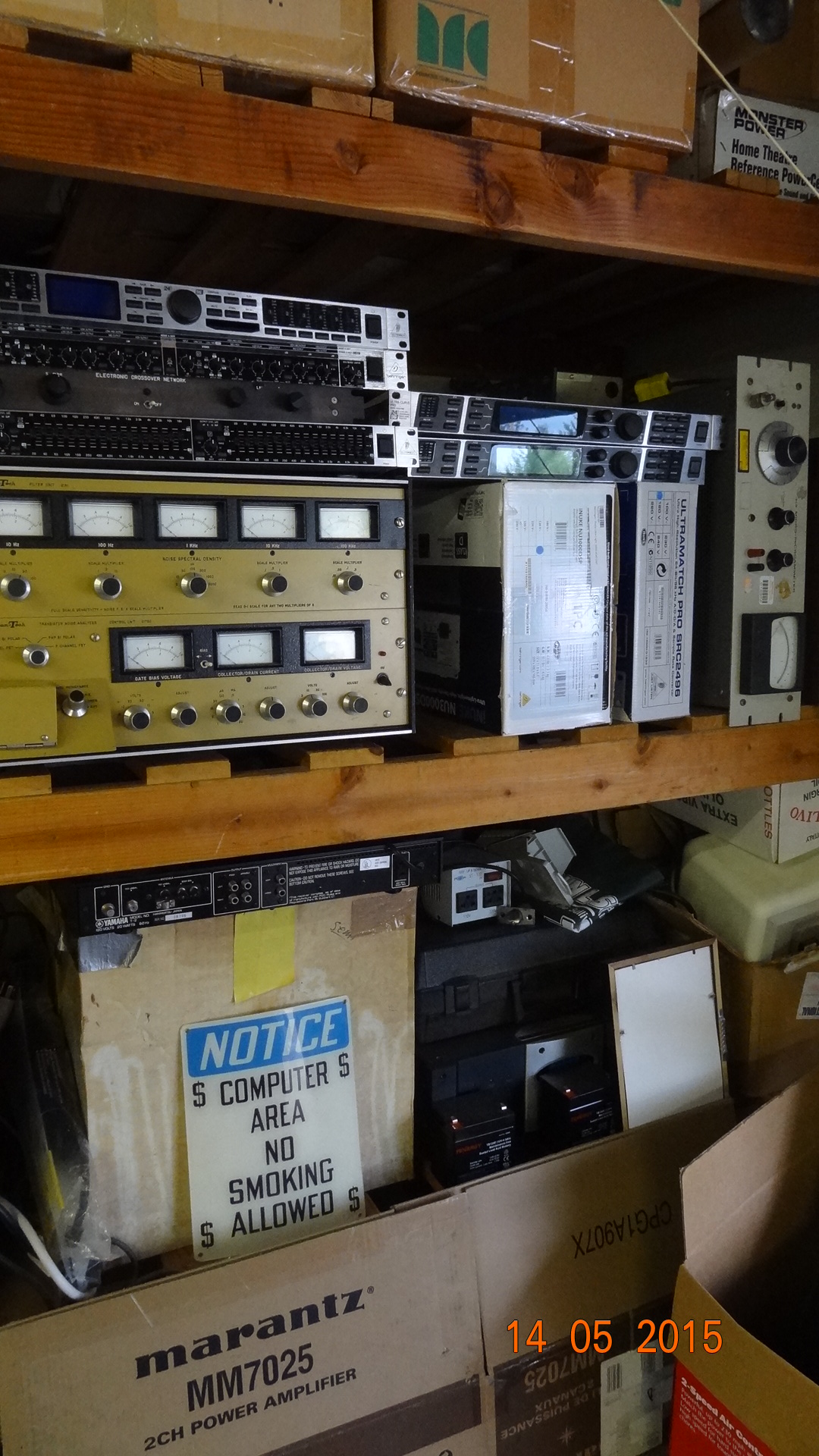

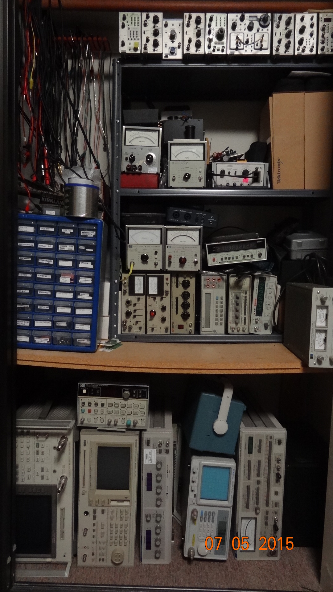

a very small portion of my T&M gear --->

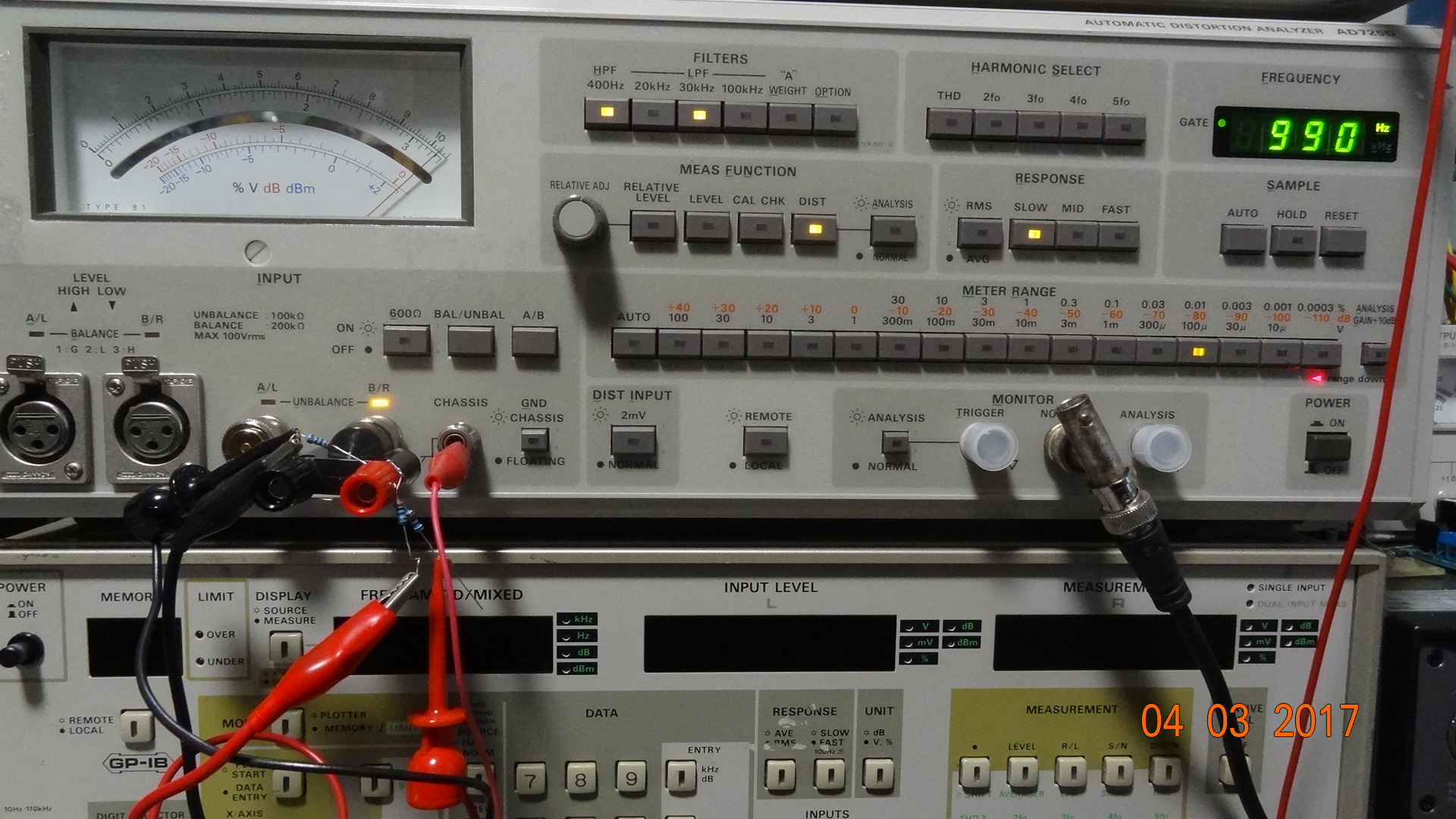

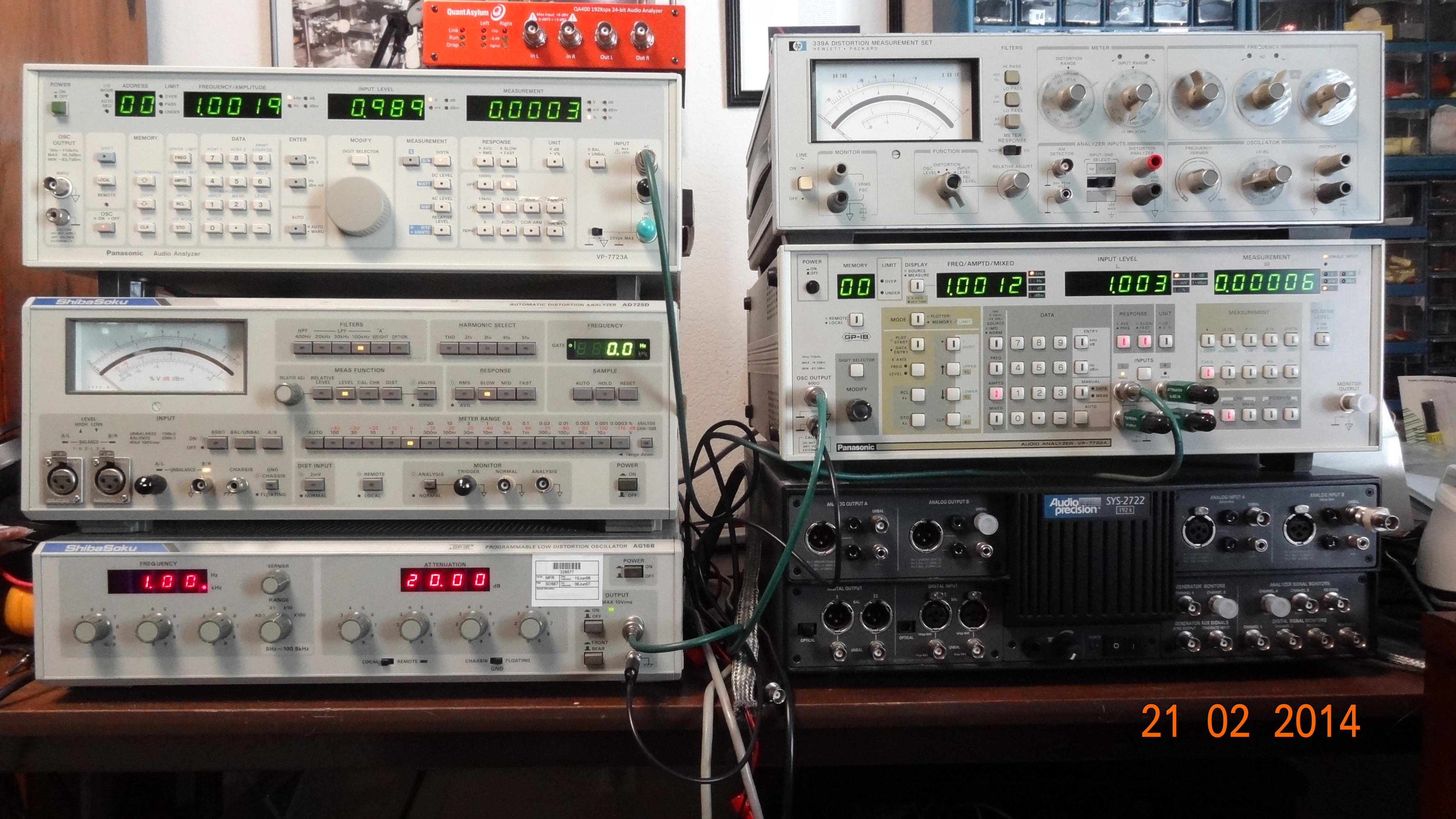

Just that I can measure all sorts of things you/others might be interested in or want to know. I am constantly adding to the 'warehouse' -- last week I added an HP 4192 to my stock of T&M gear.
You don't seem to know what you are talking about -- The ShibaSoku 725D is shown. It will measure direct off the front panel meter to -130dbv. At the monitor port and with Qa400/401 (FFT) you can see another 30dB lower = -160dbv. This has been proven during eval of Davada's ultra low distortion generator discussed else where. His gen was clocked in at -145.

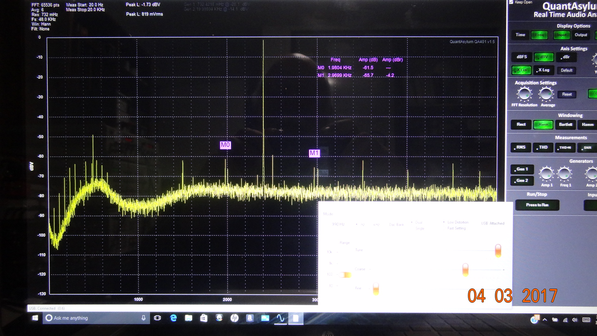

For example... here is calib with -80db tone added to a 990Hz tone at 1v rms.
I take two gens and mix them with passive resistive divider --- measure each level at analyzer etc.
You can see it as well as the harmonics of Davada's newly designed generator at 990Hz... In the -140's. -160 floor.

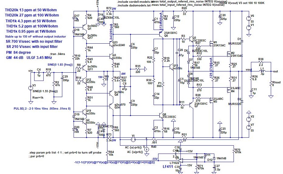

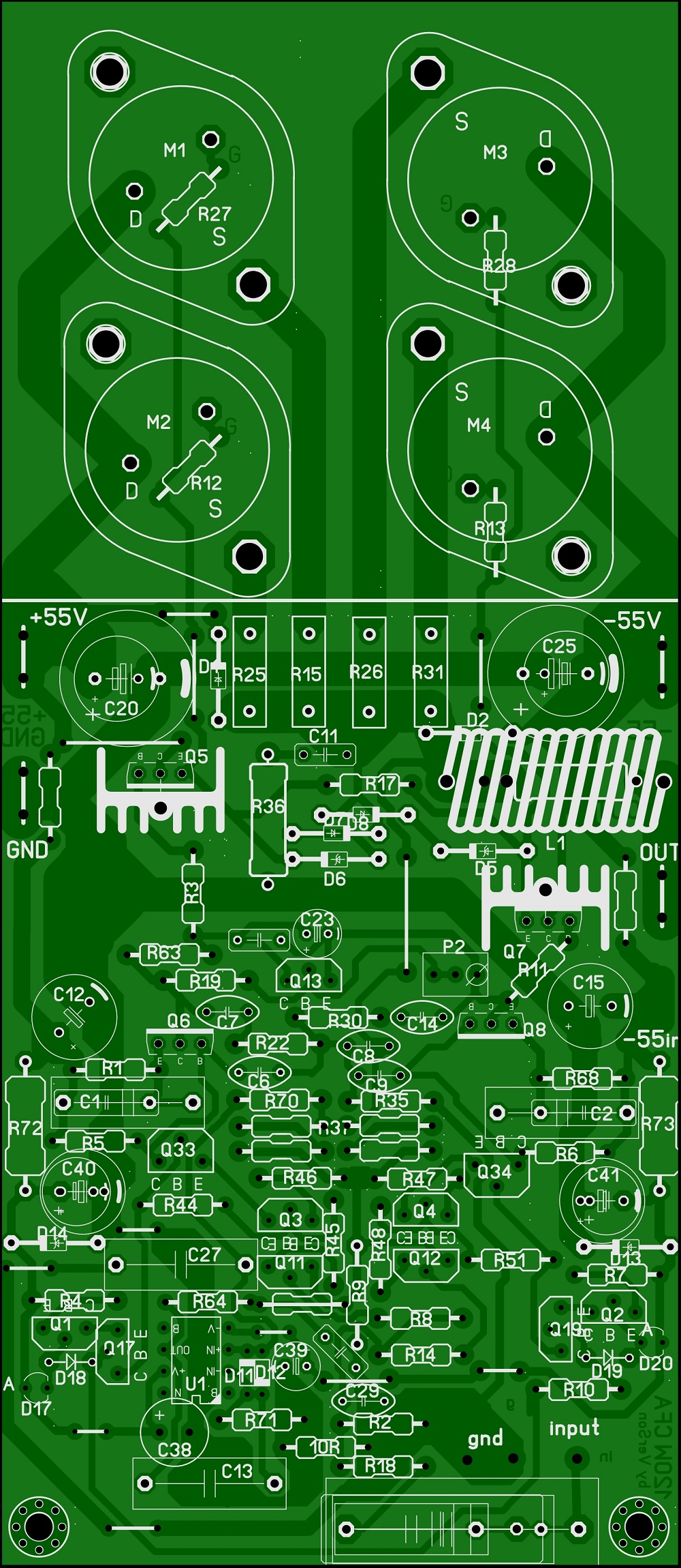

Wile I am waiting for 200W CFA boards to arrive I found a time to finally finish my 120W CFA with lateral mosfet OPS. It was waiting to long time, I don’t have excuses not to finish it earlier.
It is simpler version of 100W CFA with vertical mosfet OPS, no enhanced VAS, simulated distortion is of course higher but still low enough. To my ears it sounds very good. And yes it uses same tape of the compensation I use now in all my power amps.
Attached the gerbers if someone is interested. Sorry for elongated shape, I designed that way to accommodate it in to chassis I used before for JLH 80W mosfet amp. I even left the original JLH voltage regularor, but used only +-55V output.
Damir
