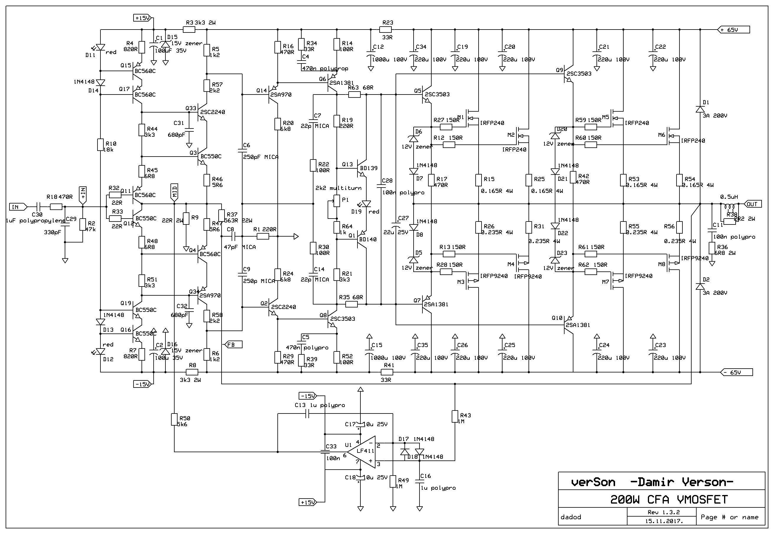

The are only very small changes in the schematic as reflection from 100W version where is no changes at all.

Who said low threshold voltage V-FET, IRFP240 is not of that kind and yes it's much cheaper.

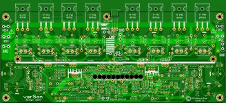

This is the layout.
And this is the BOM.
As I can order quantity in steps of 5, and there is 14 interested, I will risk and order 20 pcs.
I will offer the main board and small feedback board for 46 EUR each plus shipping if this is OK.
