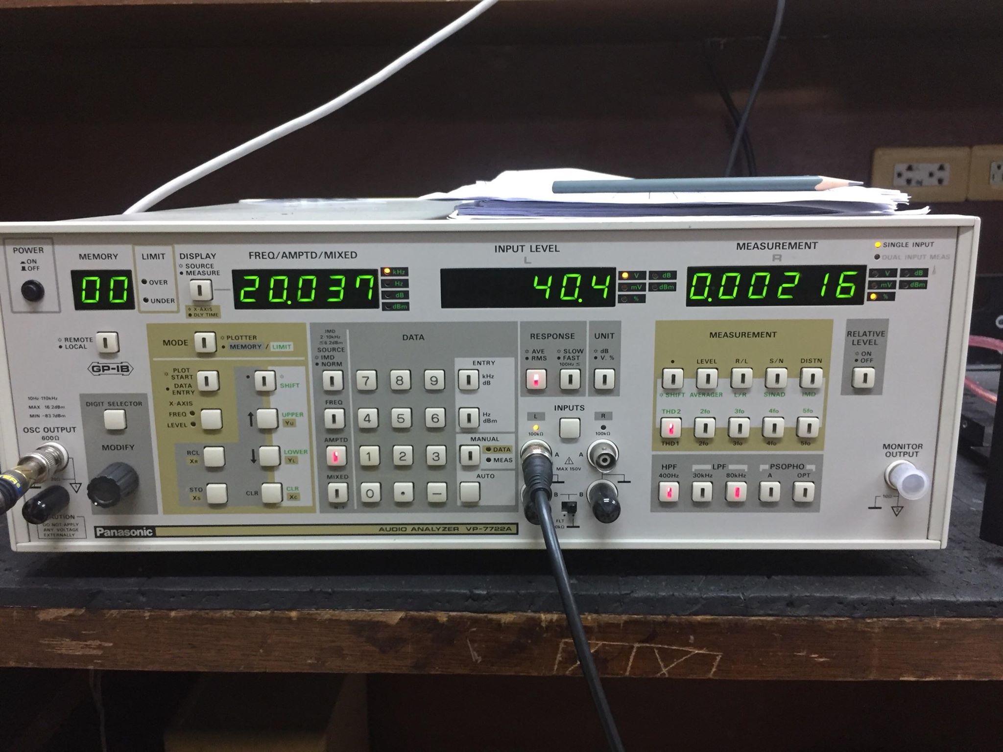

Hi. The 7723 wont go low enough. I used to have one. The test shown is THD only. 2H and 3H only --- nothing seen of higher harmonics. Average... not rms. 8 ohm load.
The EC works amazingly well at all levels and loads and freq. Works extremely well with CFA characteristics.
THx-RNMarsh
My vp7723d can measure below 0.0005% THD+N @ 20khz. Just using the sweet spot of the oscillator output and the balanced input range. Always included is noise which is of course also important to get a feeling of the overall performance. It is nice to be able to measure a specific harmonic with the vp7722.
With the vp7723d residual output displayed on a spectrum analyzer you can see in detail all harmonics and noise distribution.

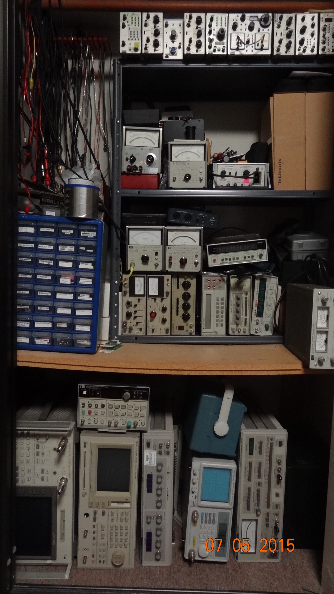

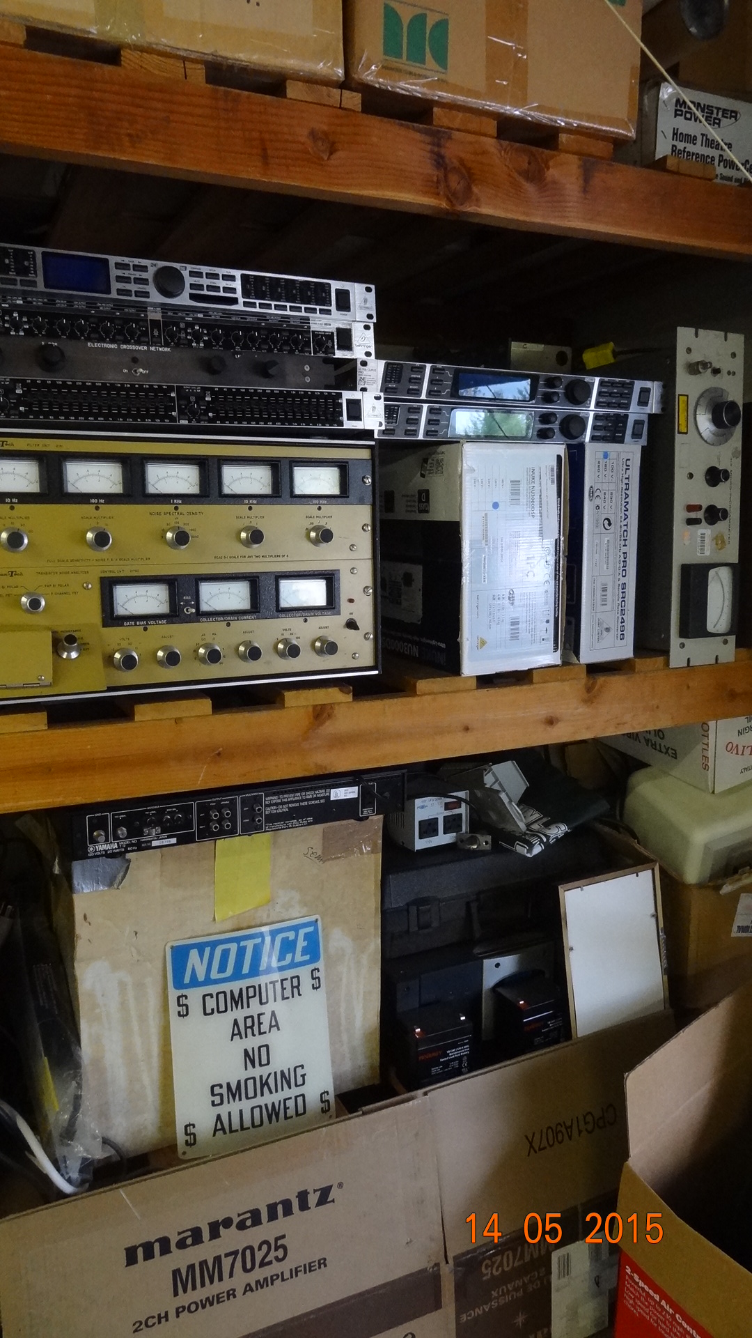

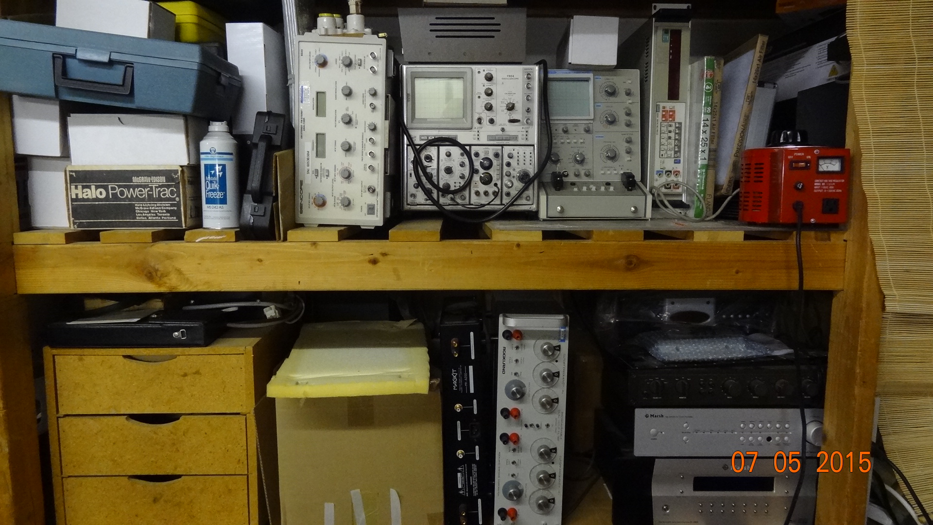

Most of the time and especially at normal listening output levels, the THD will be well below .001% and often below .0005%. So, you are marginal....... I use 3 instruments ... as the need gets lower and lower in THD/Harmonics.... VP7722, Audio Precision 2277 and the ShibaSoku 725D.
With the 725D and an FFT on its monitor output, -160dBv can be read accurately.

Could you measure the 1W, 50, 100 and 200W@8R performance again using the THD+N function of your VP7722 with 80 kHz bandwidth filter activated. No 400Hz filter active. Using 2x60 - 2x62V stabilized power supply?
Just as reference because our measurement results are different. My results can be found by the link in post #1 of this thread.
Thx in advance, Toni
Wow: -160dbV are 0.028 µV Really? 🙁
