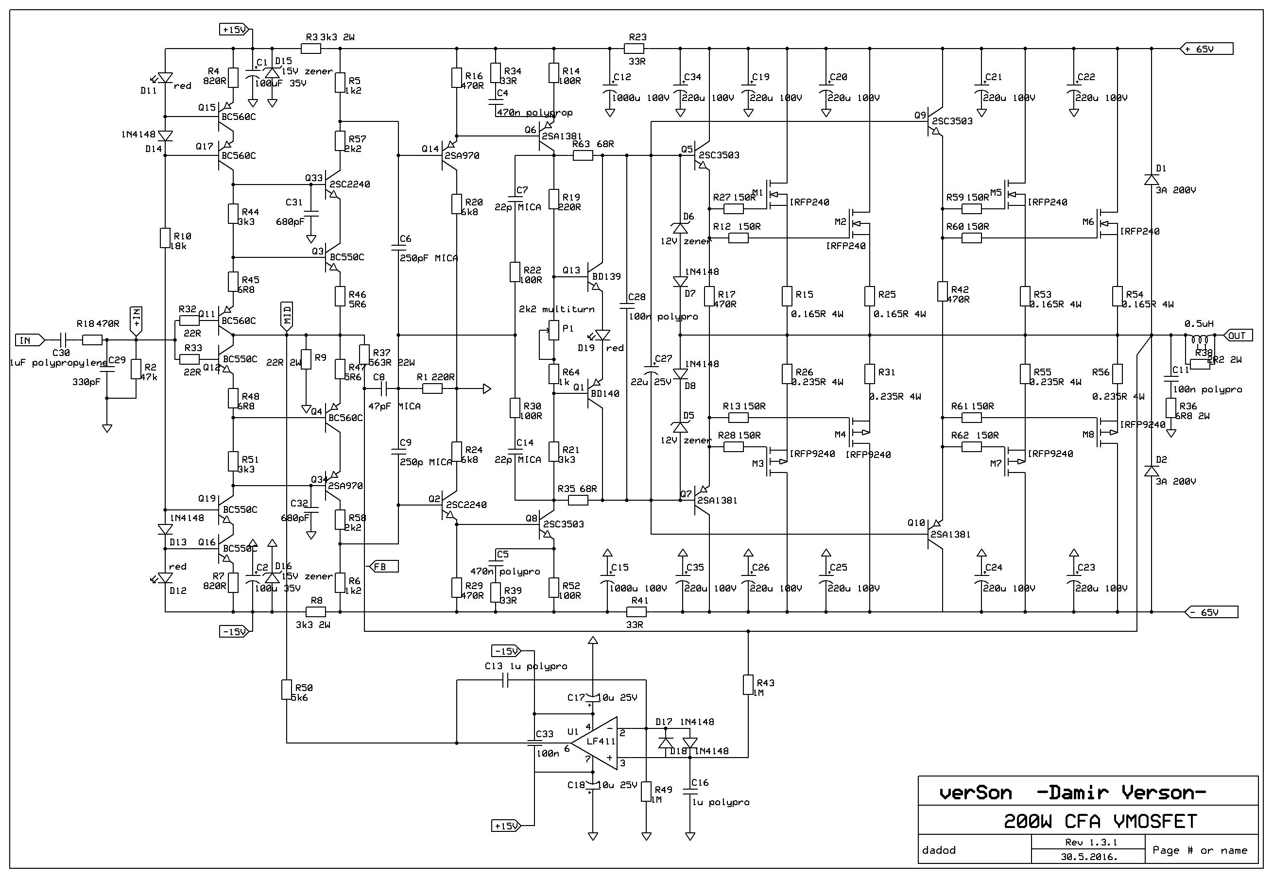

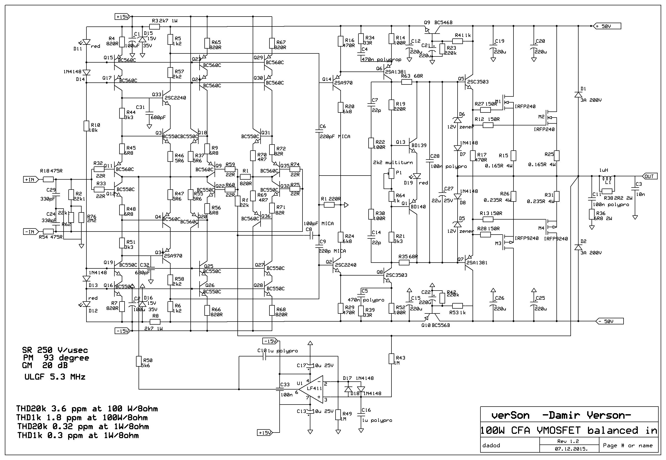

Correct me if I'm wrong, but I would like to highlight what seems to me as a biasing error on input transistors Q11 - Q12.
In order to obtain minimum THD for a silicon Bjt transistor, a Vce voltage of at least 1V ("knee voltage") is needed.
If Vce < 1V the collector-base junction is not properly reverse biased.
|Vce| on Q11 is equal at |Vbe| on Q3 (voltage drop on R45 and R46 is negligible) .
Similarly |Vce| on Q12 = |Vbe| on Q4.
So |Vce| on Q11 - Q12 is about 0.6V that is less than 1V.
I know that THD is very low in LTspice and amplifiers built according with this schematic work fine, but there might be room for further improvements.
What do you think?
Are Q11 - Q12 biased on saturation zone?
Thanks!

Q11 with Q3 and Q12 with Q4 are so called supper pairs. This is not only simulated amp but built and measured with very low distortion. Try to read more, there in this thread are some measured result for 200 W version.

I've already specified in my previous post that I know that there are real amps built with your schematic and not only simulations on LTSpice.
I've also seen THD measurements on two assembled amps.
If I correctly remember the same super pairs configuration has been used in another schematic posted by a diyaudio's member (Manso?), but I never seen this particular configuration in other schematics.
I've seen instead many cfa amps with input transistors in a diamond configuration with collectors connected to rails power.
Sorry, but I didn't know anything about super pairs configuration.
I'll try to find some info on the net.
Many thanks!

This one:
http://www.diyaudio.com/forums/solid-state/243481-200w-mosfet-cfa-amp-78.html#post4309544
Q11 with Q3 and Q12 with Q4 are so called super pairs...
Hi Damir
I am interested too because this use of a super pair is new to me.
Usually the front transistors just act as level shifters, diode connected - or sometimes actual diodes are used.
I haven't simulated this yet but I expect you will have, does the super pair connection actually make much difference?
If it helps then I would expect the IC people would have some examples, is it used in any other amps?
Or is there any reference for it?

Hi David,
There was some discussion about super pair on some of the thread, I don't remember were. It is called Baxandall super pair or Boxon, but Walter Jung documented that even before there was explained by someone else, don't remember. As you said there so many post not easy to find something specific.
I prefer super pair over diamond
I use supper pair in my GainWire mk2 and mk3 and I like the sound.
Best wishes, Damir

Yes, I have seen the super pair (or Baxandall pair) before, just not used as the input to a CFA.
It looks to me that the front transistors would basically function only as level shifter in a CFA, but that's without any analysis - just first impression.
One more simulation to do😉

Anyway the schematic is at page 78 post 775, the same that is linked on the first page of this thread.
In the meantime I've found this thread about Baxandall Super Pair:
http://www.diyaudio.com/forums/solid-state/166306-origins-baxandall-super-pair.html

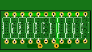

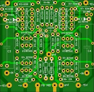

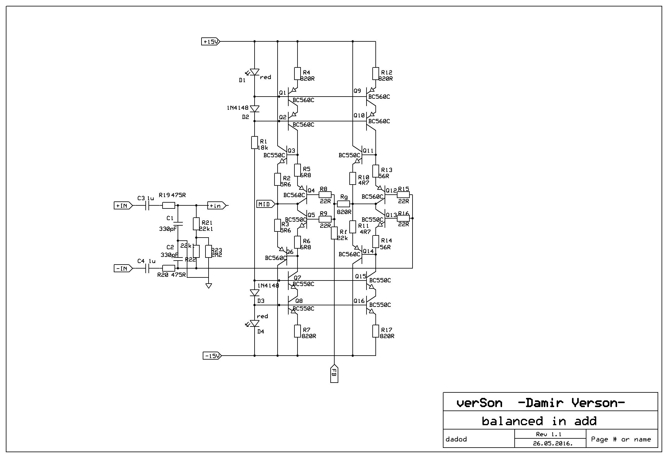

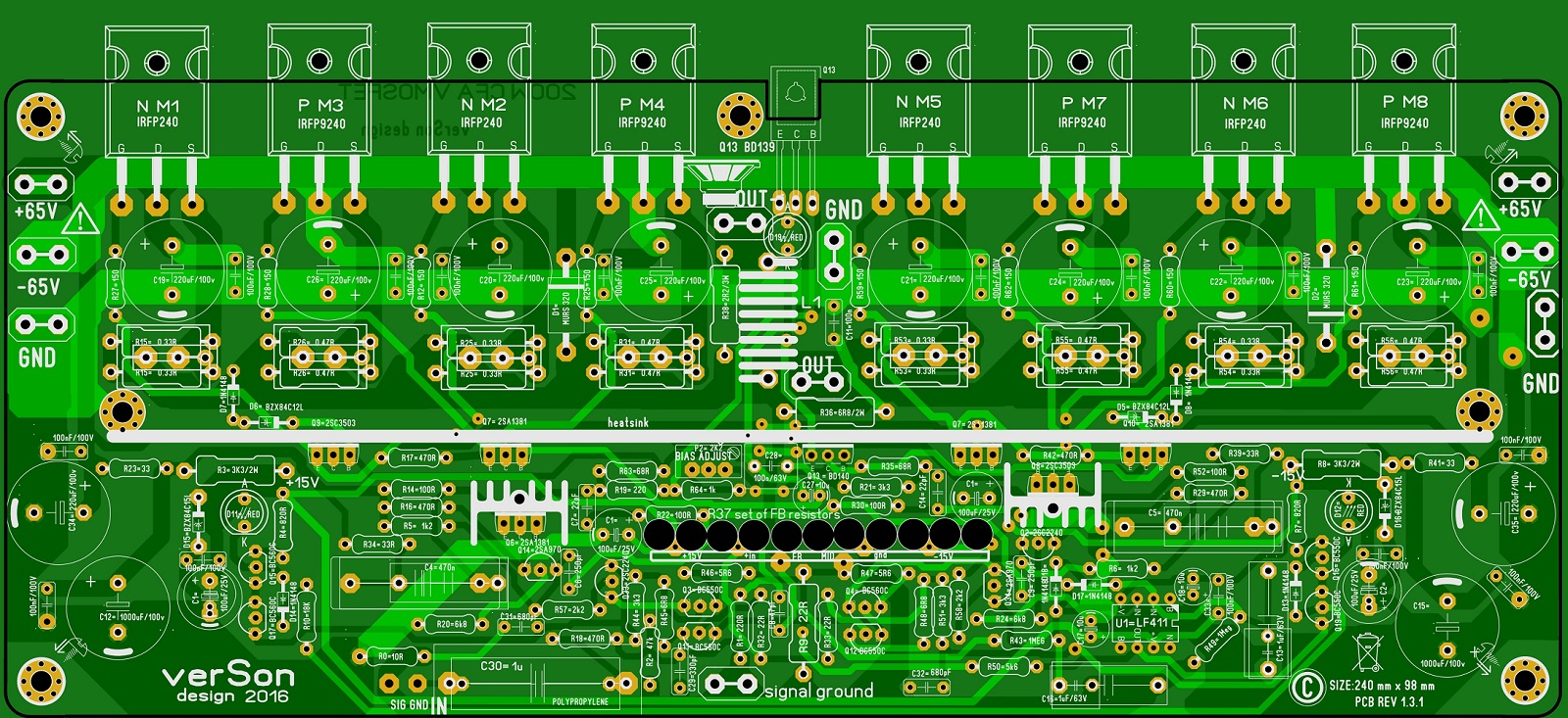

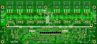

I would like to offer 200W CFA version to interested ones.
This is actual version Richard March measured some time ago with some overload protection and layout improvements.
I made layout with possibility to have three configuration.
1. pure CFA with two way how to connect the feedback resistors, parallel or series. As this quite powerful amp some power dissipates on the feedback resistor, that's why parallel or series combination. The serial combination overcome resistor voltage distortion but have longer feedback path.
2. By adding a buffer to the - input this amp is transform in to VFA.
3. Adding one more buffer it can accept balanced input.
Here are the schematics. First one is of the main amp board and second one is the piggy board used instead the feedback resistors boards.
Here is the layouts of the main amp board, two piggy feedback boards and VFA and balanced input board.
