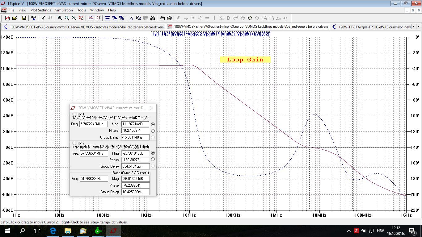

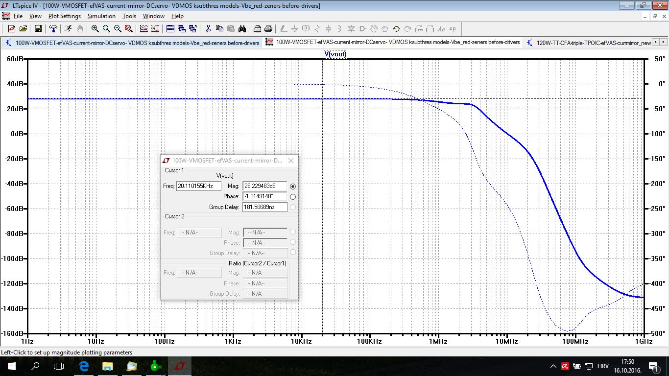

This is 100W CFA with Input Stage active load (current mirrors) and even lower distortion, below 1 ppm at all frequencies and all output levels . The Loop Gain is about 95 dB at 20 kHz, and I don't know any amp of any technology with so high NFB up to 20 kHz.

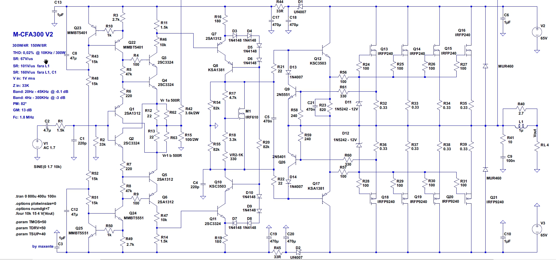

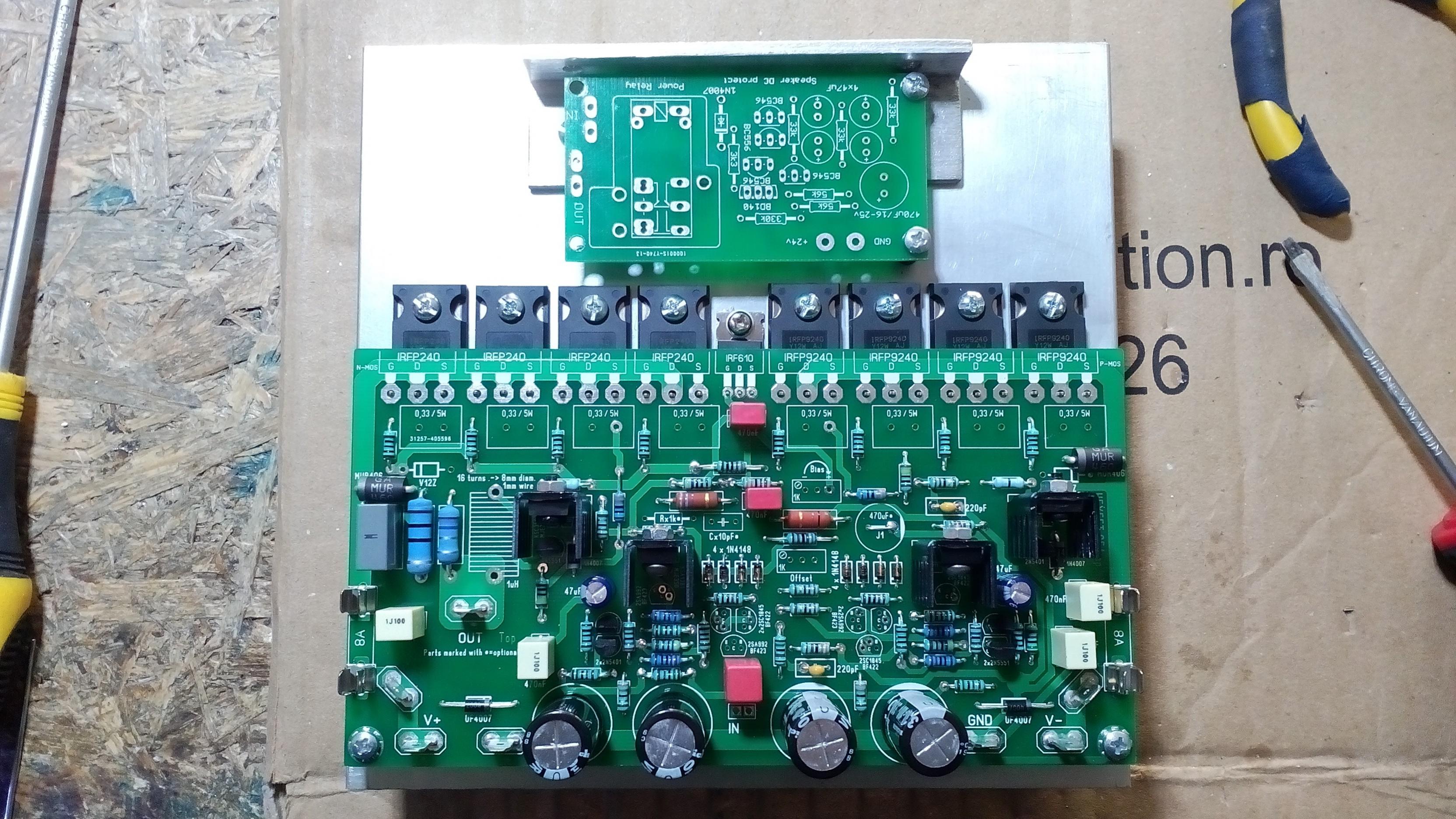

My version of mosfet CFAmplifier
If there is no problem, i would like to post here my version of this amplifier
