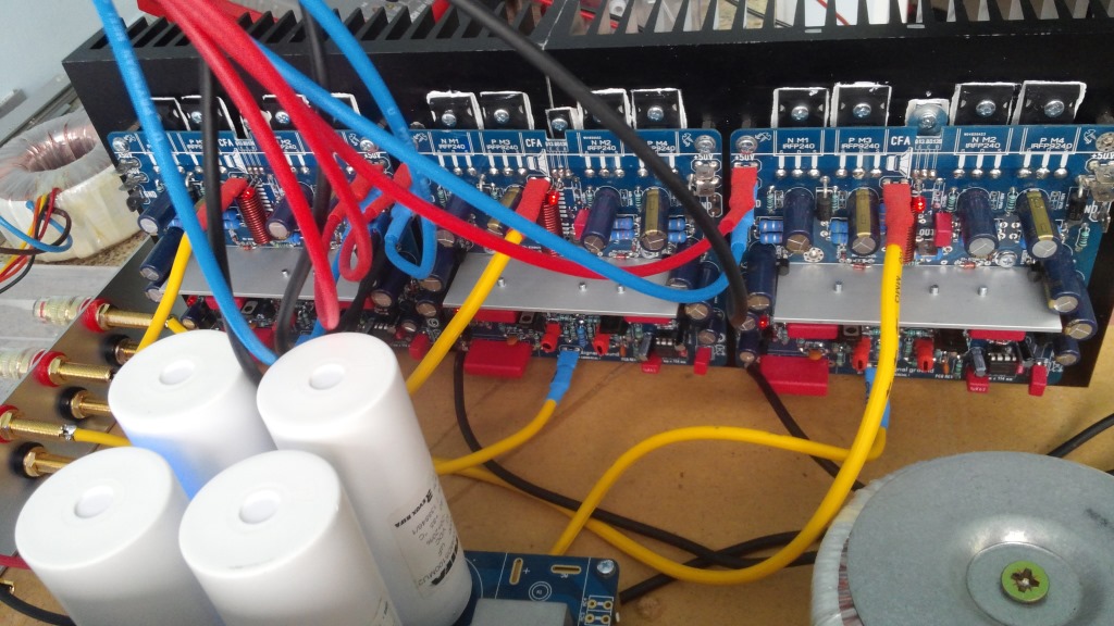

Finished 100W version with two PS Regulators, similar to dual mono.
Singing beautifully.

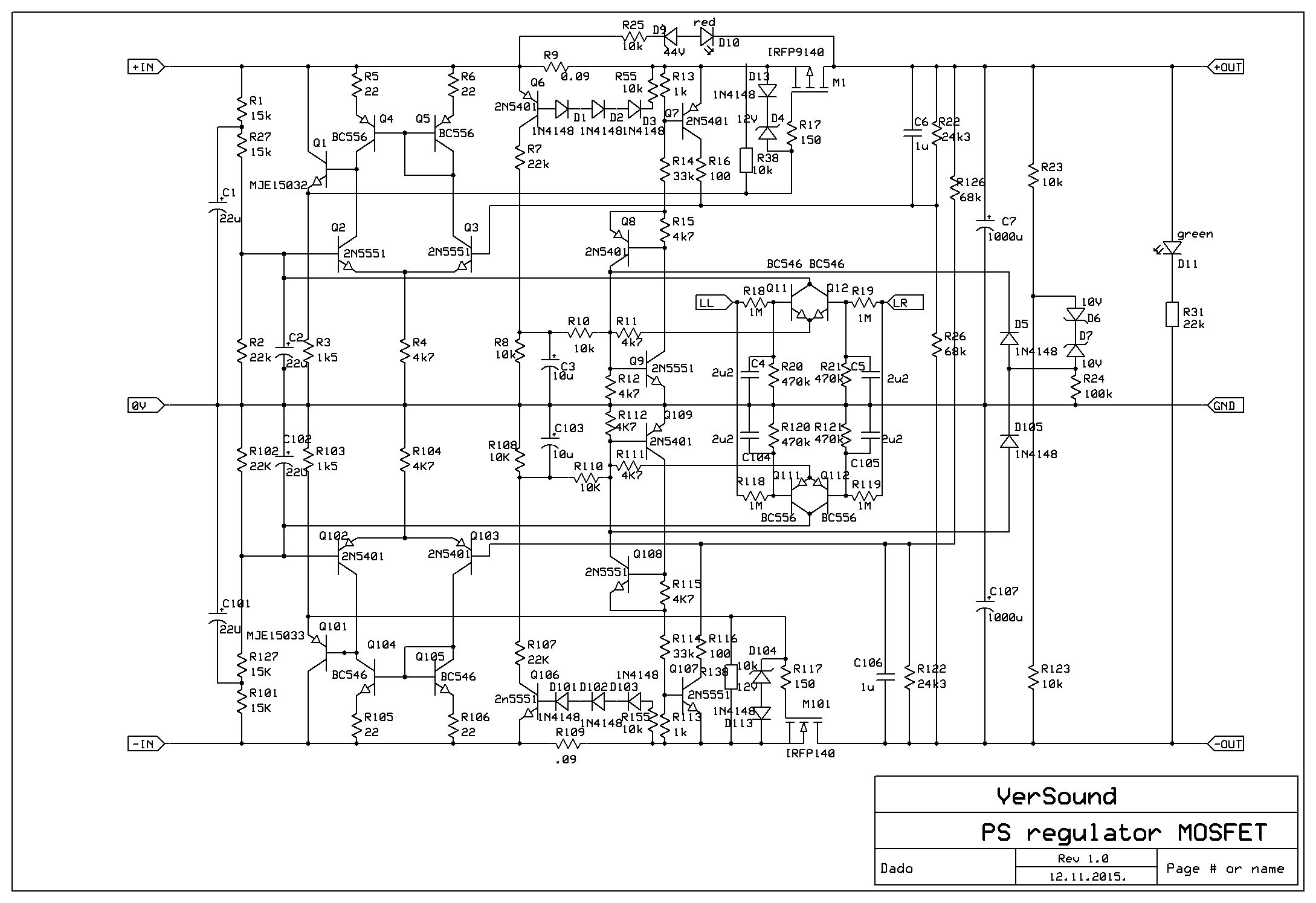

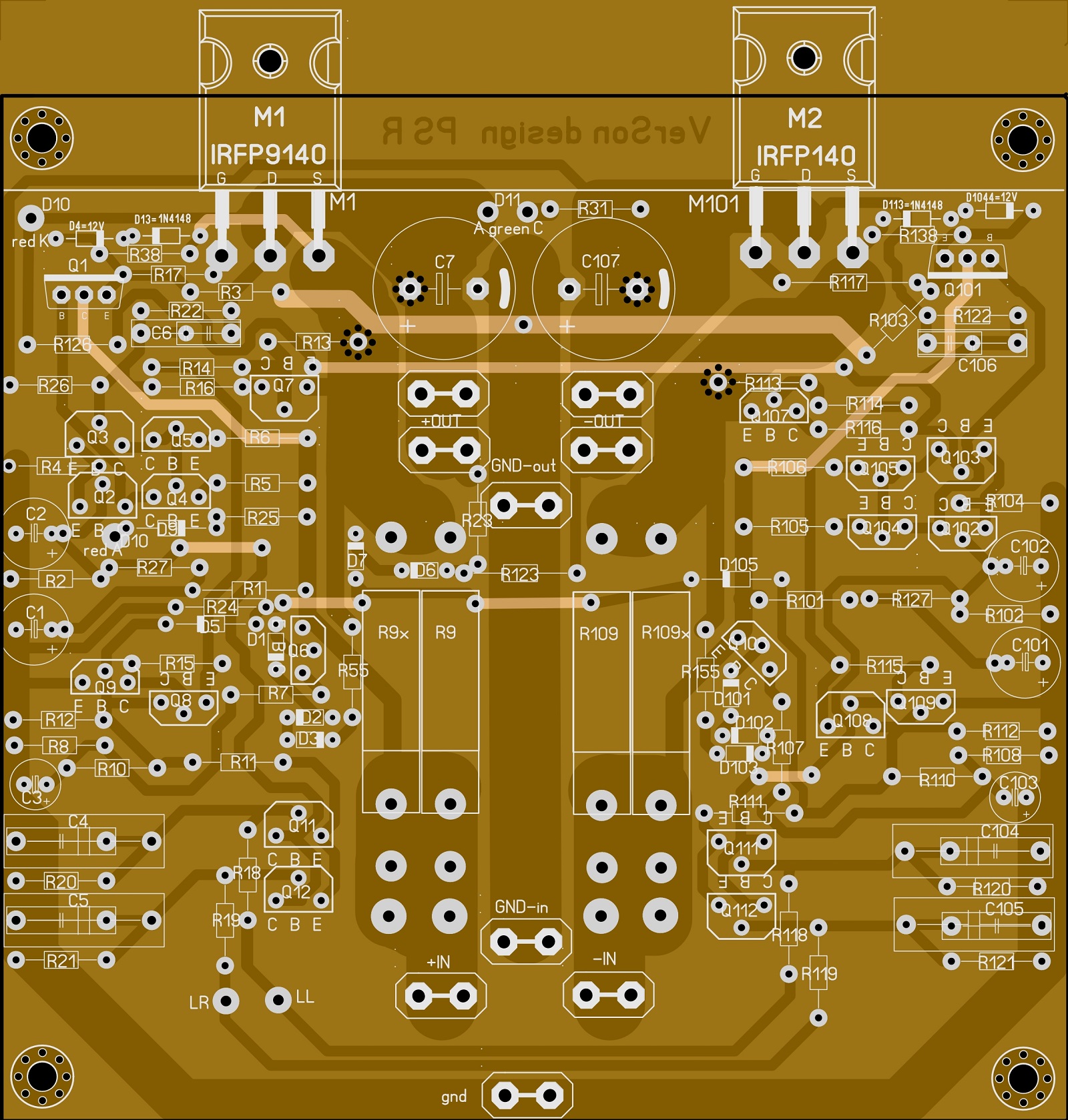

I have designed higher power version of the PS Regulator and it uses a MOSFET as regulating transistor.
It uses IRFP140/9140 MOSFETs and can source up to 20 A before electronic fuse was triggered.
I would need two of them but as the PCB order cost less in more quantity I would like to hear if more interested for double side PCB, dimension is 120x115 mm.
Damir

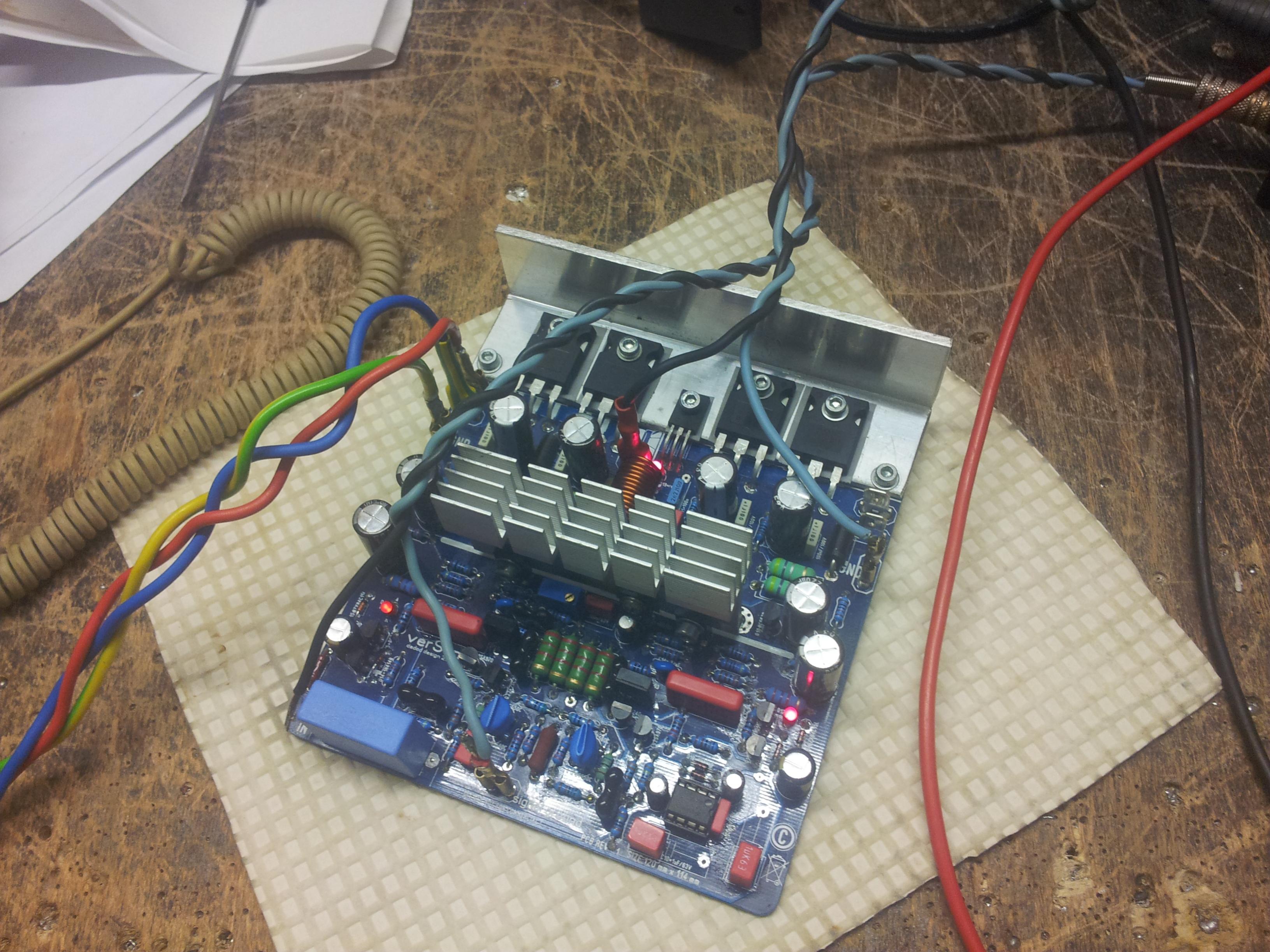

Hi Dadod.
Amplifier works.The sound is fantastic.One of the best.Bias 100mA ,dc offset 2,8mV
CFA 100W DAMIR and SLEWMASTER OPS 2pair BJT-IPS Krypton and NX amp are best amplifier I have heard.
Damir, I thank you for the great amplifier...
I am glad you like it.
You can try with somewhat higher bias of about 130 mA, and tell if there any sound different.
I can see that you stil use metal oxide feedback resistors R37/R9( if I am not wrong 5%), better use metal film 1% there.
Now is time to replace my old Rod Elliott (ESP)3A project amplifiers with new Damir CFA's. 3 channels are ready for test for my active 3way speakers. Bias is adjusted to 140mA. I recommend to put amplifier on heatsink before adjusting. Sound is absolutely perfect, no noise, no hum.
