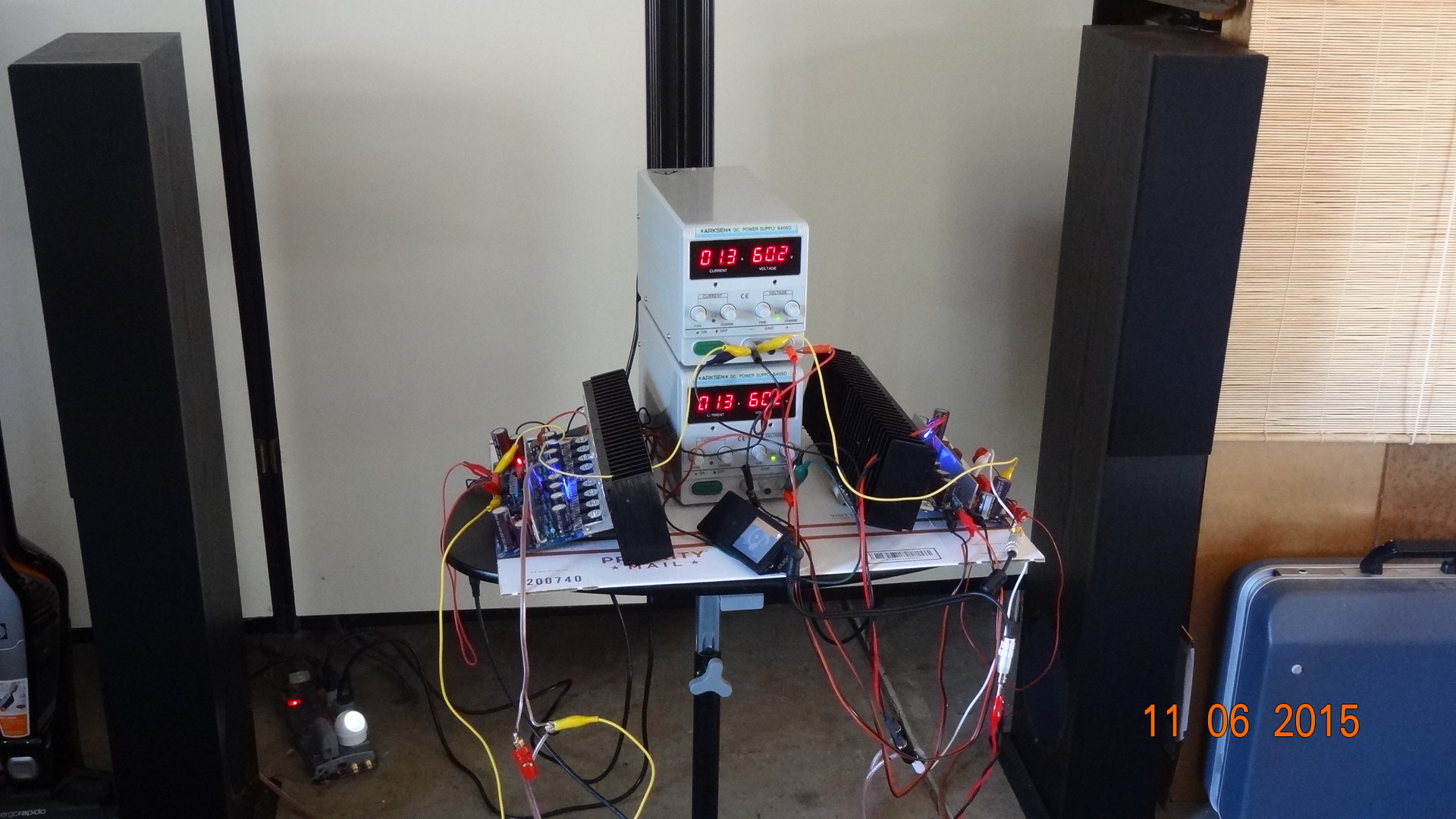

I'm not sure if I have the latest amp changes you just mentioned above.... but when connected to heat sinks and speakers, it is extreamly clear and detailed sounding on good speakers. Great sound stage clarity. The quality of the sound really comes thru. Now I will have to listen on even better speakers and clean up the mess of power/ground wires. The transients are sharp, quick and clean.... very nice !! I'm getting excited.
The heat sinks are still too small, though.

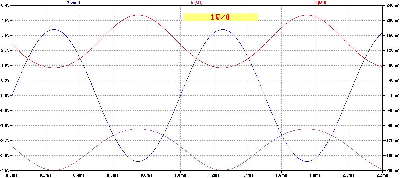

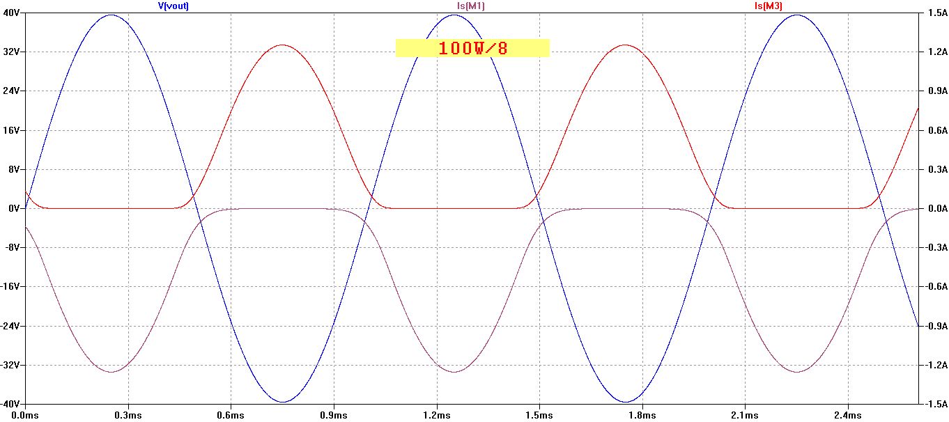

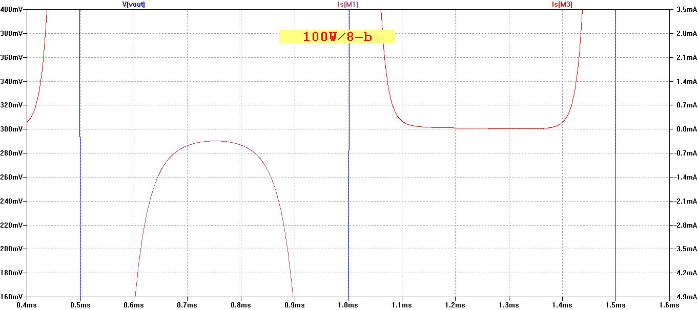

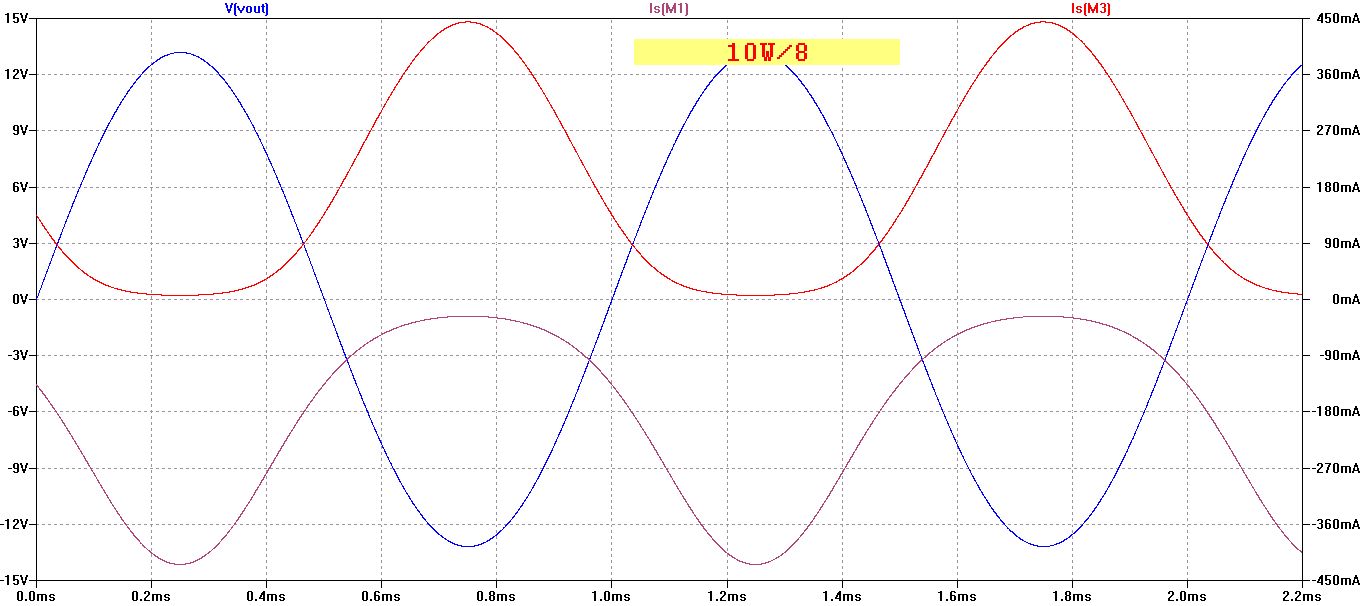

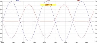

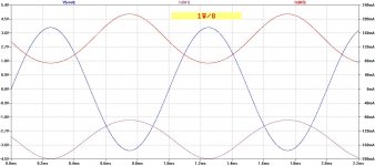

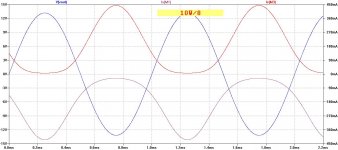

Maybe those plots can explain why this amp measure so good and sound good in the same time at all power levels. These are output HEXFET currents at different wattage, 1W, 10W and 100W on 8 ohm load, simulated of course. Last plot was expanded around zero current to show that behavior better.
Damir

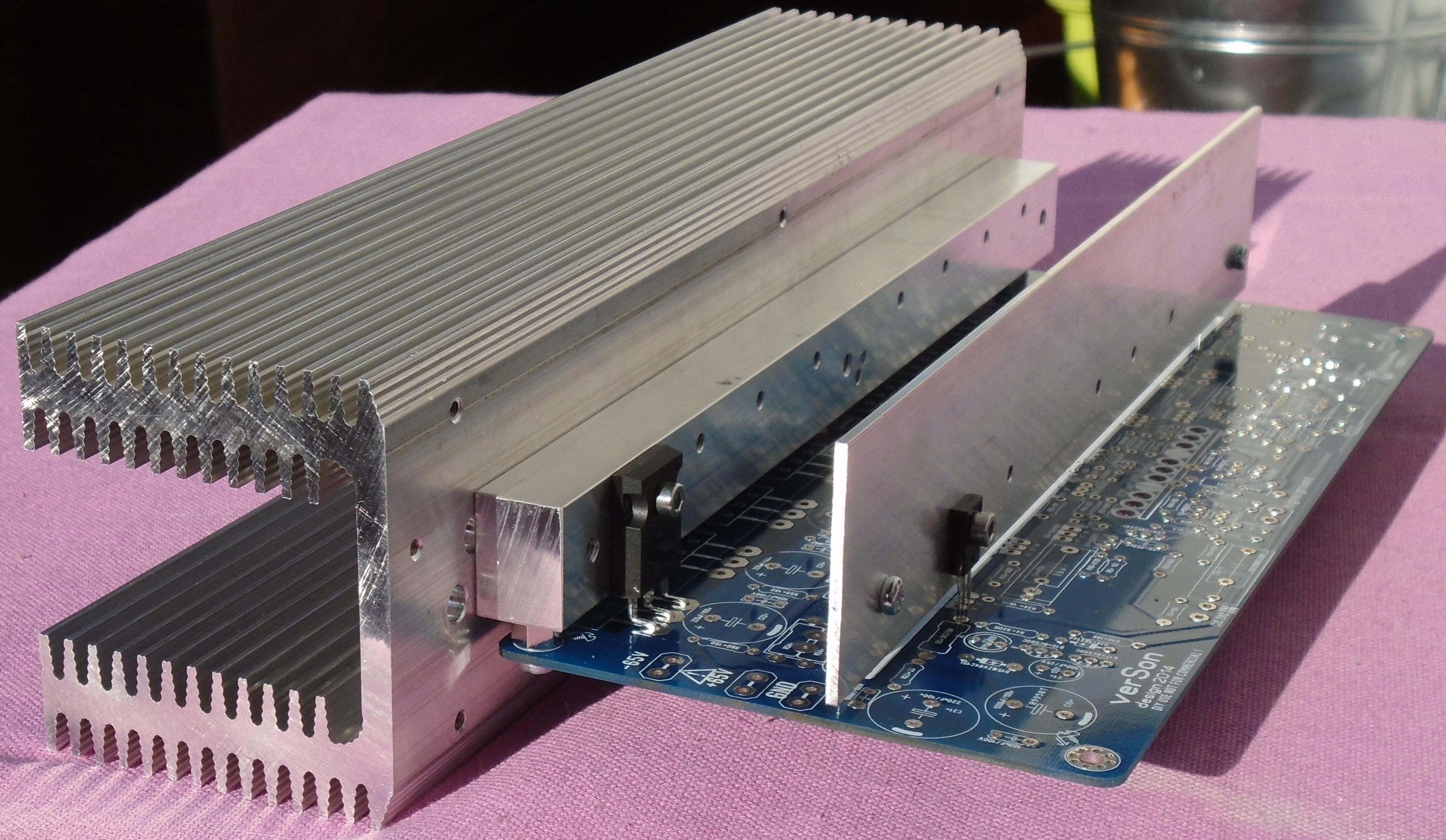

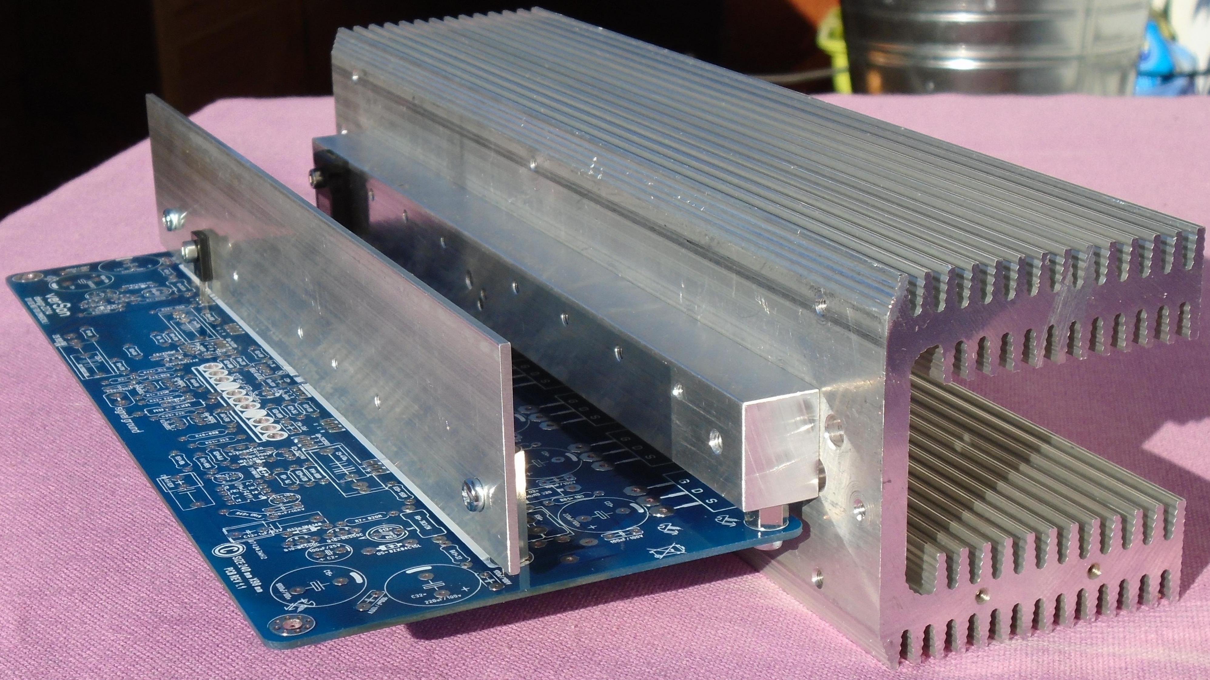

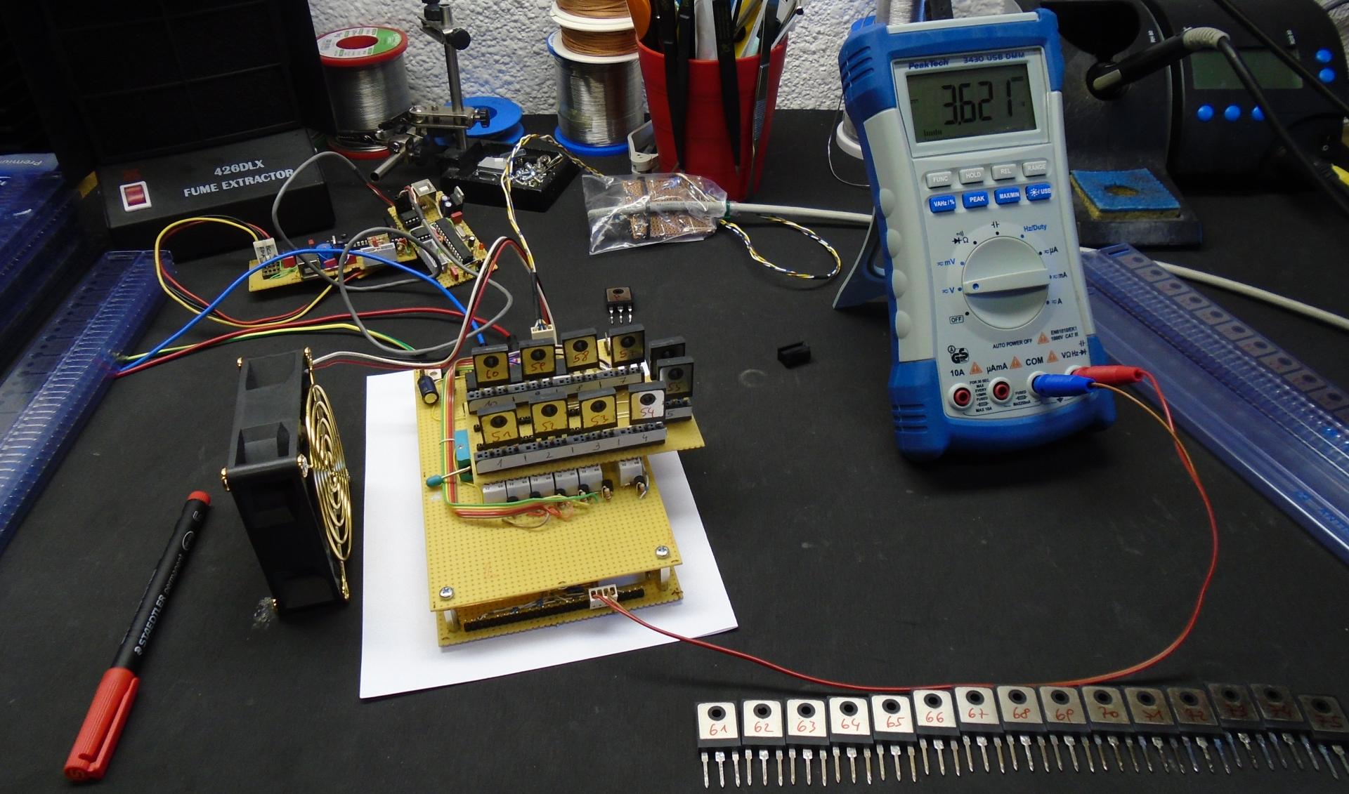

... slow progress, but progress:
Have done some metalwork to build the test sample ...
BR, Toni

Very nice Toni,
I suggest you to start to solder from the input. You can test input part separately then together with VAS and if all works correctly the rest is simple.
You can measure the voltage drop on the Q2, Q14 emitters resistors and if there to much differences (matching not perfect) it can be corrected by changing one of the input CCSs (R4 or R7) current.
BR, Damir

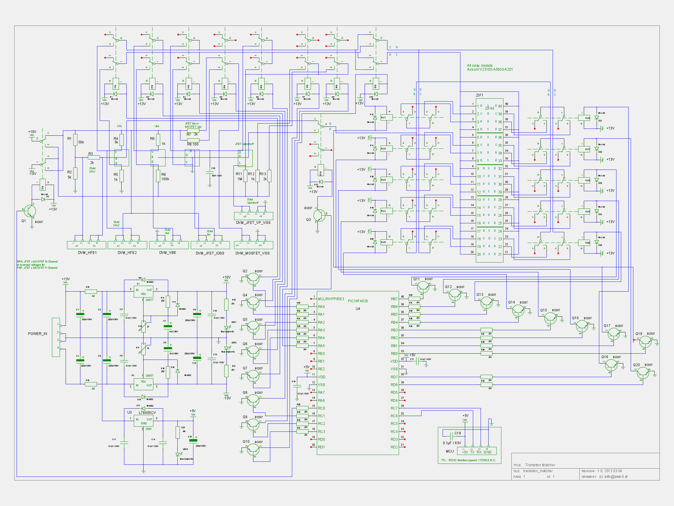

Please share your schematic for the matching, I am currently building a hfe and vbe matching tester, similar to your with the same construction techniques. Great Minds Run Together...
Voila ... a bit off topic. I do not want to pollute Damir's thread. So if there is more interest maybe you open a new thread.
You need up to 3 multimeters with USB support to automatically read the measured voltages. Schematic is pretty useless without homebrew PIC software and homebrew pc software (perl script to control relay board and read and convert raw voltages from USB multimeters).
BR, Toni
