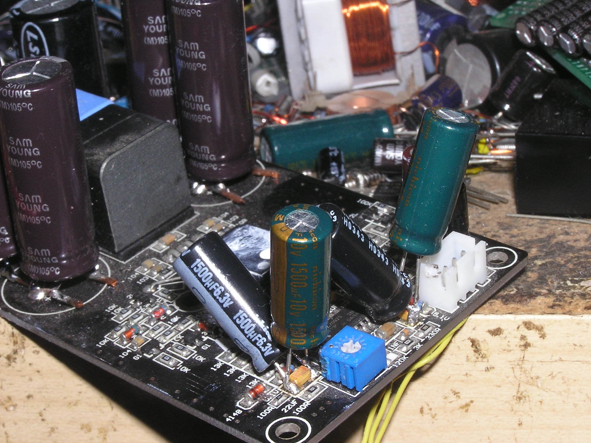

It got the best of me and I pulled out my prototype case and started to set one up..
Now going back through the wiring to figure out which is which... Will start with a mains interrupt switch then try to move on to the soft standby mode...
