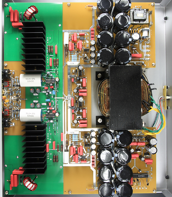

I prefer the traditional way. Such as transformer + large capacitance.(Their lifespan may be same length as the tortoise)
I don't like slice resistance capacitance. I think they are cheap, but the reliability, life and accuracy. Resistance than metal
:D
For example, DSI 225.
Although I don't like the circle inductance, they have too much EMI harm to human body.

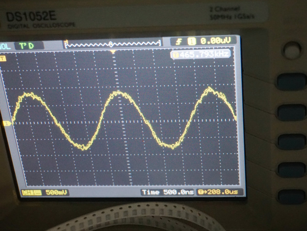

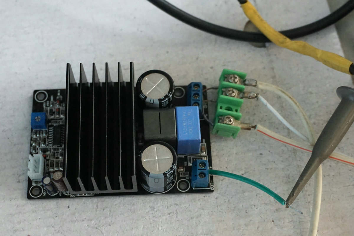

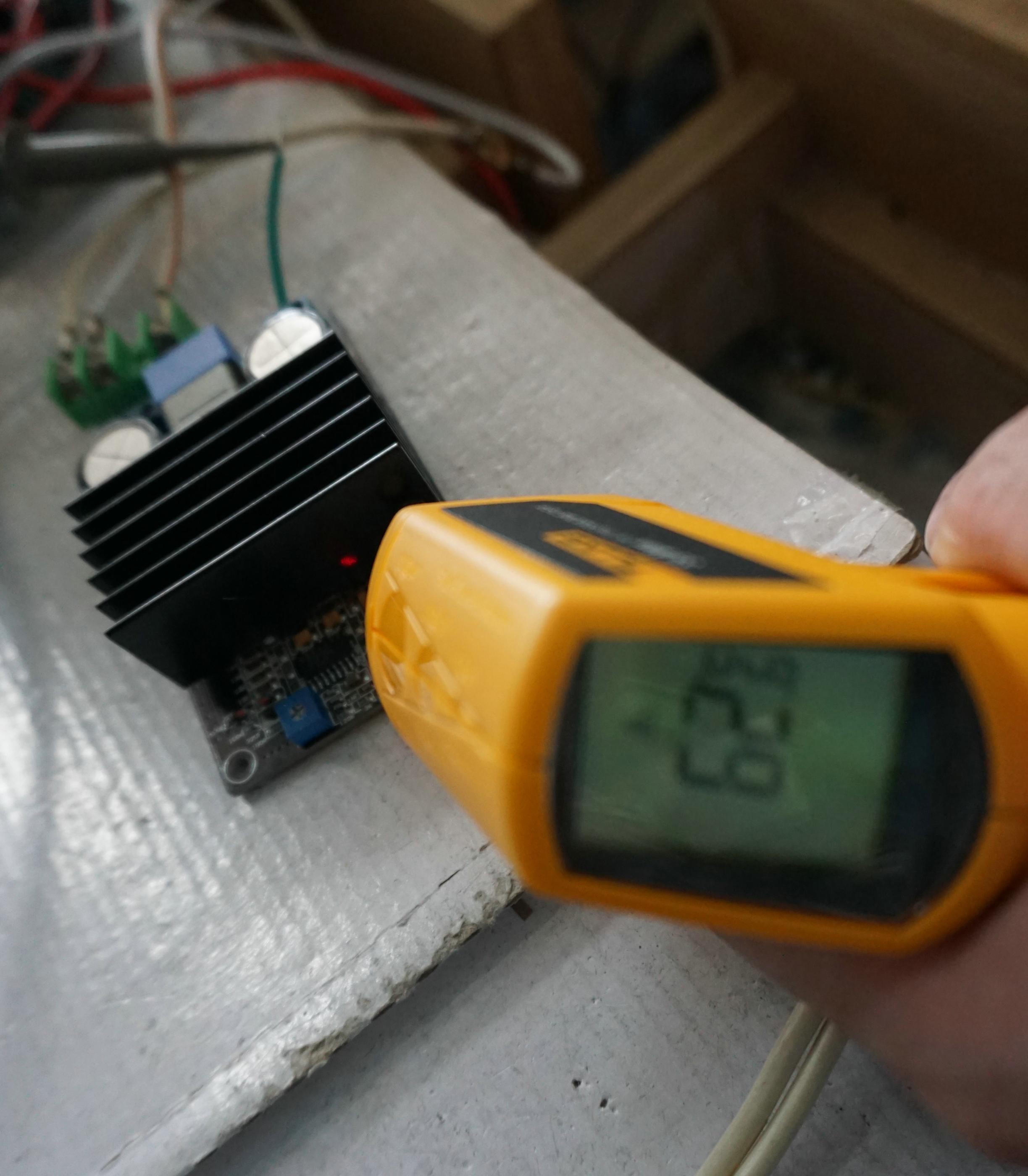

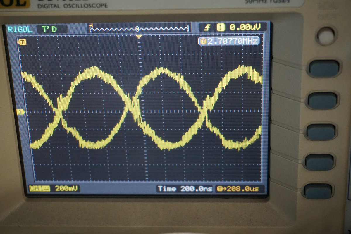

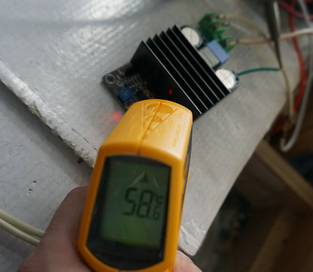

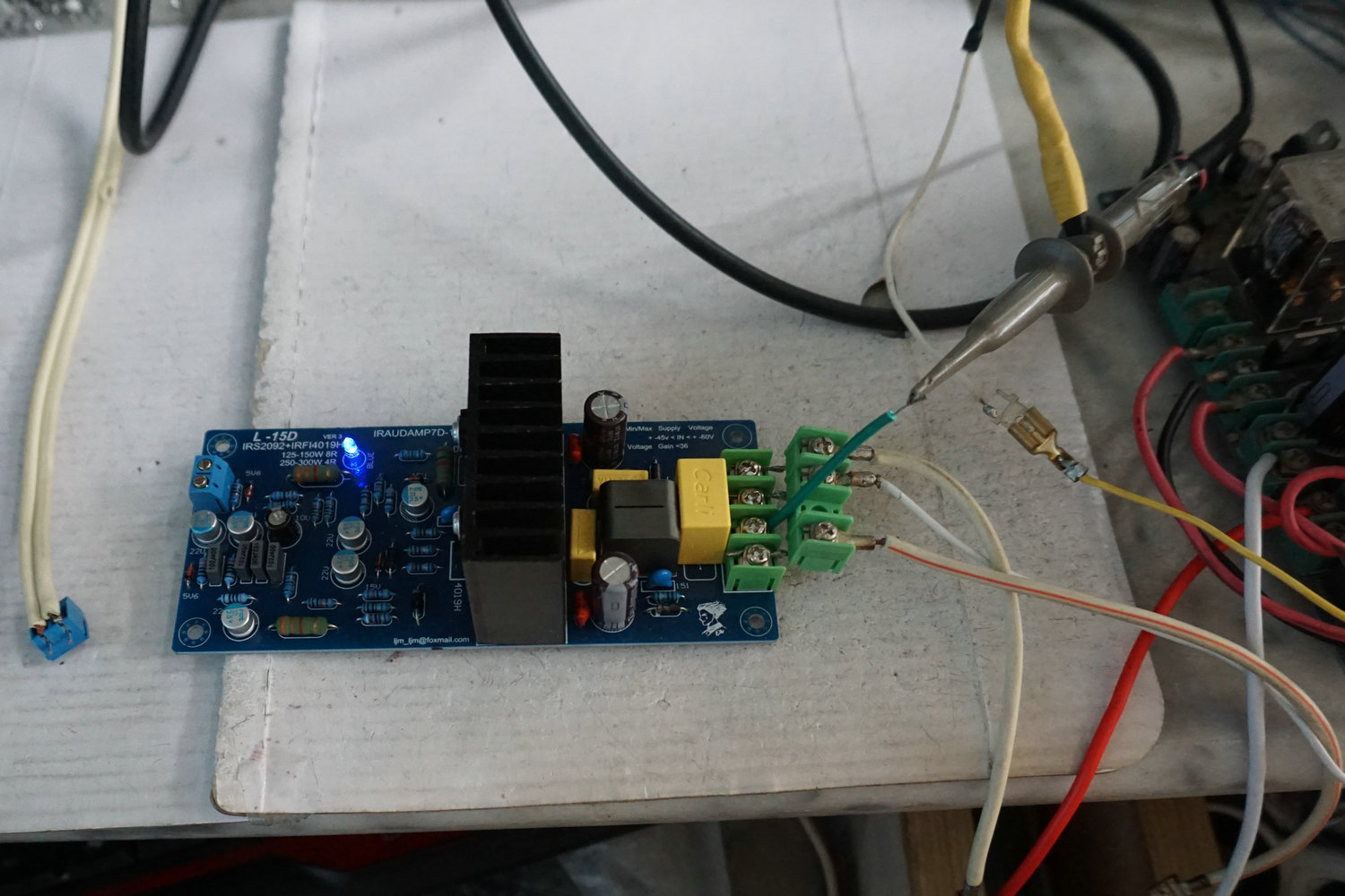

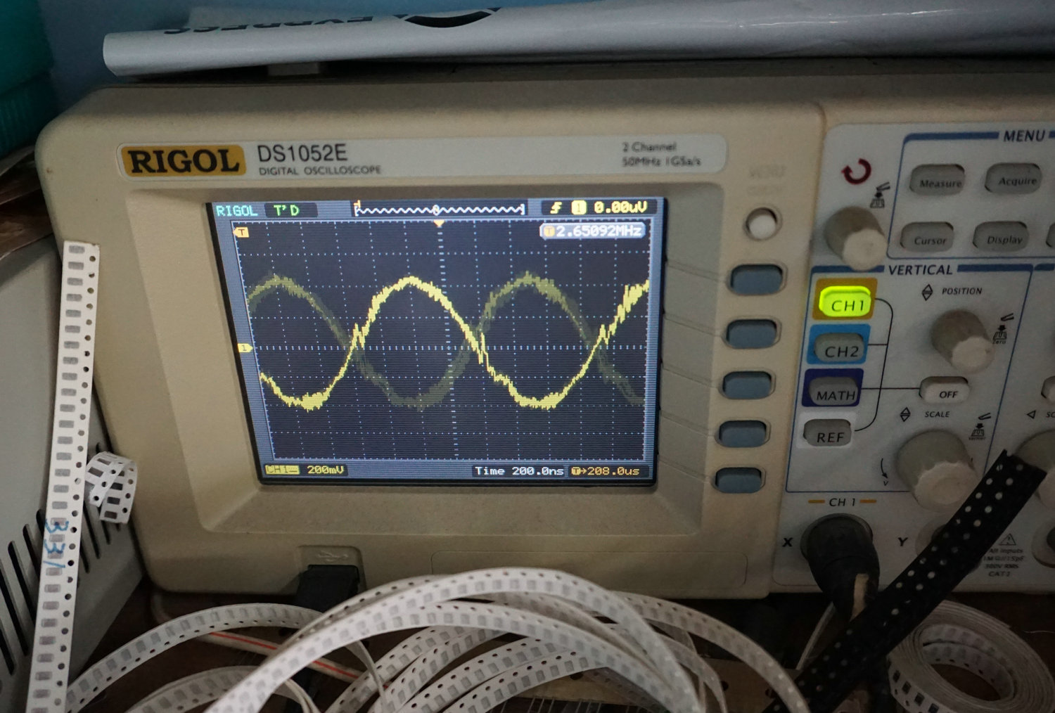

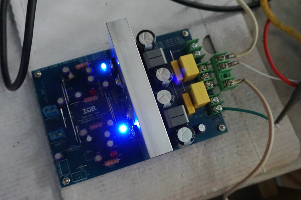

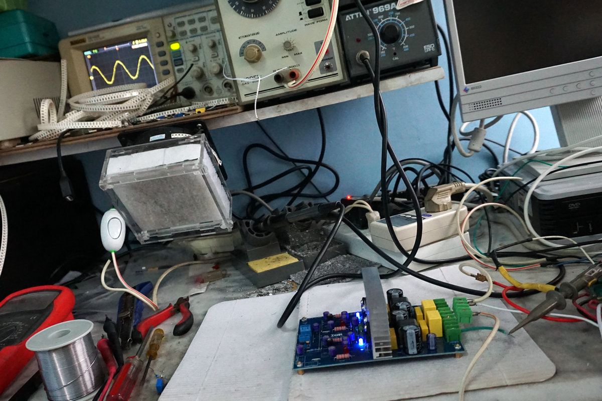

A little busy. Simple test for a moment, and I think the same.
Set as high frequency, measuring OUT GND graphics.USE DC+ -50V
Could not be locked frequency, place 10 minutes after the measured temperature, the radiator about 60 degrees Celsius.
The indoor temperature of 29 degrees Celsius
PWM estimates that about 700-800 k set.
Graphics is a mess, I also can't see clearly.

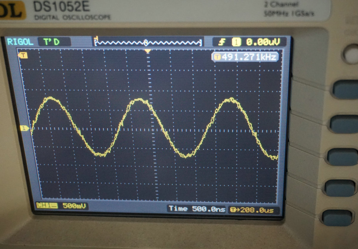

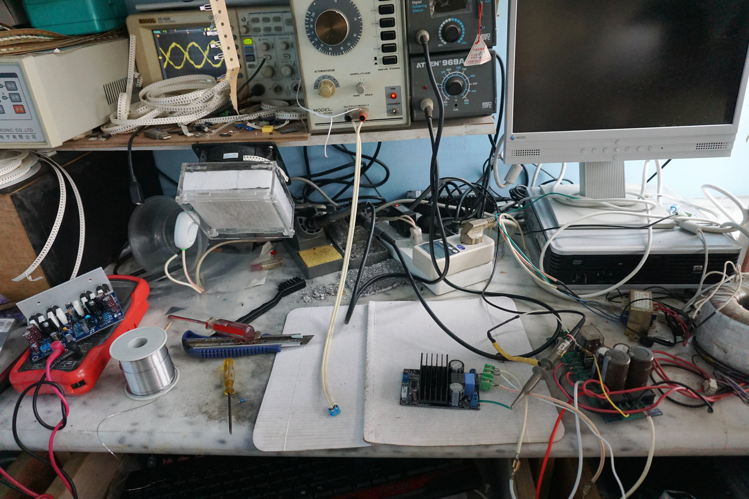

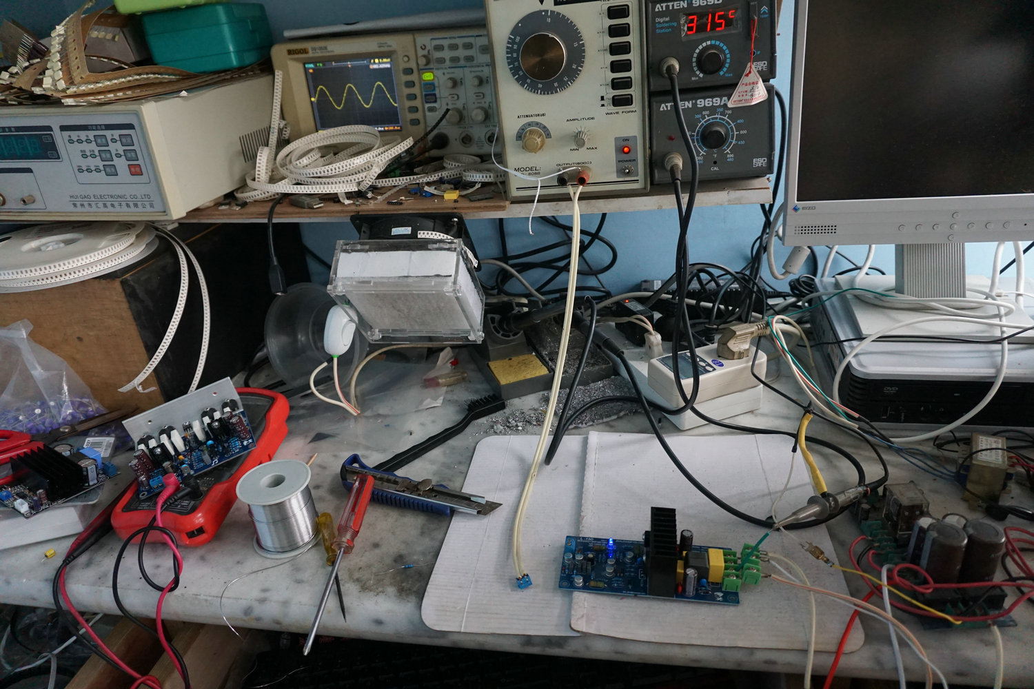

Comparing measurement is L15D
The same power supply, DC + - 50 v
The same test environment.
Probe placed OUT GND position, can very clearly see the 490 k frequency PWM signal,
I like this kind of image it with IRAUDAMP7D basically the same, there is no obvious difference.

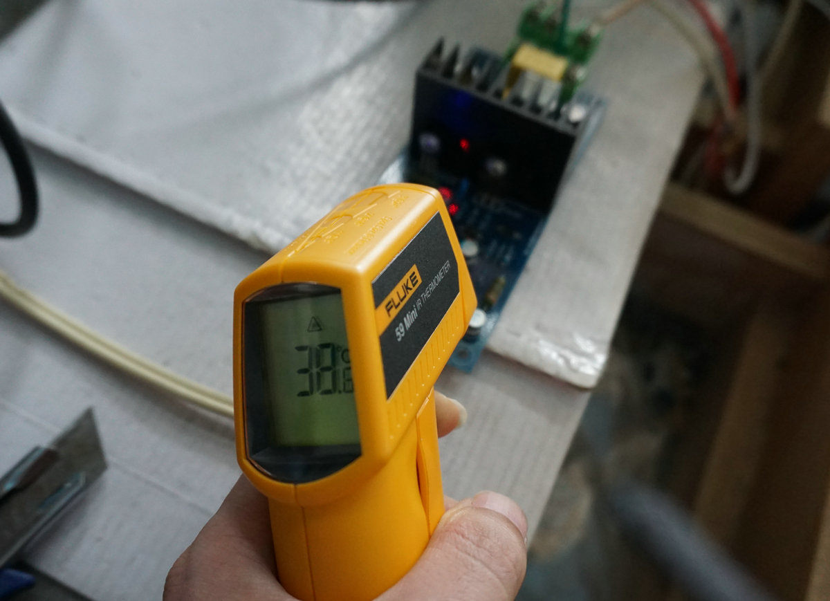

It has been run. For a long time, I hand touched, almost no obvious temperature.
Test the temperature of about 38 degrees Celsius.
It is very beautiful. This is a simple, anyone can do the test.
It can be tested repeatedly,

I don't have the black amplifier to test THD's interest,
Because it and I used to post film version of the same design, very ugly.
In order to reduce waste, I pulled down its chips and MOSFET, and lc.
These parts are still valuable.
The new circuit board will allow them to play a better level

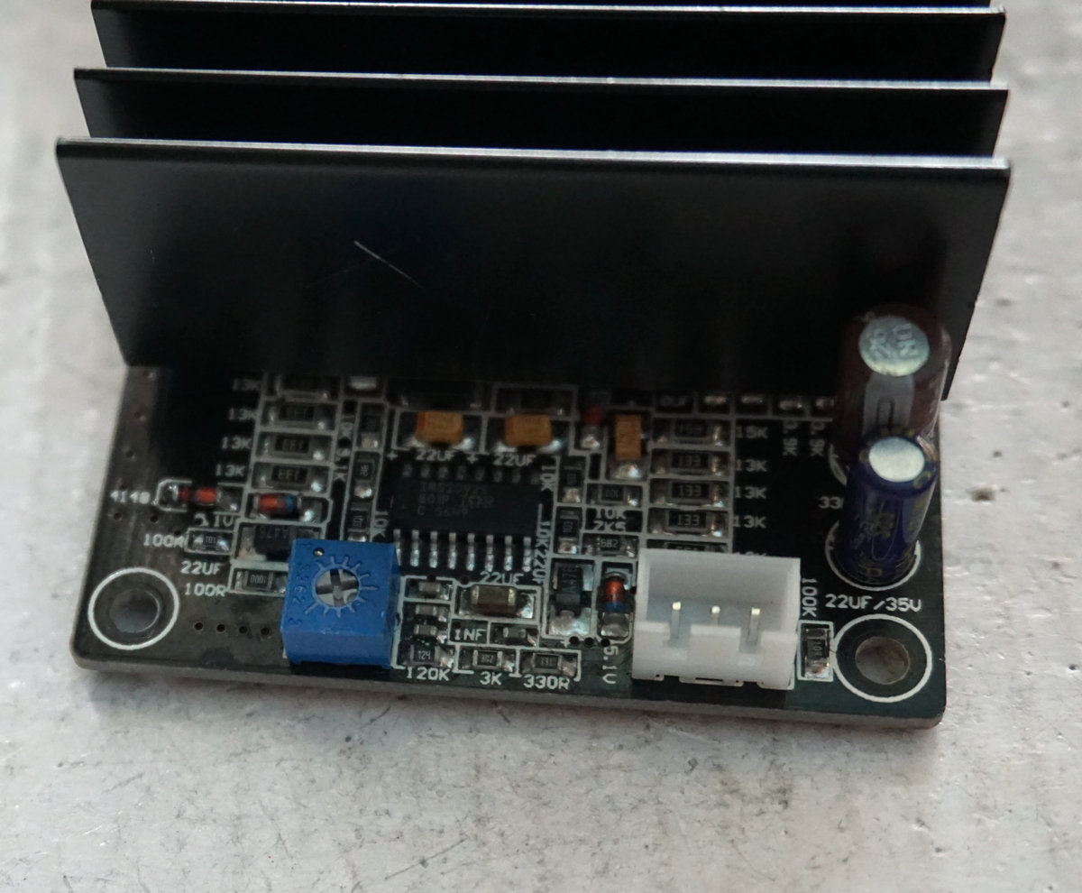

I didn't say it is not good.
The test and no signal input, no audio signal output. No music, no load.
I designed a lot of class D amplifier, but 90% is I threw away. They all have a similar phenomenon.
The PWM frequency processing. As far as I know, DIY digital amplifier by more than 95% this kind of phenomenon.
This a black board is not the worst, it should have a voice.
This is a simple, anyone can test test.
PWM amplifier graphics can illustrate the design is good.
If you are interested, I can take some IR test of the original design of figure, IRAUDAMP7S give it to you.
PWM graphics oscillation is serious, can cause MOSFET temperature increases, the signal distortion increase.
Small pot near input is for adjustment of switching frequency isn't it? Can't the 700-800khz be lowered to 400khz?
After I received a parcel didn't change anything.
700-800 k is my guess, in fact, I don't know how much is the working frequency, because of its graph is a mess.
In addition, this is not the problems caused by frequency, L15D can also work in higher frequency.
Pay attention to look at the picture, the waveform of coarse and fine. Coarse graphical representation, it has a high high frequency interference.
I can do a L15D higher frequency test, maybe you can more easily.

I use a fixed resistance. Frequency of about 450 k.
I don't know about other designers. I am not adjust or change it.
I bought a couple of these Yuan Jing IRS2092 boards (each is basically 1/2 if an IRAUD7). I paid all of $14 each, shipped, earlier this year. As mentioned above, the oscillation frequency trimmers hadn't been adjusted at all, both were in the middle of their ranges and both boards oscillated at about 780kHz. In fact, one of the trimmers was even the wrong value - one was the correct 2k ohm part specified by IR, the other was a not-even-close 50k trimmer! Not a lot of careful checking done when these were made, I guess.
Surprisingly, they didn't get even warm at idle, even when clocked at nearly double their suggested frequency! I was even powering them from +/-53VDC, using the surplus Abletec power supplies from Parts Express. (BTW, don't believe the nonsense about these Abletec supplies being "cheap" designs, they are extremely well built and work really well, provided they are run with the needed minimum loads on their lower voltage supplies).
I adjusted the oscillation frequencies using an oscilloscope. Just look at the ripple waveform at the speaker output, and adjust so that the period (the time between two peaks) is about 2.5usec (I set one for 2.4usec, the other for 2.6usec to avoid any possible audio beat tones). I replaced the incorrect 50k trimmer with a 10turn 10k trimmer (the closest I had in the junk drawer) to get there.
